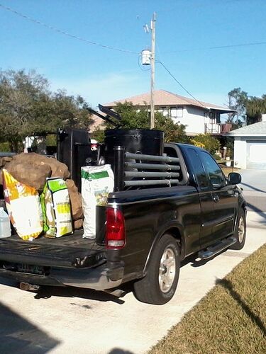

the dealerships don’t want you knowing how to fix them they much rather you bring it into them and charge you. Next I would think about what you are looking for this truck to do once converted on woodgas would it be for a daily driver or haul trailers and do work ?? I went ahead and converted my 2003 f-150 as an experiment
just to see if the truck would run on woodgas. It works but it wouldn’t be my first choice also it is not completed yet. still working away on the obd2 computer. BBB Sean

If you have emissions tests where you are I wouldn’t consider this truck. I am not positive that once you convert the truck it would pass when you have to take it in to get it tested. That’s one of the issues I am working on now. The engine is made of aluminum not steel. And it has a plastic intake manifold I plan in the near furfure to make one out of metal because there are no aftermarket intakes for my truck that I can find. If you understand that this would be an experiment project and are prepared to do whatever it takes to get it converted then start building your gasifier and all of us will help get you running. Regards Sean,

Brent, I would like to think that the exhaust from running on wood is cleaner than gasoline. I really don’t know the answer until I have the time to get one of the trucks tested. That can’t be done in Florida I will have to go out of state. As stated above my truck has a plastic intake manifold and it is not the best choice for Woodgas. Also have no problems with power I run highway speeds and pull trailers all the time with no problem. My gasifier design was based on a Keith design I changed and added some things…

Hi Randall, I am in Florida and have no emissions tests to deal with so I would not be any help on how to beat the tests. However I have been visited by the EPA four times in the past 2 years. And I am still running on wood every day they love the idea. Thanks for the hint on summit and jegs I have looked they don’t have anything for a 2003 ford 4.2 v6 and even if they did that intake would still be designed for gasoline not woodgas they both will run the truck down the road.However the two fuels are very much different animals. Regards Sean
