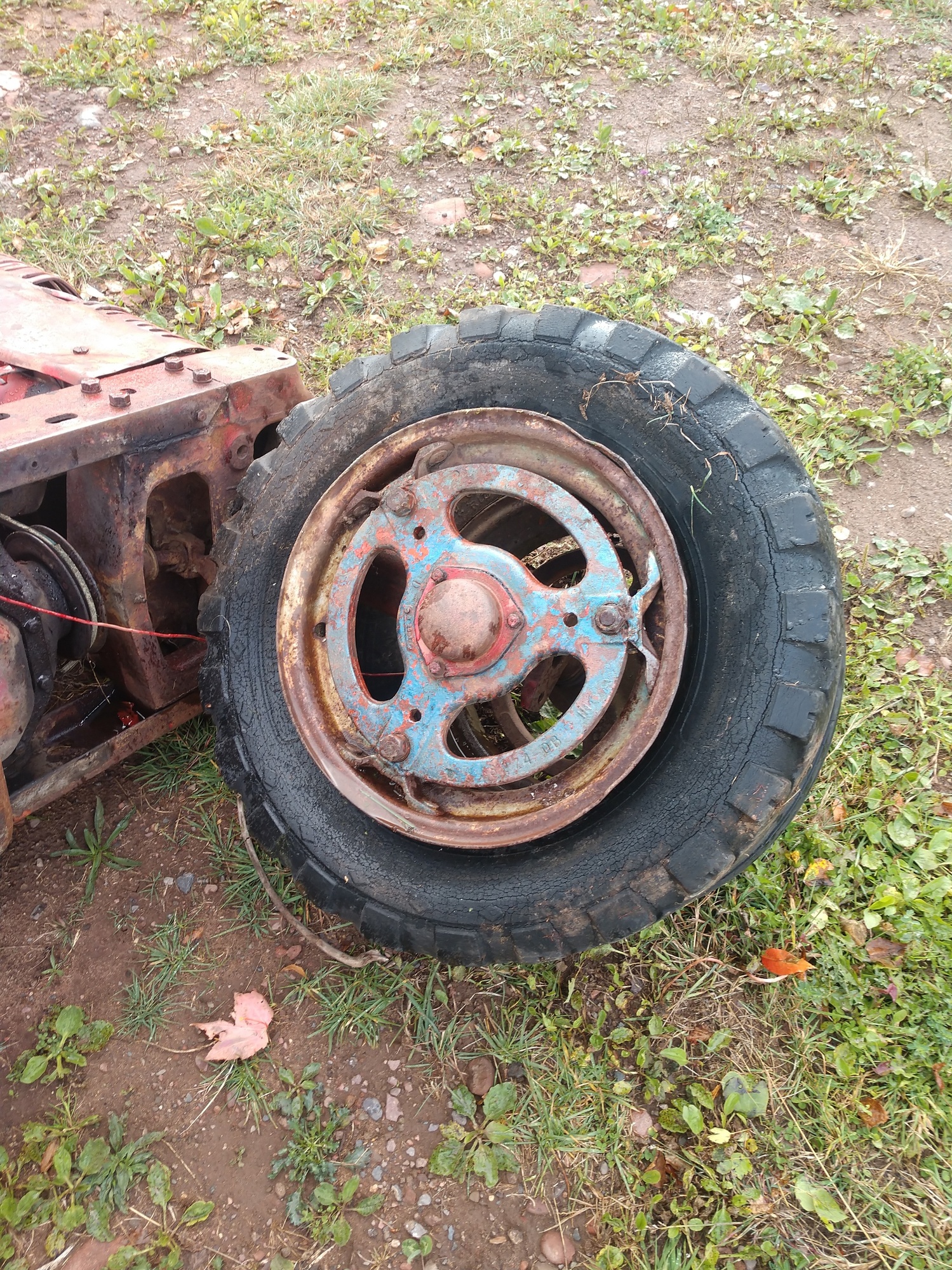

I also like the front rims.
Those rims need a good straightening, but they don’t look like they suffer from chucking back and forth like the ones on the '40.
I also want to go through this engine. I wanna see how to take these apart.

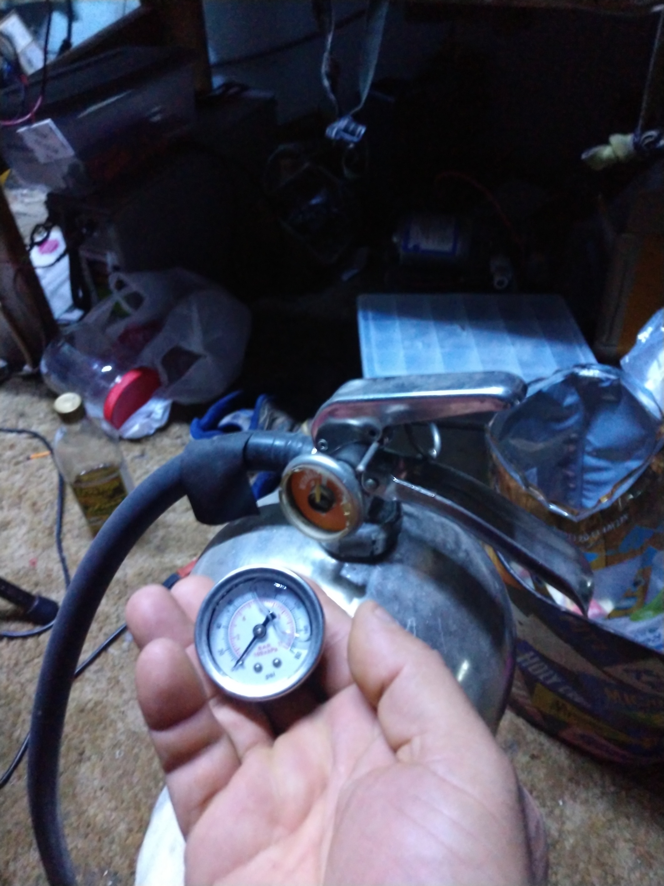

I just received new pressure gauges for our fire extinguishers. I have been thinking of our vulnerabity to fire.

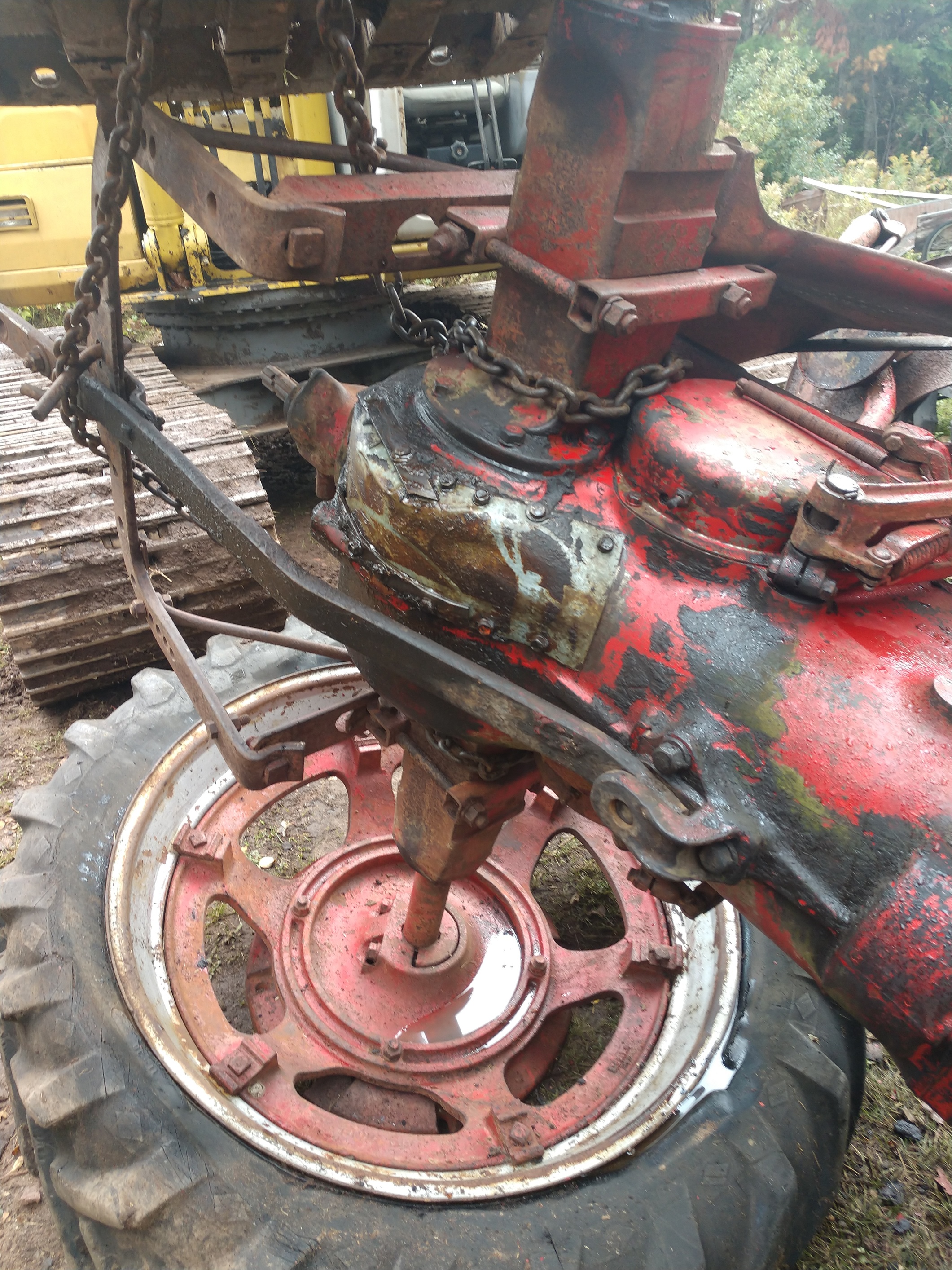

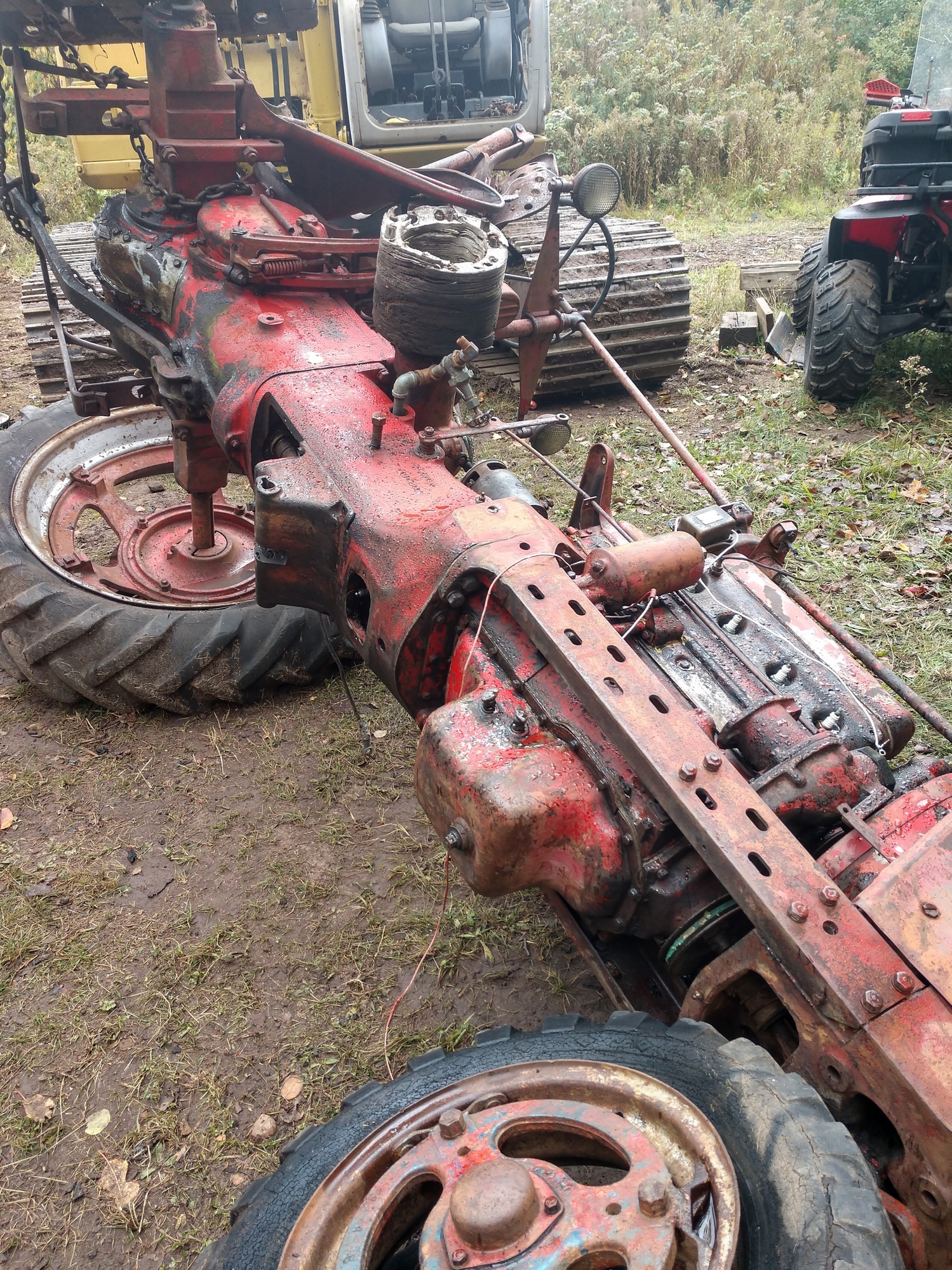

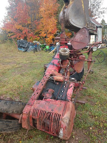

Very stubborn dirt on this tractor. It took 150 gallons of water to get this far power washing it.

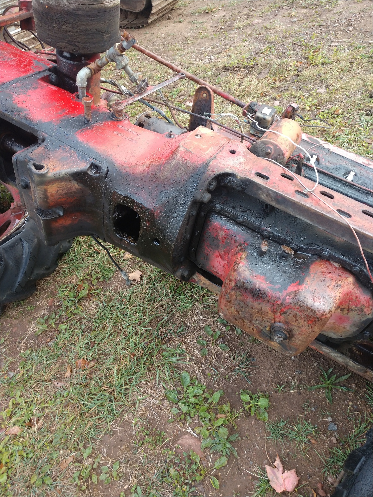

There was some very interesting damage. It looks like a bull gear went through the housing.

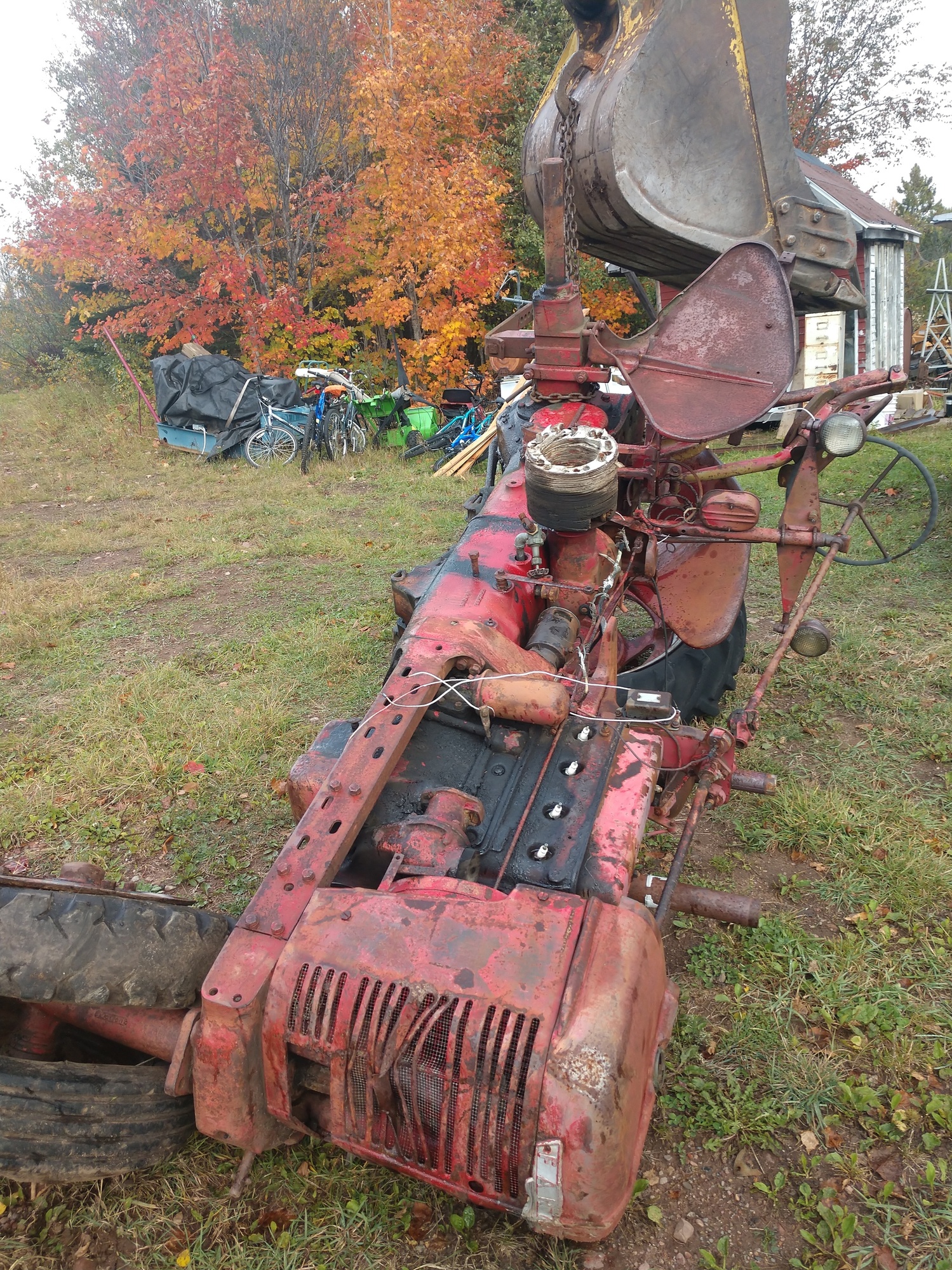

I am stripping this tractor for parts.
I had a nut come off in my Case differential and went under the bull gear. It cracked that big casting. I tried everything to weld it or braze it. Finally talked to a mechanic at Case, he said that happens alot. As long as it’s just an oil leak, clean it good and put auto bondo over it. Did you say you are going to rebuild that engine. TomC

I am rebuilding one engine to start. There are several that need it, but there is a tractor that I want to build. I want it to run on local homemade fuel. I want it to be mobile, like able to haul logs out of the bush. I also want a roof over it like a Rumely, and I want it able to power things like air compressors, or hydraulics.
I have enough stuff to make this happen.
Have you found an alternate space to work? I can’t believe you are really going to camp out on the couch.
I am thinking of hanging the producer on the carb side of the tractor. I realized that the carb should be replaced with a simple governor controlled butterfly valve. All the business that needs maintenance, is on the spark plugs side.
I also have the space where the gas tank used to be. This iteration, I am concerned about real estate. I want the pulley drive, and PTO available. I also don’t want the pathway to get into the seat to be blocked.
So, I am thinking, producer on the carb side, cooling along the bottom frame rails, then up to the filter saddled over the steering shaft, then out to the mixer valve, and down into the oil bath, then over to the intake.
Guess I better round up some pipes and other parts. I think I still have a producer that would work, just needs a mount.

On the farm where I worked an M differential case cracked because a hub bearing went out and dragged one of the balls under the bull. We found two halves of a 1/2 inch ball bearing that had been sheared in half. The crack was about 8 inches long.
The farmer had a really good welder fix it. He drilled a 1/4 inch hole at each end of the crack so that it wouldn’t grow when he put heat on it. Then he used an angle grinder to make a groove right on top of the crack, about 1/8 inch deep. Next he heated the casting right around the crack to boil all the oil out of it. He then used hi-nickle rod to make the weld. Last he ground the area smooth, sprayed it with wd-40, wiped it off with solvent, and sprinkled chalk dust on it. He said if there had been any cracks or pin holes in his weld he would have been able to see them because the wd-40 would seep back out into the chalk.
The tractor held up for the remainder of my time there. I still think he did a really good job.

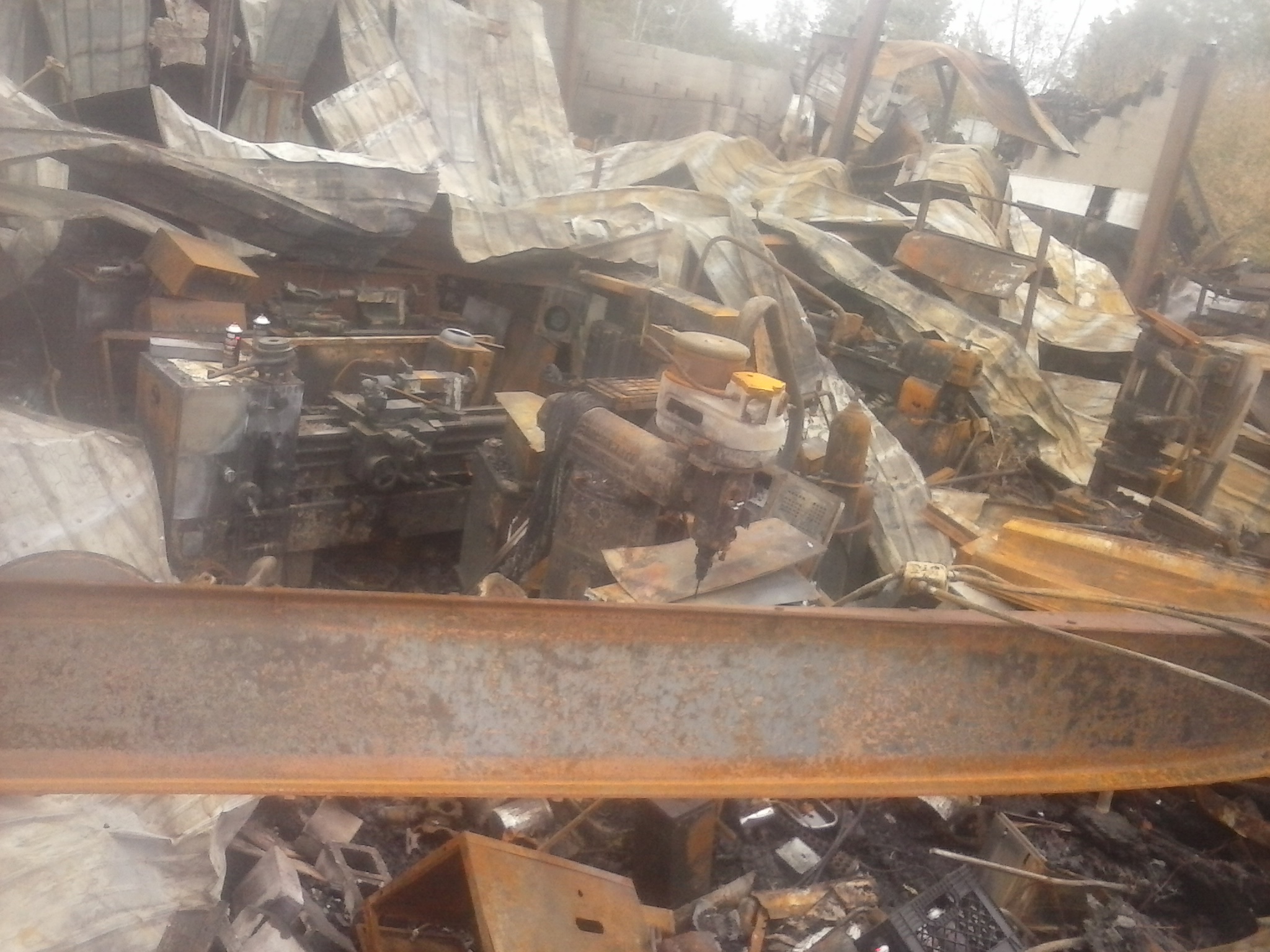

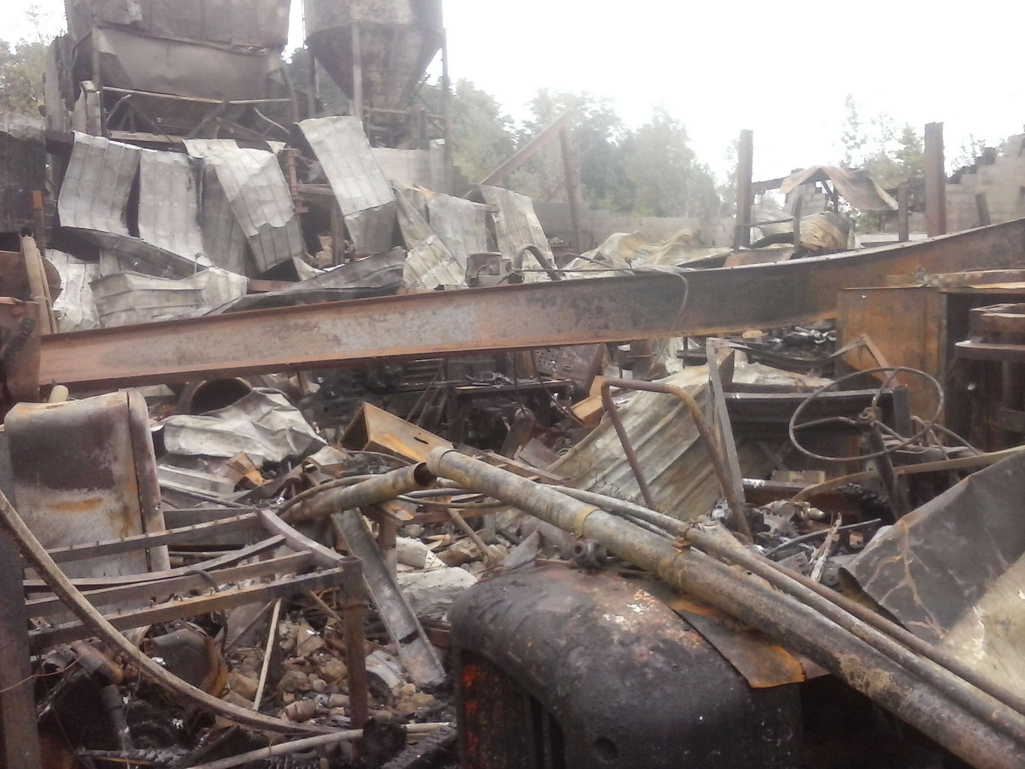

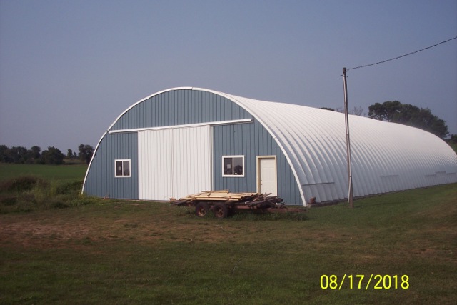

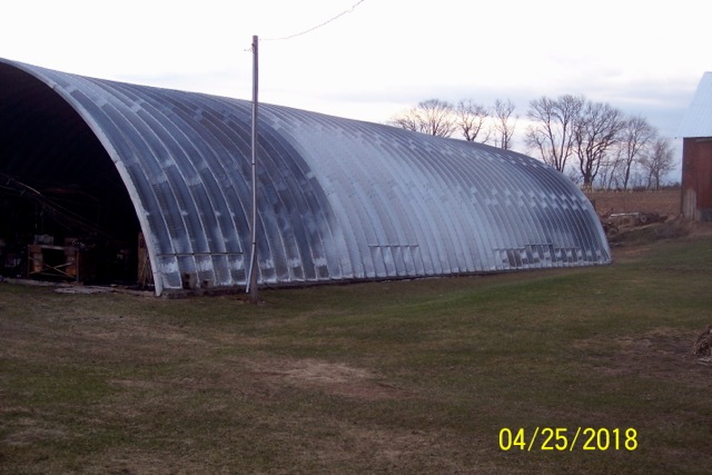

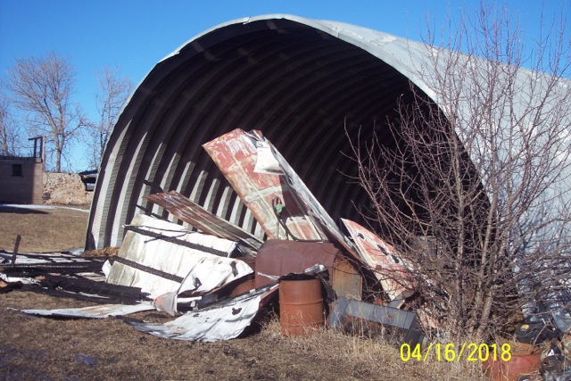

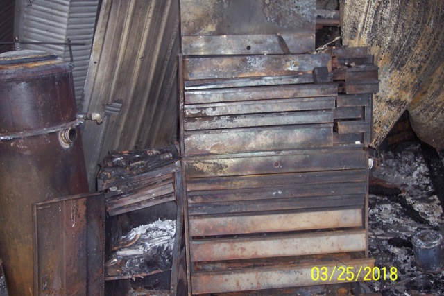

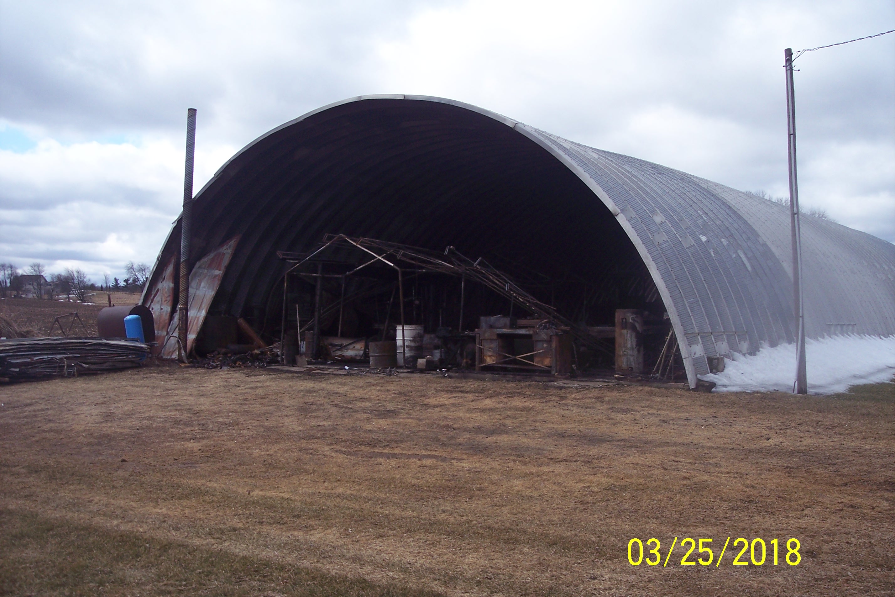

Sharing pictures of our burned out shops!!
The first couple show how my Quonset building held up to a very hot fire. The one of the tool box was one of my big losses— about $8,000 worth of Snap-on hand tools. The last picture is what it looks like after a couple of retired carpenters that were having trouble making it on Social Security worked it over. TomC
Ok you guys reminded me to get out those new gauges for the fire extinguishers…

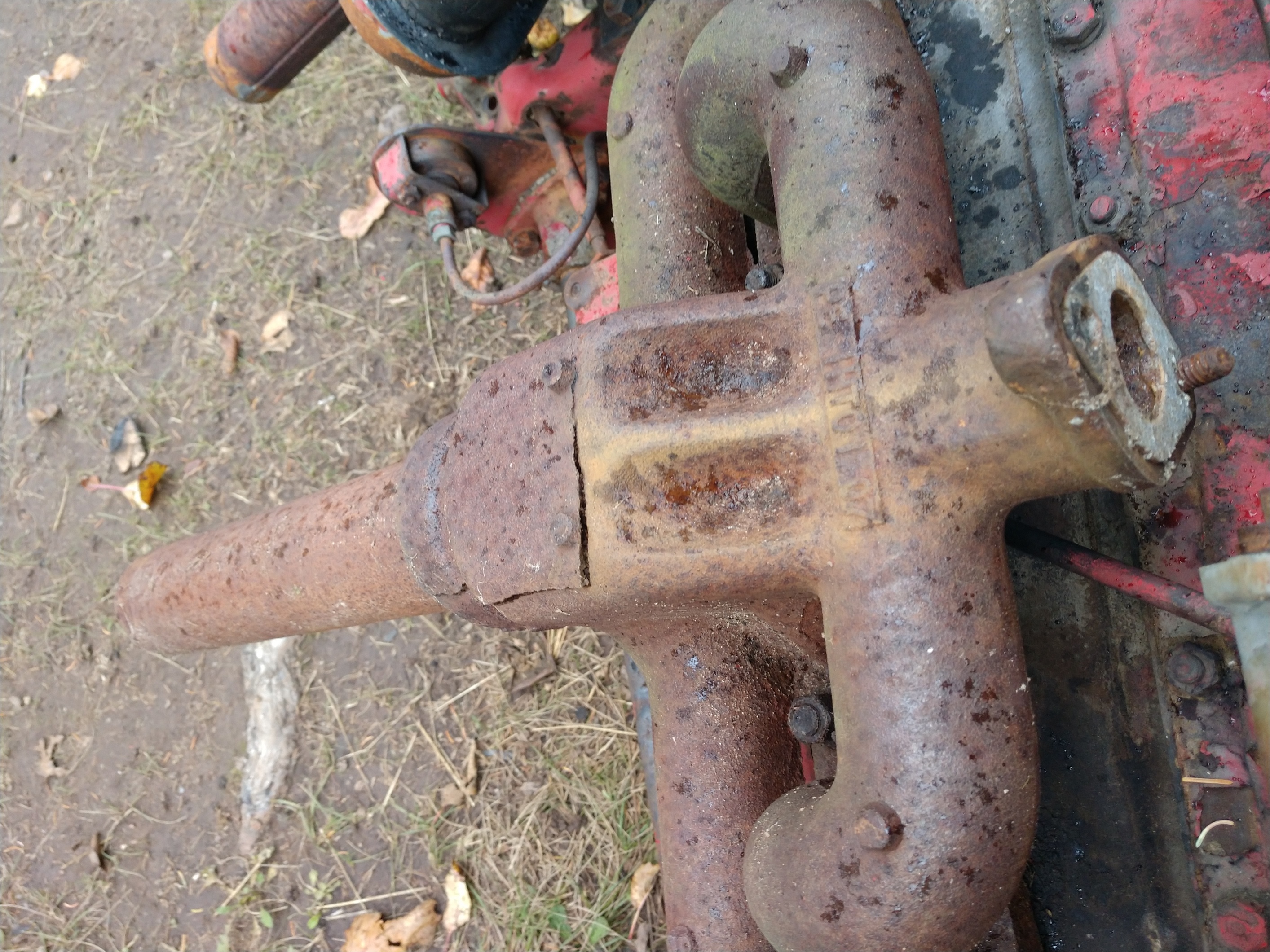

I wonder if that method with the WD-40 and talc(?) would work for welding this manifold?

It will work. But the important thing will be to drill holes at each end of the crack so it doesn’t grow. Use welding rod that is designed for cast iron. Do not try to join cast iron to steel. The expansion rate for steel is different than for cast iron and they will tear away from each other.
