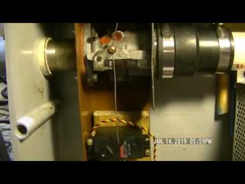

Unless you have an arduino making the ratio calculations and adjusting for you.
Something like this. As soon as you spray propane it will adjust the air mixture.
My tutorial to build this very system is here:
I knew you were on here!
Am I correct in my thinking Matt? If you add propane during heavy load situations this air mix system would compensate?
Yes if you did it slowly .it is not very fast as to compensating abrupt changes. So you would have to meter in the gas slowly.

The mixer controller runs in milliseconds not seconds. The reason it is tuned to act slowly is so it dont over shoot, If it moves to fast and overshoots it will go into a hunt mode.
The code also is not static, if the O2 signal is on the outer side of the parameters the delay is nearly zero between movements. When the signal is closer to the happy zone the code increases that delay upto 400 milliseconds. You can tune this the way you want as well. You can increase the mapping for both directions.
