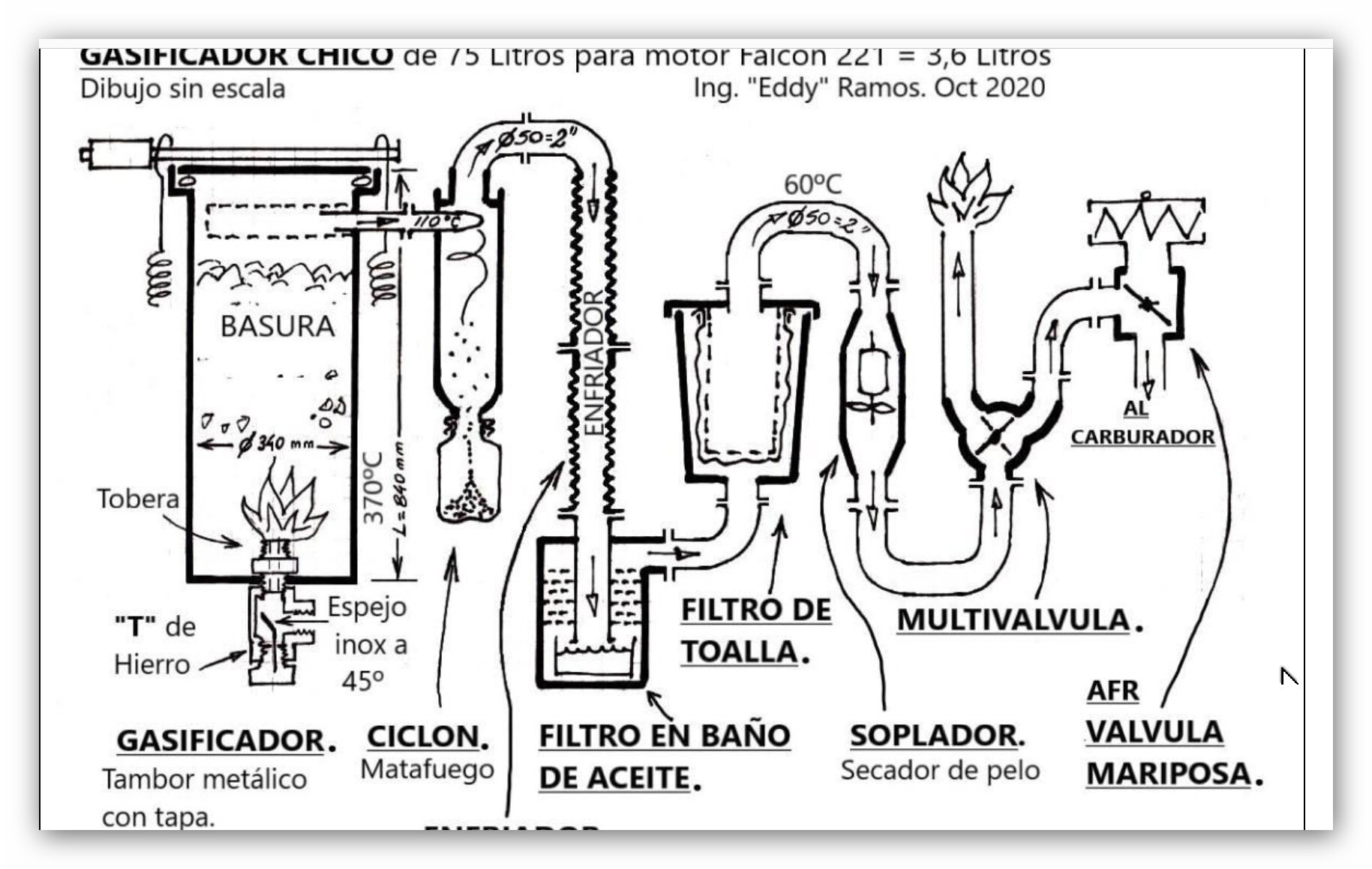

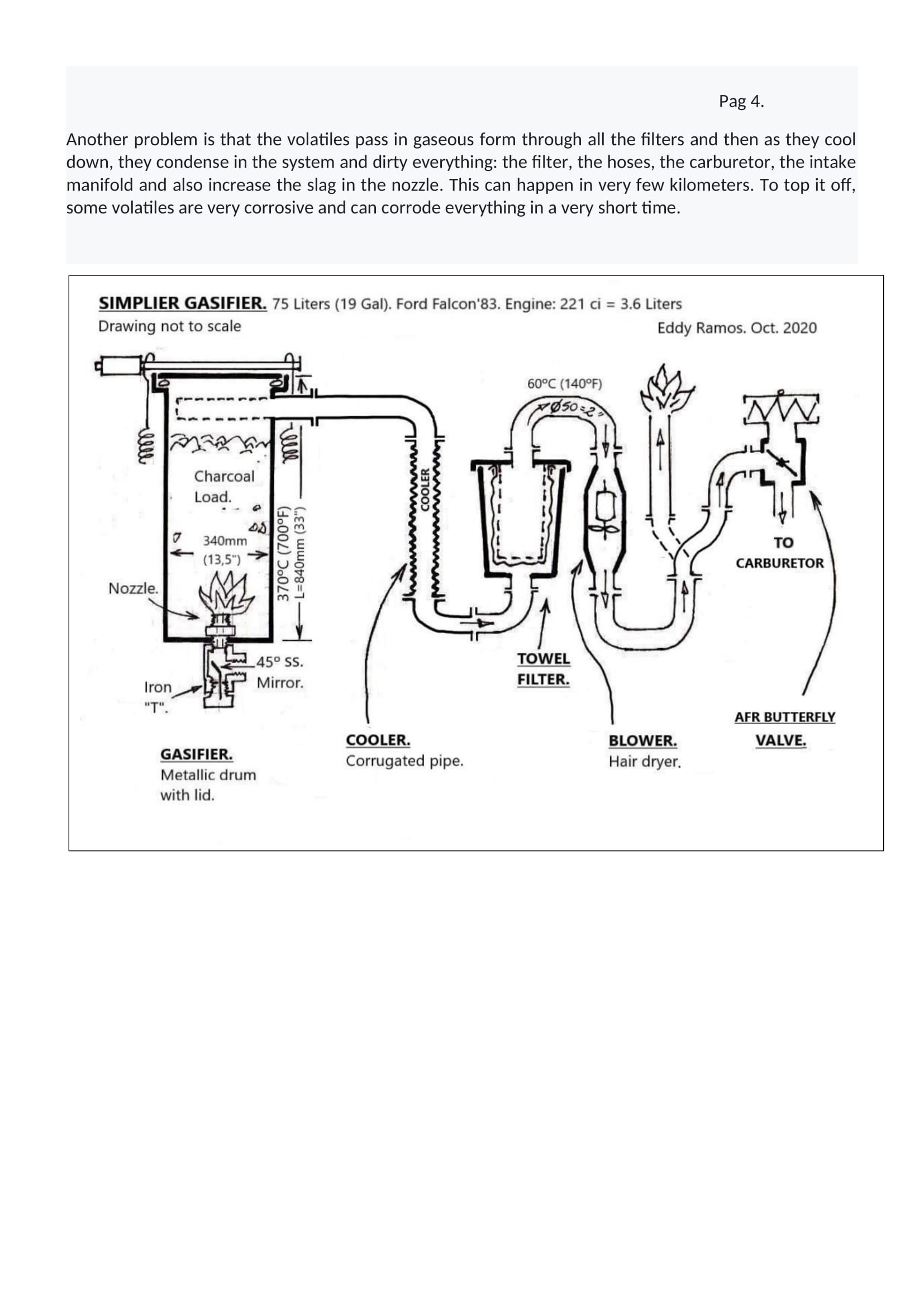

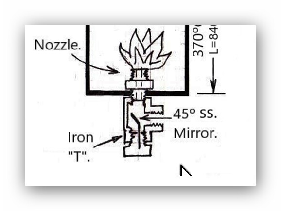

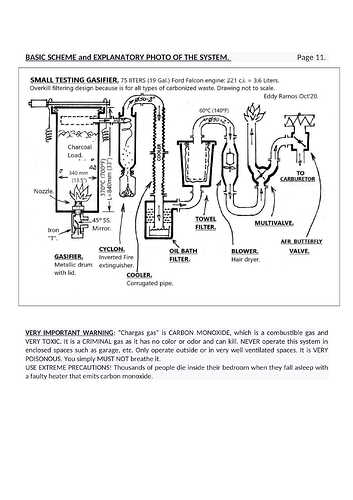

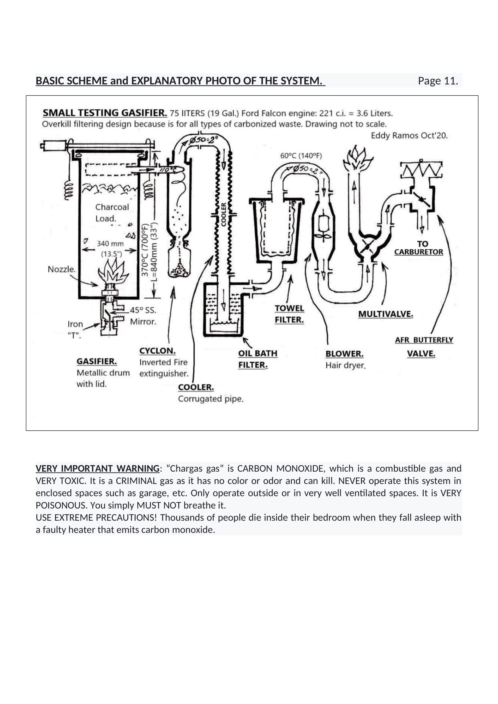

I also found your face book posting and screenshot this drawing.
It appears that the gas always goes through the blower fan even when the truck is running. You could move the fan over to the flare stack to eliminate this if you wanted to.
Just want you to know Eddy that you have certainly served me. Diagram s of all the various builds here answered a lot of questions for me. Pretty invaluable I think. I want to thank you for all your good work. Also if we didn’t talk about our failures I wouldn’t have much to post about. You describe something that went wrong and five people are going to help you figure out how to make it work right. The brain trust.
Ha, I see you also fixed a mirror to see the nozzle inferno!
Hi Don:
Nice to hear from you. Thank you very much for your suggestion.
The reason why I got the blower fan there is because after flaring I need the blower fan to push the chargas, this means that I need to flush/purge the loong hose that goes from the flare to the engine. After the engine is ruining on chargas, then I stop the engine, and connect the hose that gets out from de bucket filter directly to the hose that goes to the engine. For that I use quick connection hose fittings.
You can find this same drawing in English in the above “Guide for driving a vehicle on chargas”, Chapter 2, page 11.
