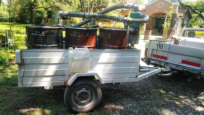

Also I am testign my last work. Is a trailer that produces a LOT of chargas. I build it for my 3500 miles trip as soon as the crazy pandemia let me do it.

Very cool! Full size drums thatā€™s a lot of char
Hoping you are going to do a diagram of this like your other work. Canā€™t figure out the three barrels. Itā€™s good that people in different parts of the world are learning from your videos that they donā€™t have to be dependent on others for their basic energy needs. Blows against the Empire.
Hi Eddy,
The trailer setup looks interesting. I would like to hear more about its development. Is this a parallel system or is it a series system? A series approach could give you an emergency reserve. When gasifier 1 gets low and hot, switch to gasifier 2. When gasifier 2 gets low, switch to 3. When 3 gets low, use cool charcoal from 1 to keep 3 going.
Iā€™m wondering if a parallel approach would allow smaller hoses and smaller nozzles? Kind of like three batteries wired in parallel? I assume that you will be taking your charcoal making kiln with you.

Parallel or series. I am testing both:
  1. In parallel I can drive longer before I have to reload the three drums, and it heats slower, because the reaction on each drum is one third smaller/slower. But my guess is that I may need an adaptor to smaller the size of the nozzle.
  2. In series, as you say for the time the third drum is low, the first drum will be cool. But I may have to switch drums every 60 km (40 miles).
    The three drums, are also charcoal making kiln (in my guide, check Chapter 8: ā€œCarbonizationā€ the Hi temp (HCC) carbonizer). So no need to carry an extra charcoal kiln.

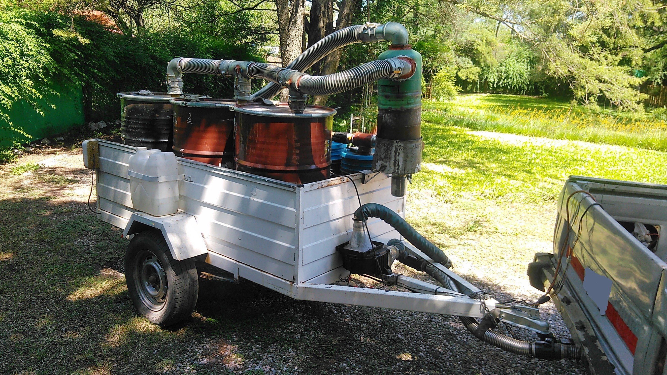

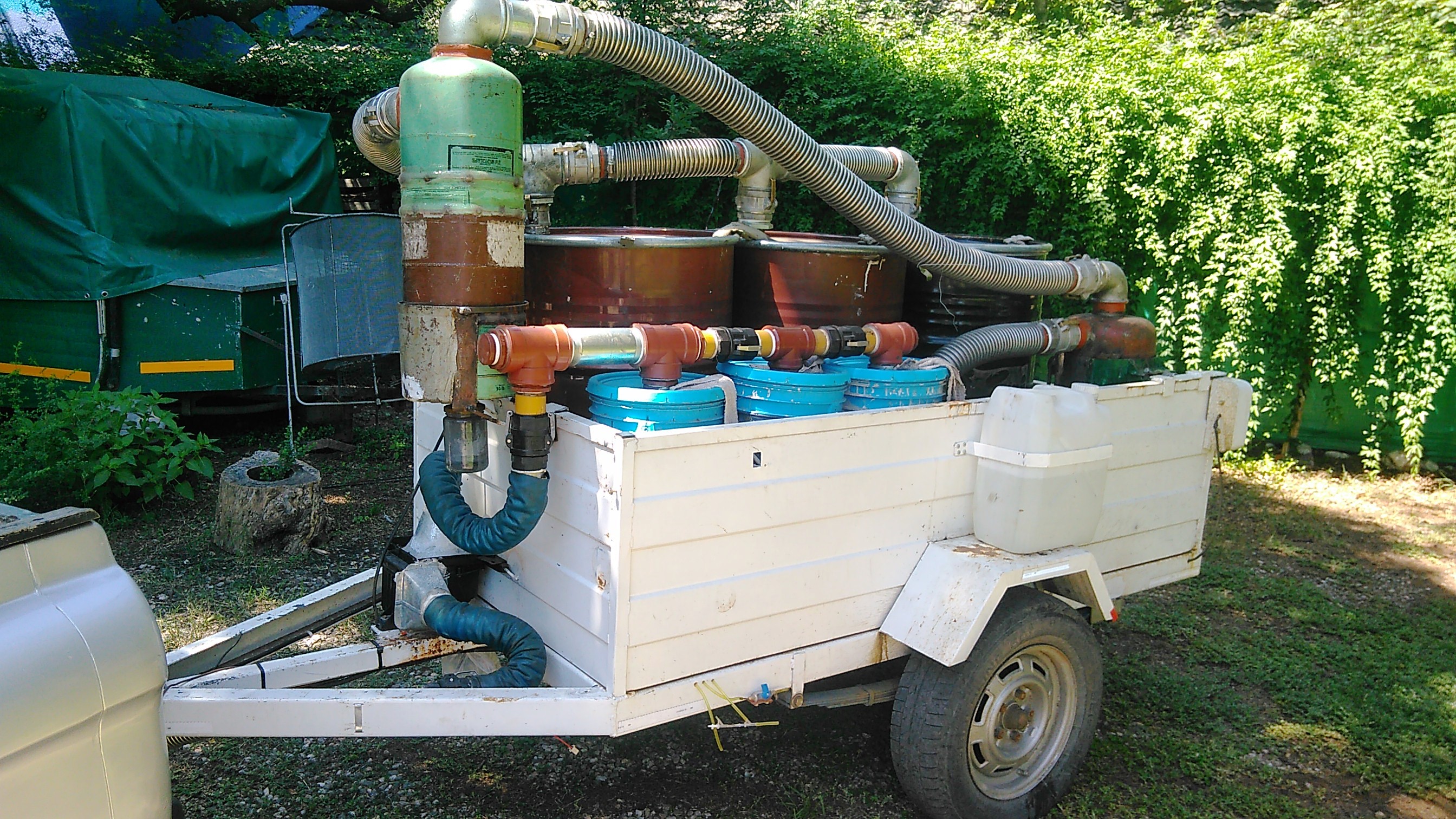

Regarding my trailer I may do some kind of drawing, but the system is basically the same as the one I describe in my Guide for driving a vehicle only on chargas. But everything is bigger: bigger gasifiers, bigger cyclon, bigger air filter on oil bath, three parallel plastic buckets for the towell filters.
The only difference is that the floor of the trailer has three holes, one for each nozzle. The nozzles are bellow the floor of the trailer, so I can ignite each nozzle from bellow the trailer floor. And, to avoid some fire, I have three vented caps, one for each nozzle that attaches to the floor from bellow with magnets.

Thanks Eddy. I now understand that the three barrels are separate gasifiers.
