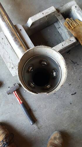

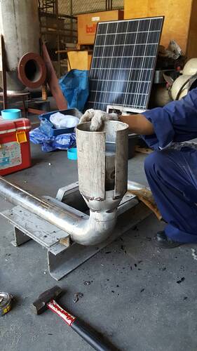

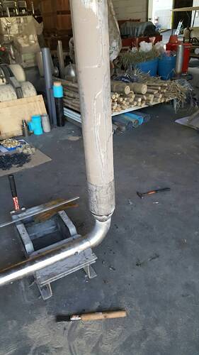

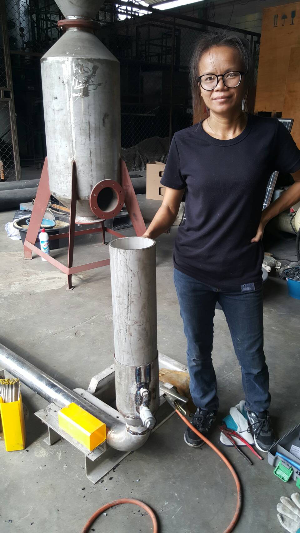

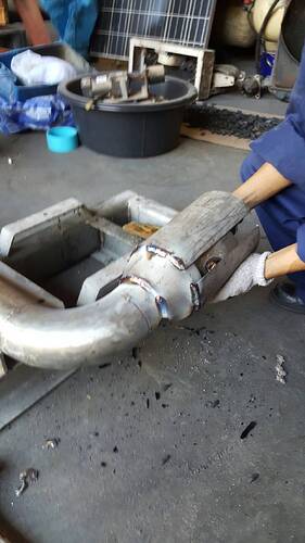

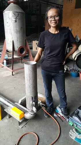

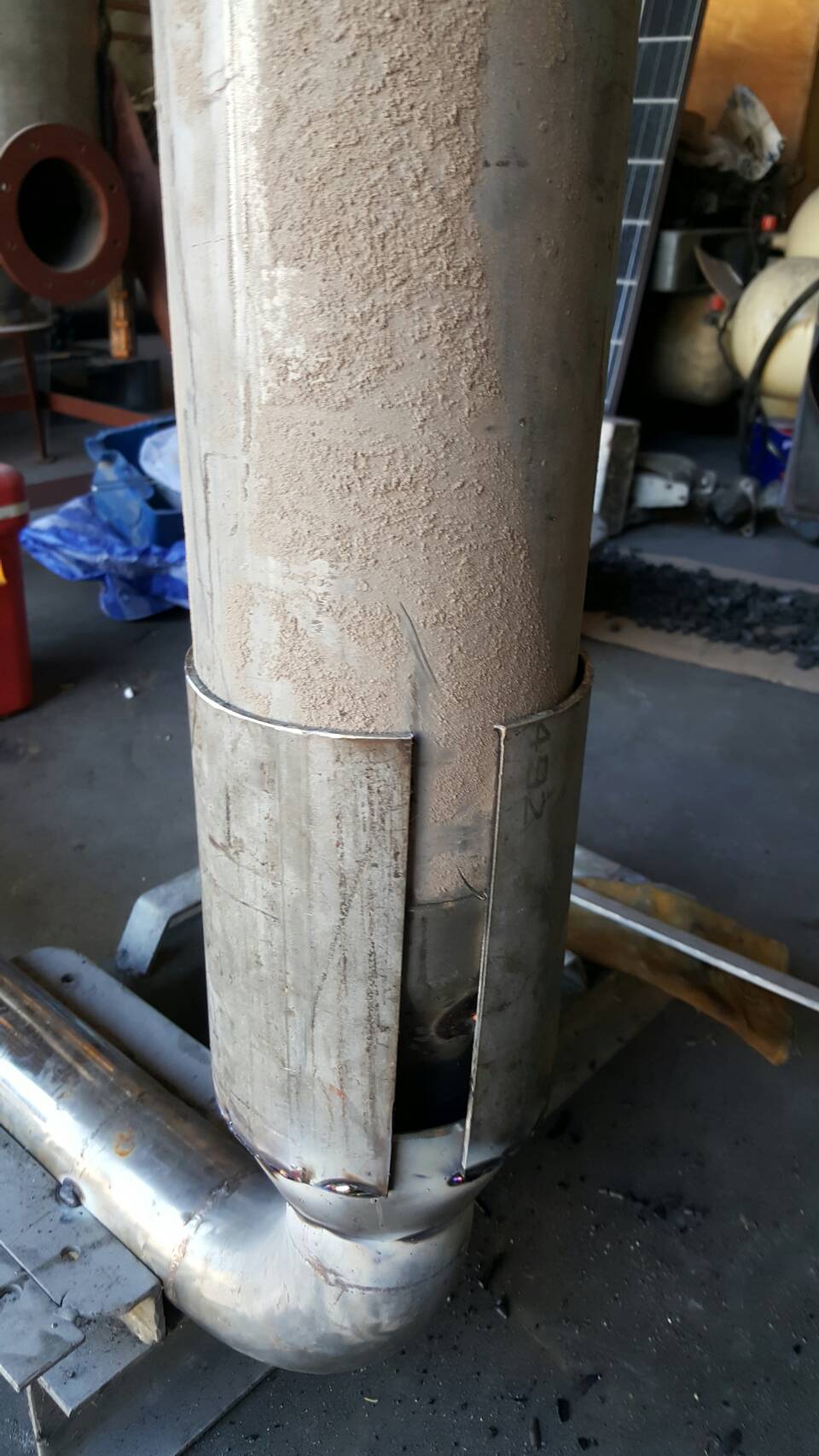

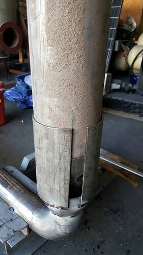

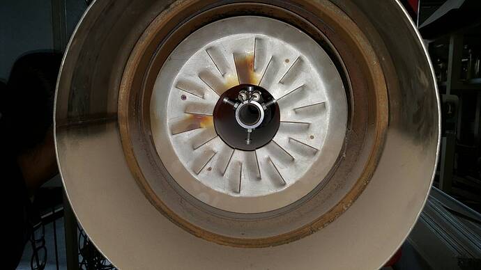

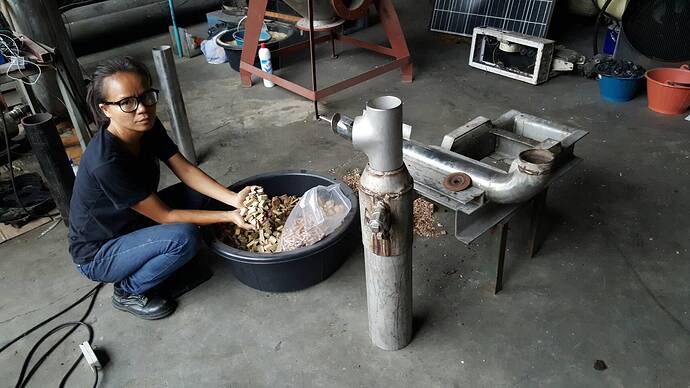

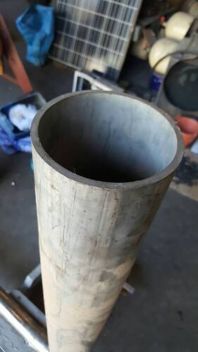

making progress, fitting , welding.. and a lot of thinking

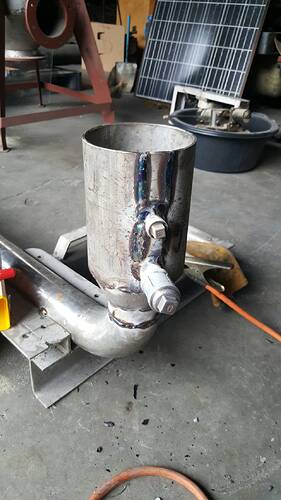

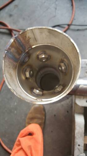

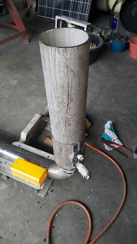

sized and welded, next step the air intakes

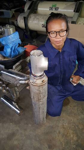

First use for this gasifier, but then in upscaled version:

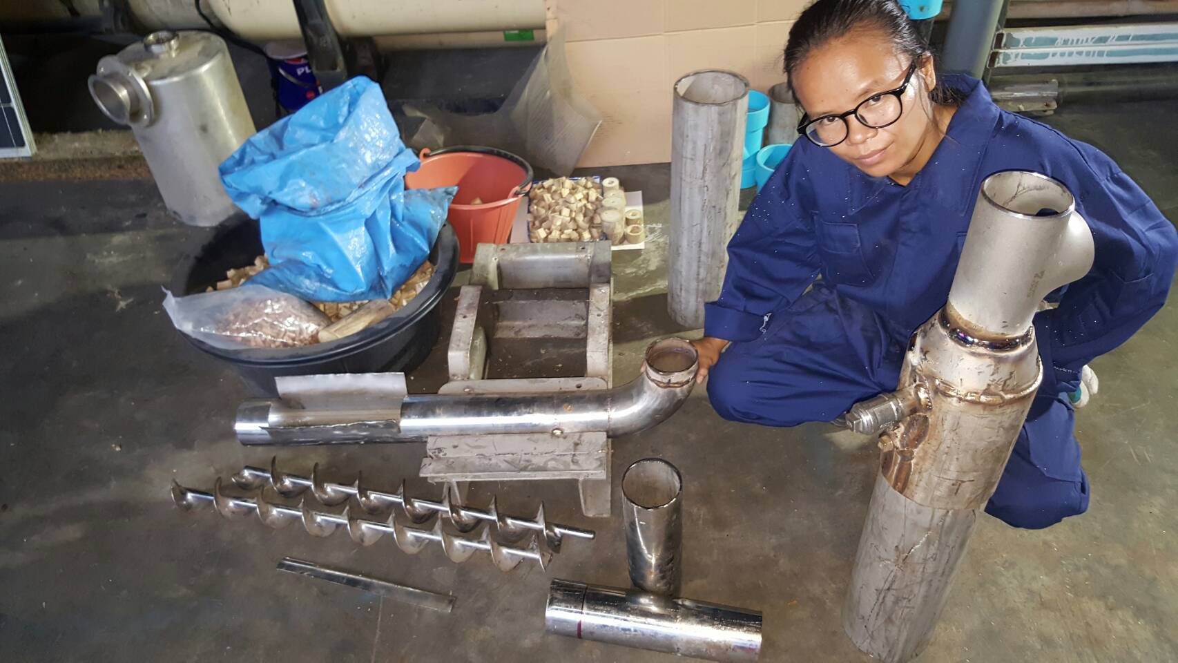

Fuel did not pass the curved elbow… the pellets did, but i want more…
Plan B: T - piece with 2 augers…
This is where the big version have to end up…

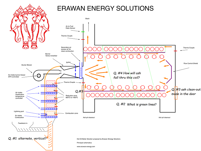

Hi Koen
I try to understand !

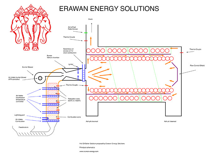

to feed a gasifier from below, makes it possible to better control the flow of pyroligous gas?
by preheating the wood upstream of the oxidation zone do we not lose the advantage of controlling the flow of pyrolytic gases?

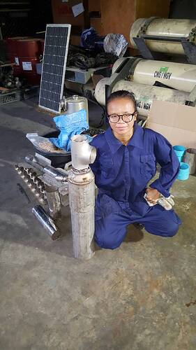

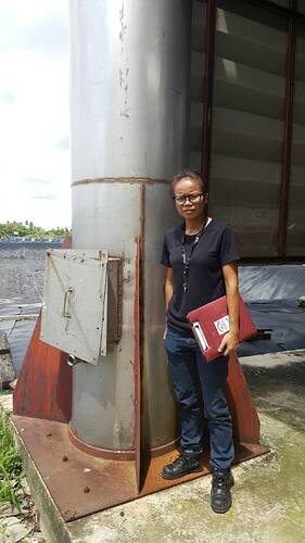

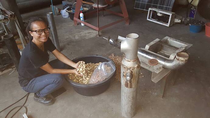

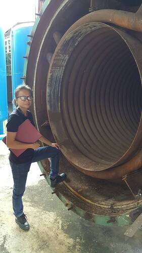

Who’s that in all the pics?
KVL when you wife is smiling she must be happy with the design direction.
She smiles a lot on this small system mystery build. ( The BIG systems not-so-much smiling?)
tree-farmer Steve Unruh
Hi Thierry,

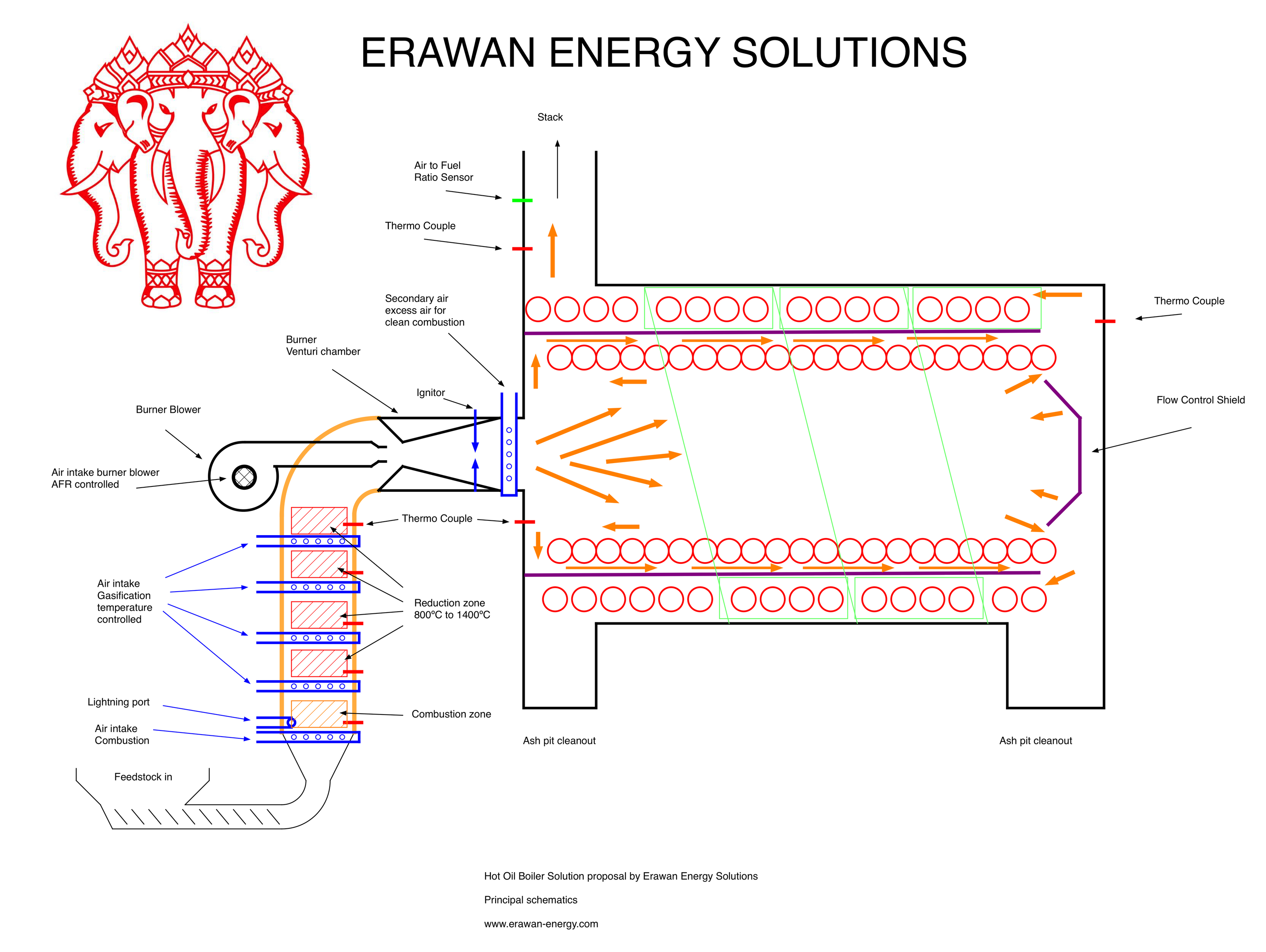

The top layer envised , is the actual glowing charcoal layer.

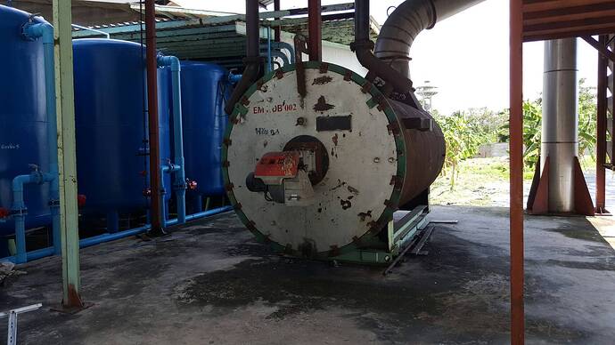

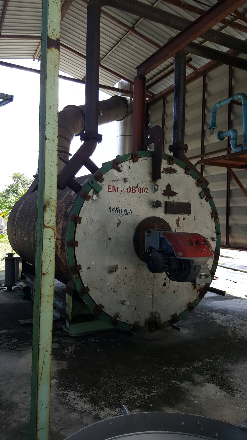

The gasses will exit at high temperatures and, in this case , ignited for the heating of the boiler…
If you take a sketch / drawing of a normal gasifier, with the grate and gas exit at the bottom, then turn that upwards-downwards, take away the grate and there is this build…
The ashes will be conveyed with the gas-stream into the boiler and end up in the foreseen ash collectors.
In case of a gasifier only, then the ashes will be collected in a special cyclone…
Hi Billy,
The girl in the picture is the love of my live aka wife, aka co engineer
Hi Steve,
Yes, she smiles a lot and she is also aware about the challenges with the big ones… ( big takes more time before can build, run / smile )
She enjoys every bit of it…

Question #1…Plan C? vertical auger…see drawing.
Question #2…What is green lines in the picture?
Question#3…Why cut holes in bottom of the main vessel for ash ports front & rear? Can you put the ash ports in the doors front & rear? [doors are easier to modify repeatedly, without modification to the main vessel]
Question#4…Ash will collect upon inner coil and clog, there must be space between the coils to allow ash to fall thru, by gravity & air flow. Operator will use long scraper to drag ashes toward ash clean out?
As compared to an ‘oil burner’ the gasifier is at best 66% of the BTU of oil, …so…should you have an additional gasifier/auger/burner on the other end of the main vessel?..you were asking for more with Plan B, twin augers.
I have redrawn your picture, only to show my suggestions, and I hope not to change your strategy, we all know your team’s ability & direction is excellent.
