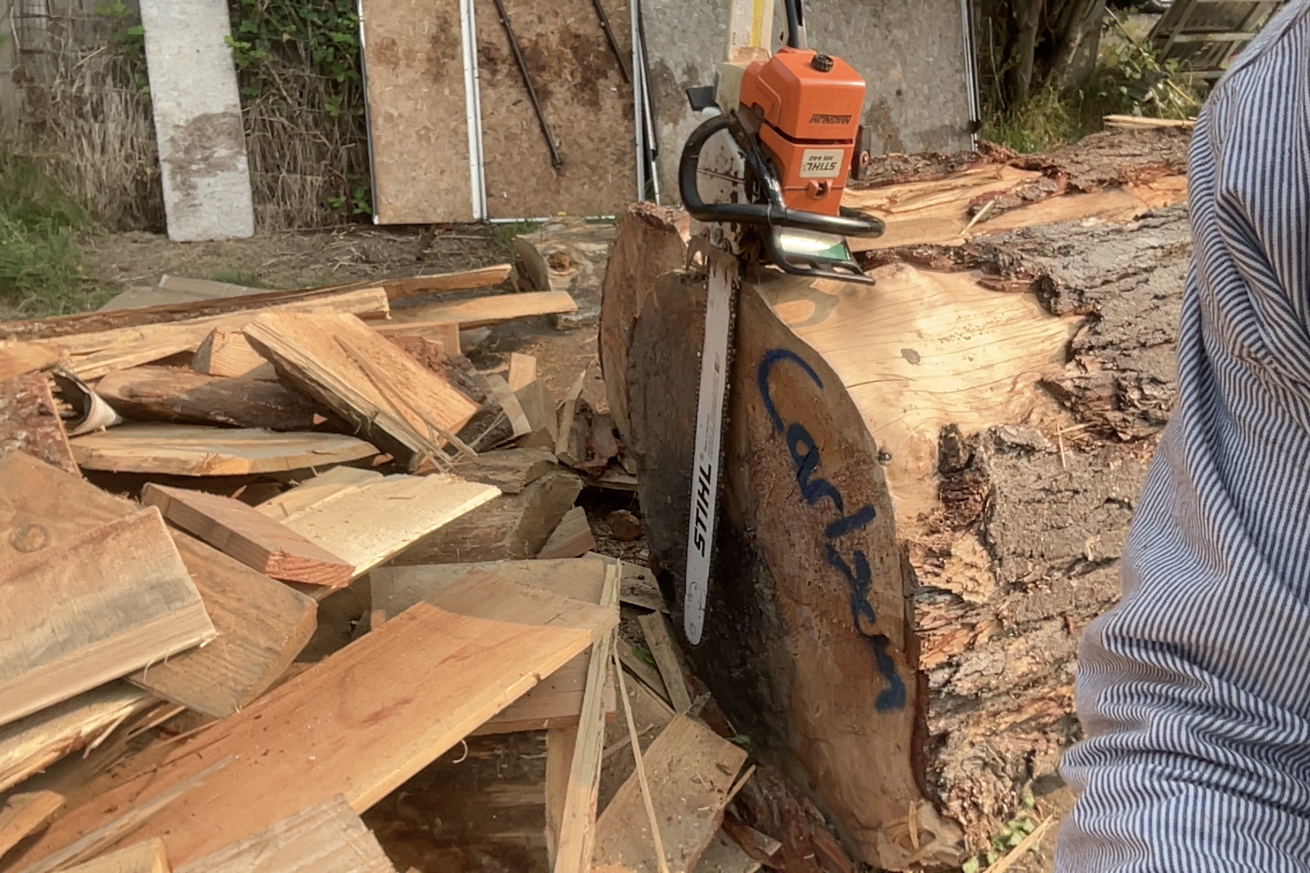

Hey Marcus,
Yep NO battery electric can handle the six full bar; double cuts to break down these two “free, delivered” knot-busters butt sections. Way back when, there were wired electric saws that could have. One current (expensive) hosed hydraulic saw that could too.
A 044/440 with a 28"/71cm bar can. Done it . . . too many times with this now 19 year old saw.
It is the working time duration under full power is what matters. Just add more fuel mix and bar lube and human coolant for maintained full power. As we know it is much more than about kW/HP rated comparisons. Regardless; best re-sharpen dress that chain often or a 044/440 will smoke the paint off of the bar and kill it’s rails temper from overheating. Yep. I killed my first bar on this saw way-back-when, learning this.

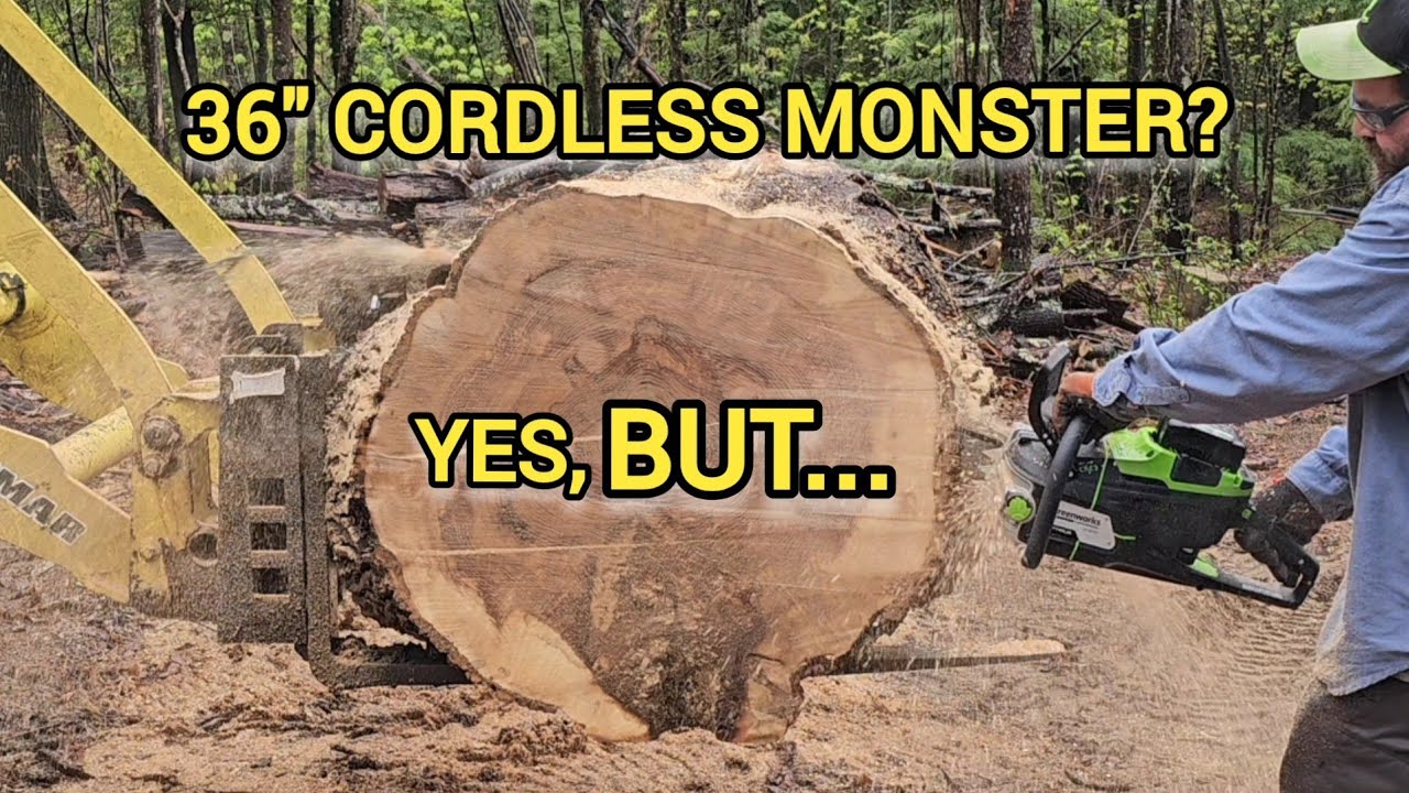

They are getting closer. This guy tried a 36" bar and the previous video he used a 32" bar. He says the sweet spot for longer runs is the 28" bar, but he doesn’t have the newer core 700 battery which delivers more power. It definitely cheaper to use gas, given the battery is 1k. The motor overheated and shut off in this test. He definitely was working it.
I think that is red oak, but I am not quite sure.

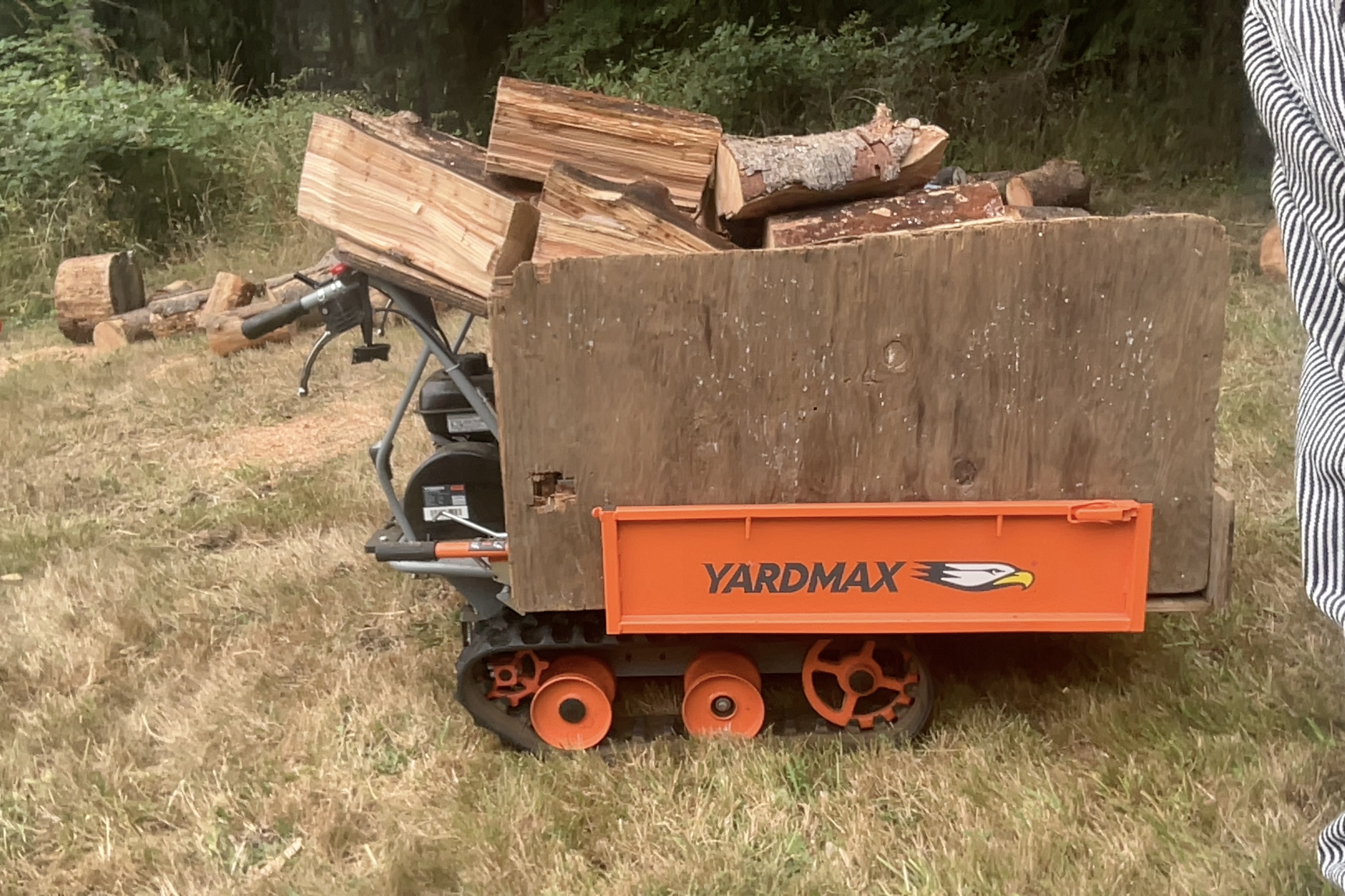

Hey, not an electric chainsaw. But my second year now using my tracked power cart and I can safely say I think one of the equivalent battery electric one would work just fine.
I am only using the IC engine at half power and RPM. And I not been using even one full tank of gasoline a season to move a winters worth of firewood.
Ha! Load balance on my three support wheels type is the delicate trick to learn. Yep. I should have paid more for the next larger four support wheels type like Dave in Australia has with his Honda.
