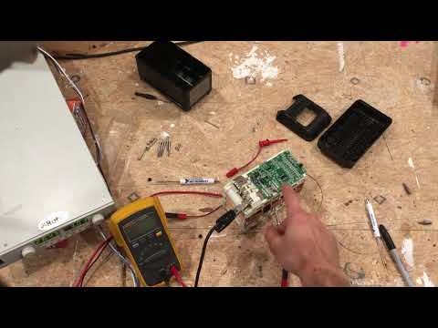

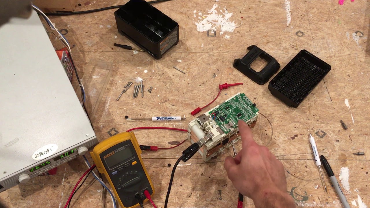

But anyway, I saw this video, and they reset the board on it. Apparently if they get below a certain charge point, you can’t recharge them because it can’t power the BMS chip. On this particular battery, they didn’t hook up the individual controllers.
This might save you from buying a new battery.
Thanks Sean. I do have the 58V saw. I’ve been using it for two years now. I don’t know how many cycles but it never sits idle for long since I use it to cut up limbs for making charcoal during the whole year. I would be lost once I split that battery case. Didn’t understand half the things he mentioned. I’ll just hope it keeps on working. New battery was $170 so I’m not sure where he was getting prices from.
Honestly, I knew he used some terminology and was worried you might not understand, but the other guy was completely confusing.
It looks like if it self discharges if it sits idle for a while because the charge controller chip is running the whole time. basically all he did was add power which powered the board up and then it could charge the batteries up to the point the circuit wouldn’t report it as dead. Then he reset the circuit that is reporting a dead battery (with the led lights). Then he was back in business. I think that was the video where he also replaced dead cells. (I watched or skimmed through a few videos).
Tom,
He got the battery so cheap because he said it was sold as is (broken). He was pointing out about how the circuit board inside has all the wiring and pads in place to have the little computer chip inside monitor each cell and balance the charge, but the inexpensive parts to activate that option were not installed. It is very common now on Lithium (many types) packs and chargers to monitor and balance the state of charge. He said for a several hundred dollar pack, Echo could have done better by the customer. That said, the saw works great I hear! :cowboy_hat_face:

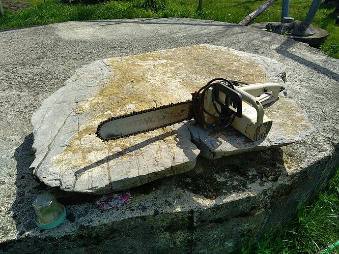

Hi Giorgio, i would say go for a used one of a known make, more heavy duty, like carpenters and timbermen use, 1970-80s model, heavier, but not so much plastic, many of the new’er ones got plastic transmission gears very prone to fail, check for as high chain-speed as possible, many electrics have very slow chain, just jumps and jerks.
Stihl made some models looking like angle-grinders with a bar and chain, indestructible, but i don’t know much more about them, more than they can be found cheap.

Giorgio, Goran probably meant this Stihl chainsaw, … my brother has it
It was one of these old-timers i thought about, called stihl e15, if i remember correctly.
Old and heavy, but seems to hold up well.
Actually, im searching one myself, i must have atleast one electric in the collection, i believe, and, i have the same idea as Giorgio, i want one for a future woodgas-chainsaw project. :slightly_smiling_face:
