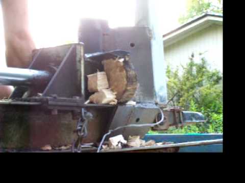

Thanks Paul on the info for useing ceramic blanket.How is the doser chunker working out, i ran in too your utube vidio looking for chunker ideas.i have and old case trencher with about a 8 or 10 foot trenching boom. i could save for chunking either the track axel or the trench parts mechanical converted.
I couldn’t keep a sharp blade and was getting a lot of shredded material and the truck didn’t like so I gave up on that one now I lust use my wood splitter with a couple different attachments this has been working good for me.
Thanks Paul that is one thing i was woundering, how bad are the chunkers sheading the wood.was the shreading causeing bridging or just too small of wood pieces. I May try a. Slicer chunker more like patric johnson. After i make a reducton too go with my f350 truck axel. Anything will serpass useing a 10 amp table saw it it is heavy enough too brake the wood.
all the above for me if you run green fresh wood it was a lot better I see a few people having good luck with wayns design I just have better luck with blockier chunks if that’s a word .
Long as its not as slow and lould as a table saw, were rolling Thanks.
it goes pretty fast if you found my other video I have the splitter videos up too
I could not find your splitter vidio, though i have QUESTION on your ceramic blanket tube, was the contest at argoes done with the lightened up tube or the standard heat exchanger fire tube by WK. You were idleing quit a long time.
orgoes was with the blanket . here is a couple of videos one for branches and one for cookies
Nice add on’s too the splitter that sure beats sawing and axeing the sliced wood. Was the blanket on your lightened up propane tank burn tube while idleing at the argos contest. Thanks again.
yes kevin that was with the blanket and there and back I was pushing 70 slower up hill faster down no dino until wood would run out and I could find a place to stop the thruway was a pain.
Thanks paul are you getting much better miles per pound on the dakota, i mostly plan on useing my small 4cyl truck for 20 too 30 mile runs so probly wont need refueling till back home, if i hitt a few bump after leaving too get back home, see what the wood gas gauge says.SWEM
I was at a solid 2lbs per mile I lightened the whole truck up a lot and would like to do more now I get closer to 1,25 -1.5 pounds to the mile. I would love to see 1 to 1.that would make my back feel better I’m sure your 4cyl will be at or below with no problems .
