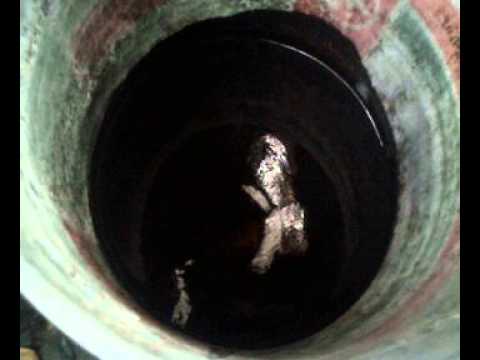

Well after 19 hrs the aluminum foil is unchanged…If the lower condensate were caustic it would have deteriorated the foil by now…
There may be something in the woodgas itself that will deteriorate it,but I don’t think its the condensate…
Will see with some more test …

Thanks for mentioning that Brian …I have some cast aluminum and regular aluminum , I will throw them in and see what it does also…
But aluminum foil does react well with caustic stuff regardless of the amount of tin it…
For the sake of covering all the angles I will test several types of aluminum …
Getting to it now …
