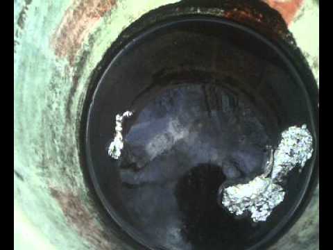

I just did a start of a test .By taking gasifier condensate putting it in a bucket and putting aluminum foil in and so far it has done nothing to the aluminum.
So maybe its not that caustic ..
I’m going to leave the aluminum in it over night and see what it does ..Its been in the mix for about 30 mins now and so far nothing has happened..
Heres a short vid clip of it … I will update with long term results ..
This condensate is from burning pine wood ..
condensate from which part of the system Johnny?
That is condensate from the lower condensate tank, the one off the rails under the truck …I am going to test with the hopper condensate also maybe tomorrow if I get the time…
The aluminum has been in the mix around 3 hrs and still nothing has changed …No bubbles ,nothing

I am just trying to see if it the lower condensate will corrode aluminum…If it can be determined that it won’t , then it would be possible to make the heatX, and the rails out of aluminum …This would cut down on weight considerably and would also dissipate heat more efficiently…Not really sure on cost comparison but I do think if a gasifier could lose some weight and gain more heat exchange efficiency ,the over all system would be more efficient…
Just a thought for now…
It’s been about 5 1/2 hrs so far , and the condensate hasn’t had any affect on the aluminum…There is no visible deterioration at all…
Will update tomorrow again , but I am thinking there will be no change ,its just aluminum foil and I think if it was going to eat it it would have already done it by now because its pretty thin stuff …
Hey JohnneyC you’d need to heat and stir circulate the condensates to even be close to simulating operating conditions.
Chemical reactions greatly increase with these energy inputs.

On a gasifier system the best way to material tests is to put in sections of piping in the gas flow of different materials.
Aluminum pipe, copper pipe, brass pipe, black gas pipe and unions of the same along with bronze. Real eye-opener.
If you could afford it you’d make the whole downstream system out of bronze and the upstream out of stainless steel.
Thanks for the input Steve ,
I didn’t take into consideration the heat going thru the system …
The condensate was warm when I stuck the foil in it , I had not long come home from a ride…
I will try heating it tomorrow evening and see if I see changes…
I think I will also throw in some aluminum in the hay filter and the heat x and drive around with it in there for a few days and see what becomes it …
I’m just real curious about this, and am the type of person that has to try it for myself .
Just looking for lighter weight and improved heat transfer possibilities for my next build later down the road maybe and if nothing else I just want to know.
