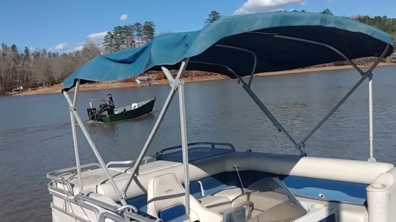

I am trying to upload a video. we took it to the lake today and It worked.
I would say we traveled about 8 mph if I had to guess. I am really glad I upgraded to the 420 cc engine I am pretty sure the other would never have been able to push the boat. It still needs some work. I will try to upload a video when I can.

I just want you to know you do not need to go that fast when trolling for Walleye. A 1/8th of that speed would be just right. Congrads. well done. That boat scoots right along.
That johnboat is really going at a good clip, looks like 5 knots give or take.

Is the long prop shaft for running in shallow water? If so, does the shaft have some kind of skeg near the prop to keep it from digging into the bottom. Now you are making me think about a charcoal powered jet drive. Nice work.
that is the idea. there are actually some around here commercially made. they call them mud buggies. I haven’t put the log jumper on it yet. with this prop system you can run the prop in any depth of water the boat will float in. actually yesterday we floated into a mud flat the boat actually bottomed out so Jesse had to take a swim and pull it into deeper water, but before it bottomed out. we were running the prop an inch under water.
