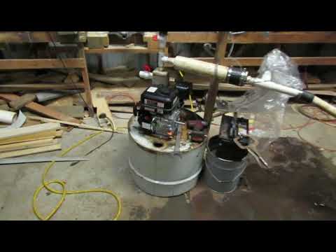

I did get it running Tuesday night. here is the first run video. I started with charcoal that was too wet. once i mixed it in with some dry stuff it worked much better.

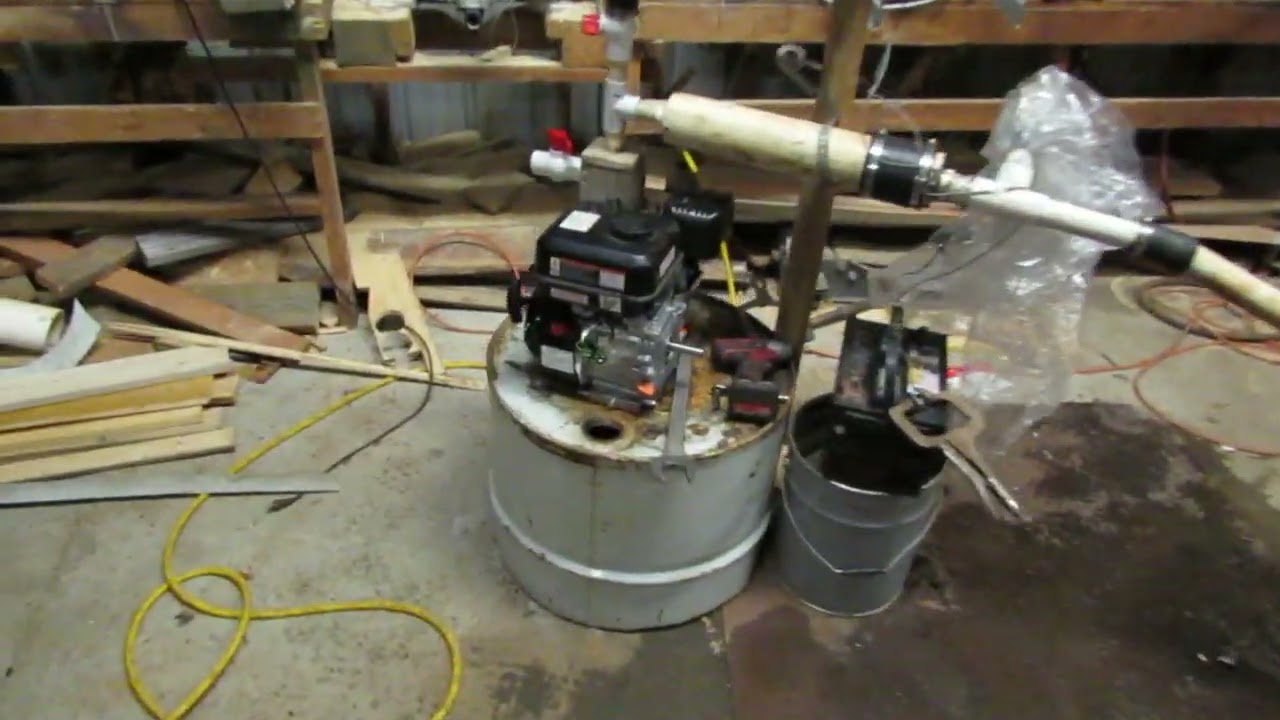

I had a 6.5 hp engine on it initially when we took it to the lake the first time it failed. wasn’t enough horse power to move it. also it was a pull start. I have now upgraded to the 13 hp engine that was on my charcoal powered tractor.
I am still struggling to get the 13 hp engine started although we did get it going today finally.
Here is a video of the 6.5 running. Hopefully tomorrow we will take it to the lake and see if she floats.
Jake at the angle you are running theses engines at have you been disconnecting the low oil shut down sensors, yes?

Not sure if you have researched these much but may have to go with a larger prop with less pitch. They are not really efficient motors anyways just cheap to manufacture and easy to control the draft and steer. Also the boat that you are putting it on is likely shorter and wider than the long narrow indigenous ones and thus harder to drive.
No i actually haven’t needed to. I thought i would have to but it works like it is.
