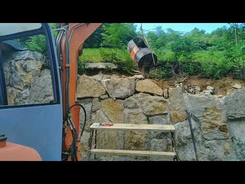

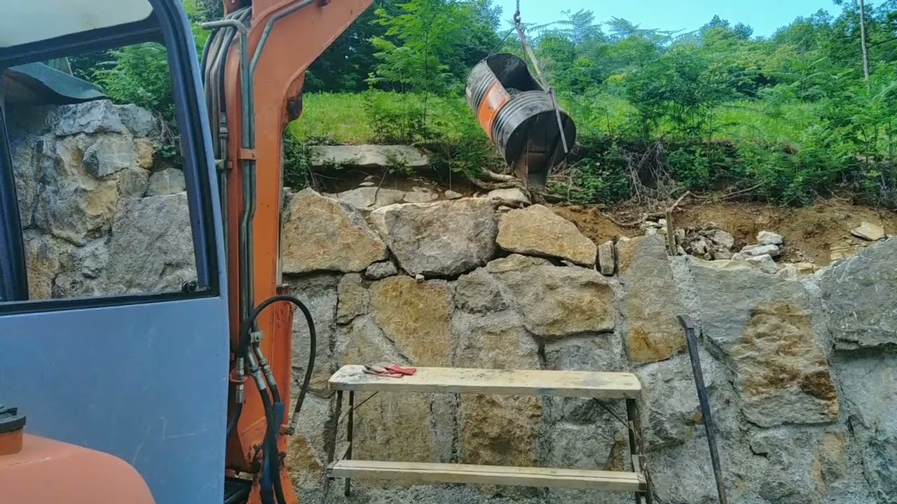

Jacob, will the whole foundation be in the ground? We have a lot of stones here, we always put a layer of stones in the channel for the foundation and poured it with concrete, if the foundation is high, we repeated the process up to the top. Stones compacted with concrete represent equivalent strength of the foundation as concrete itself, if you have a vibrating needle for concrete, it is even better. Mix the concrete with a lot of water so that it is more liquid and covers the stones better. If the foundation extends from the ground, you can build the visible surface from stones (stone scarp), and behind it, slowly fill it with stones and cover everything with concrete.
