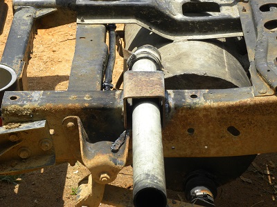

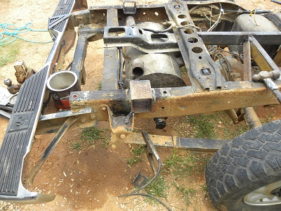

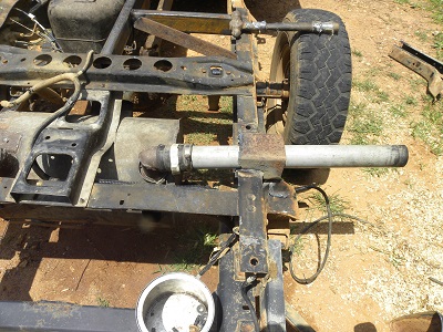

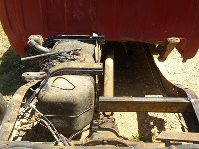

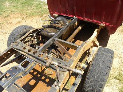

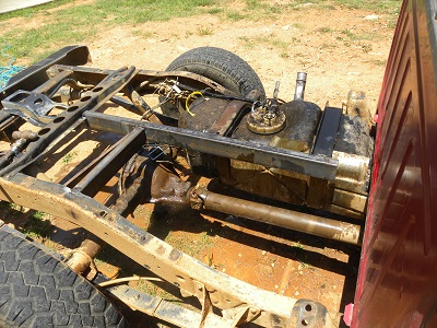

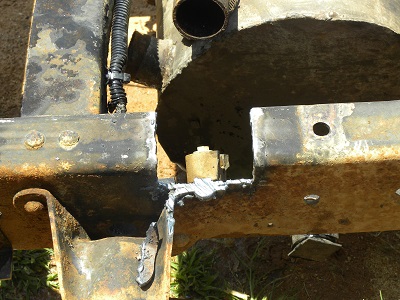

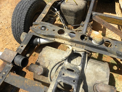

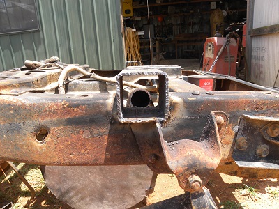

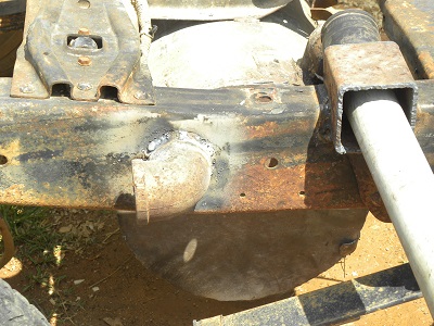

I recommend you lossen the straps on the gas tank and slide the tank as far back as the straps will allow while you have the box off. You may only be able to to get a 1/4 inch of movement but on my build it made getting the pipe going over to the right side a whole lot easier to install.

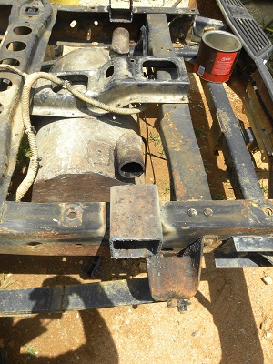

I like your innovation on frame mods for connecting to the condensate tank
On my hay filter one pipe goes on the outside of the frame and the other is a pain on top of the gas tank. I will remember that.

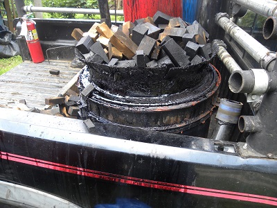

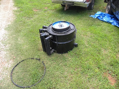

I realize that you are already past this step but I found that after I installed the 12 pipe monorator hopper very little moisture appeared in my 10 gallon condensate tank.
If / when I rebuild my system I will reduce the âtankâ to a sewer type clean out and let the hay filter finish off the condensate moisture that would bypass.
I find the same to be true. Those fins with holes in that I have seem to really cool the monorator and condense the smoke very well. That makes much less moisture to cool the char bed.
I had thought about it but this tank was already built I could not justify spending the time and effort it would take to rebuild it, since I already had one that would work.

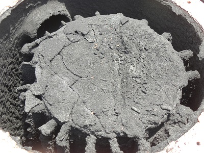

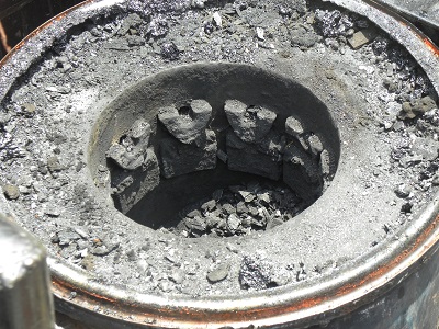

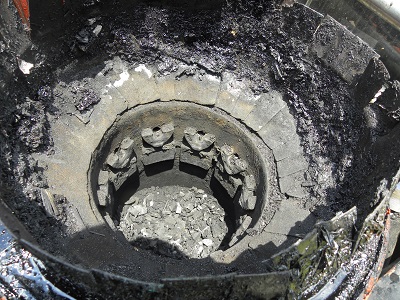

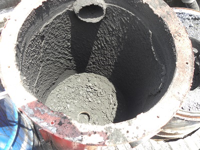

I think it was about time to clean out the heat exchanger. Last picture the hole in the center is the air intake for the fire tube it was filled to there with carbon. I believe a lot of it was knocked off the walls and fins in the wreck.
Just made a trip to Ashland and back with the green truck. I have not yet cleaned the heat exchanger as suggested. Intend to do that soon. The trip over and back is about 38 miles.

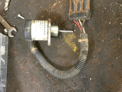

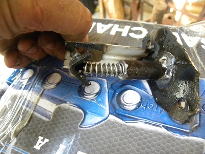

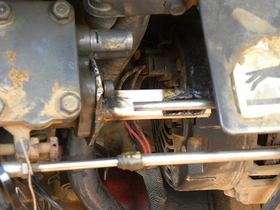

The oil pressure sending unit I think went bad on our skid steer so I built a patch and a shut off pin till I get time to verify the problem and fix it.
