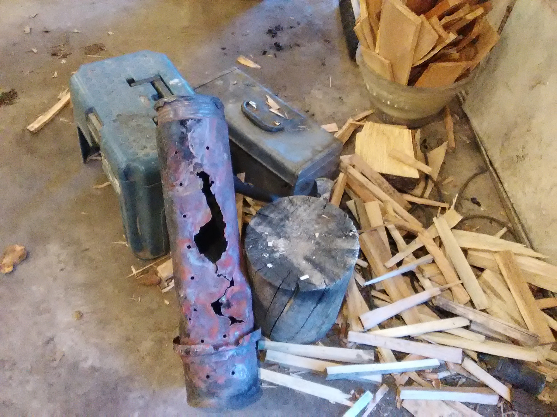

My charcoal fire log has seen better days. I have made 65 gallons in this vessel in my wood stove that heats my shop this winter. I used it some last year as well. I don’t remember how much last year but not nearly as much. The top of the log it the filler of my upgraded simple fire.
Way to go! That is getting your money’s worth out of a piece of pipe. I made out of a fire extinguisher that looks almost that bad.
Stainless flue liner holds up better. I have harvested about 40 feet of 6 inch flexible flue liner. All free as leftover cut off pieces thrown out by a local stove shop after relining jobs.

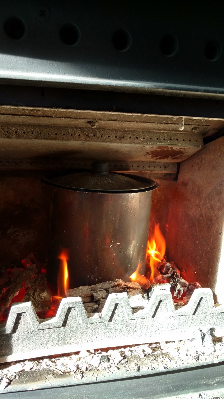

Lately I’ve been using a 6 qt bain marie.

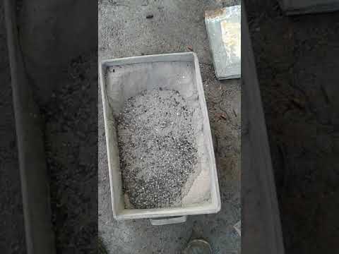

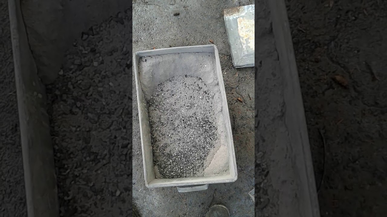

I made my first video yesterday to show my sifting, storing and then harvesting of charcoal. I sift and store cold charcoal that has been sitting in the steel cooling pail for at least a day. This also allows me to use a plastic barrel as primary storage rather than continually emptying my steel barrel into plastic to make room. I have had a bit of trouble watching the video online and will try to fix that after getting some tech help. No dialogue and the sound gets out of sync with the video so I recommend watching with the volume off, you are mostly missing scraping, pouring and clanging noises.
