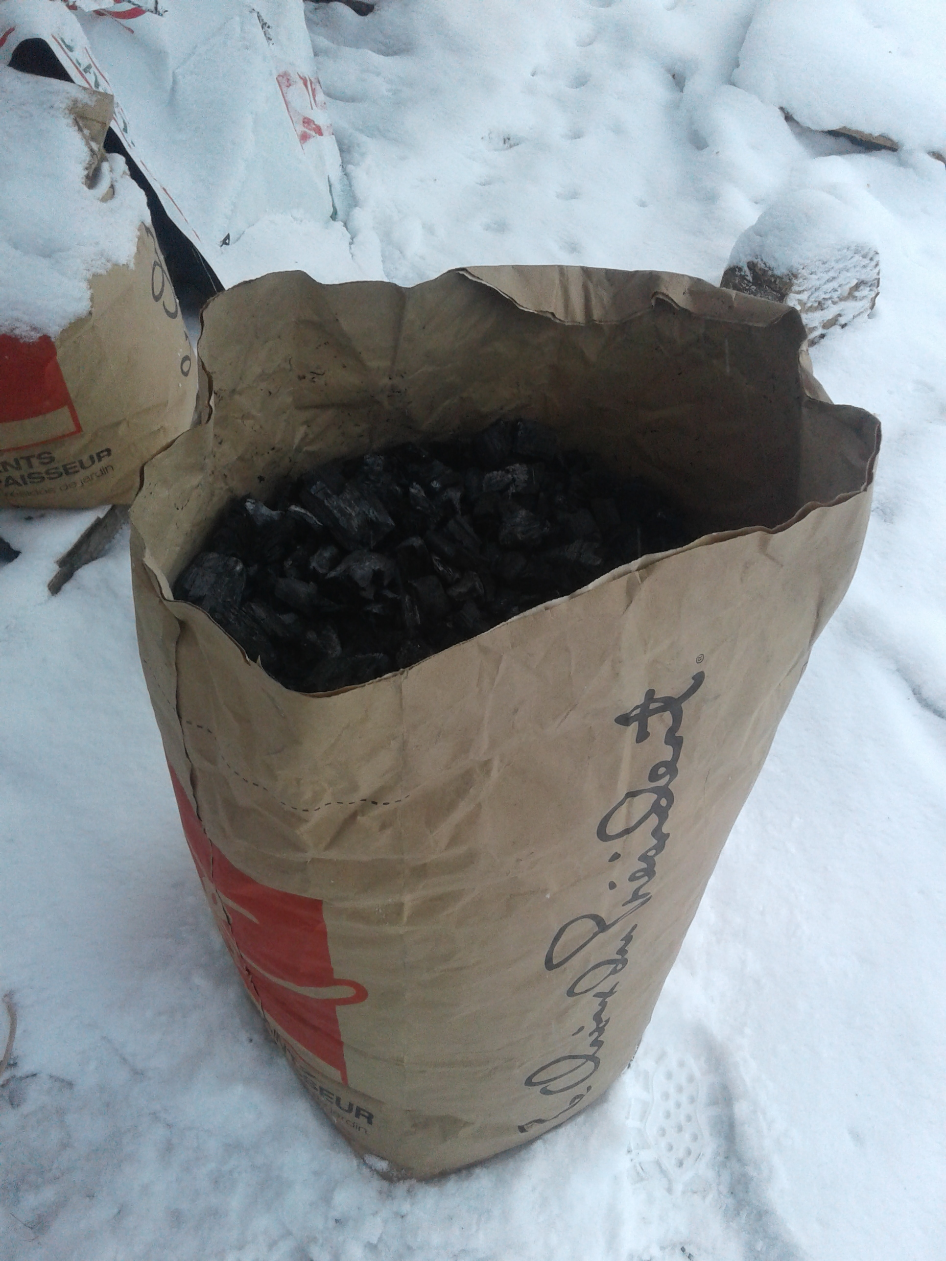

I am currently using a plastic lined paper leaf bag for temporary storage of cooled charcoal. Both my barrels, my cooling pail and sifter were full so rather than not harvest I started dumping cold char into a large bag that I saved in the fall. I think I now have half a bag of charcoal that I would have missed due to lack of storage.

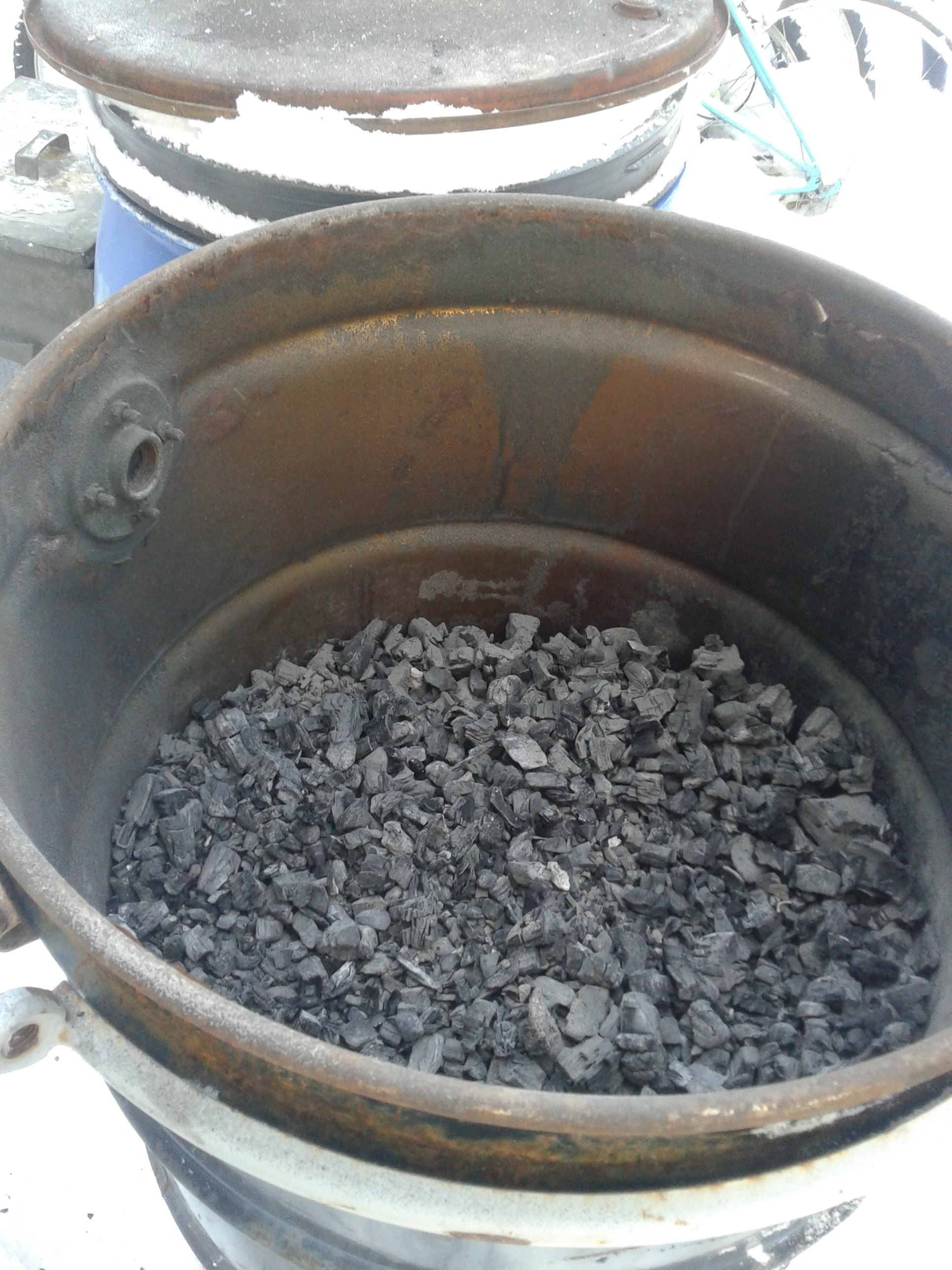

And this is the barrel that David brought me this morning after dumping the leaf bag, sifter and cooling pail into it.
9 days ago I started storing charcoal in a bag since I needed a barrel. David brought me a barrel and it is now full and I am back to a bag again. I sense a pattern.
