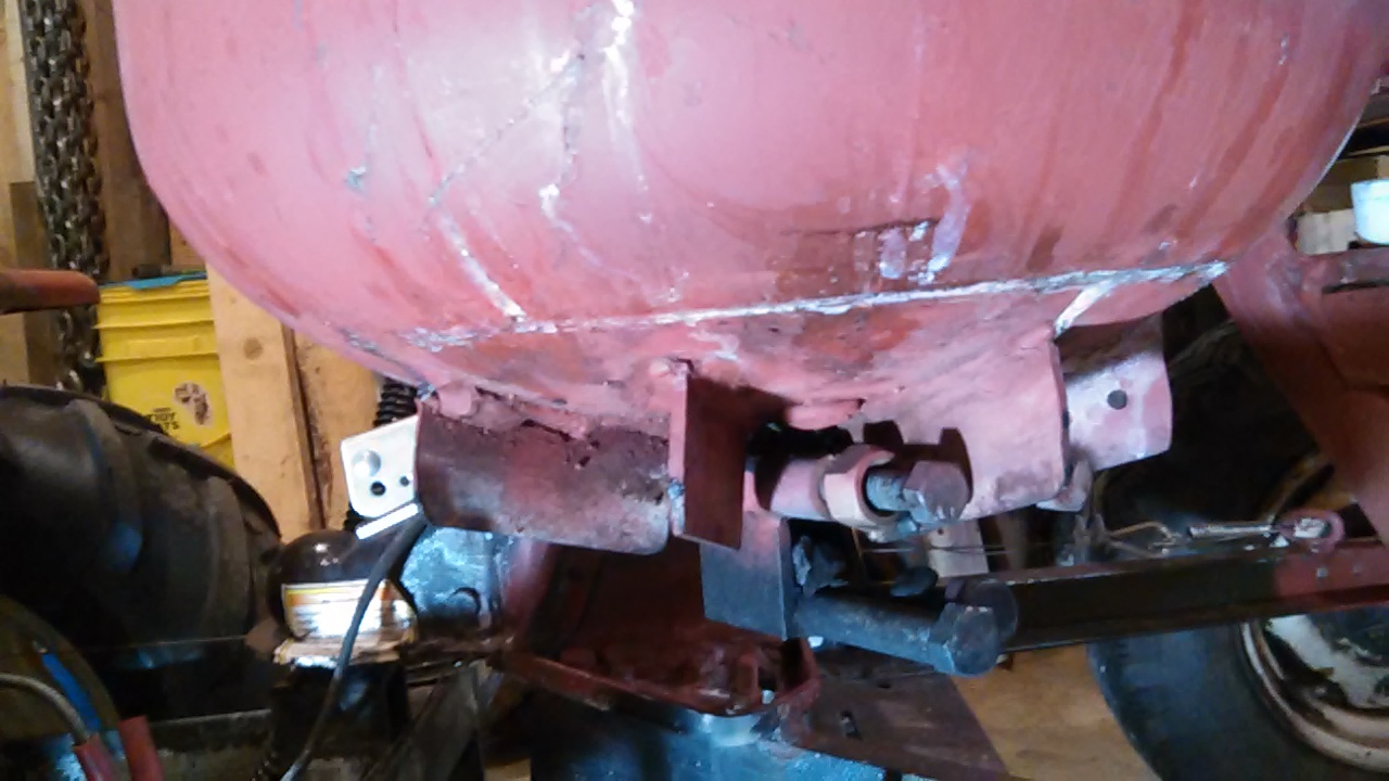

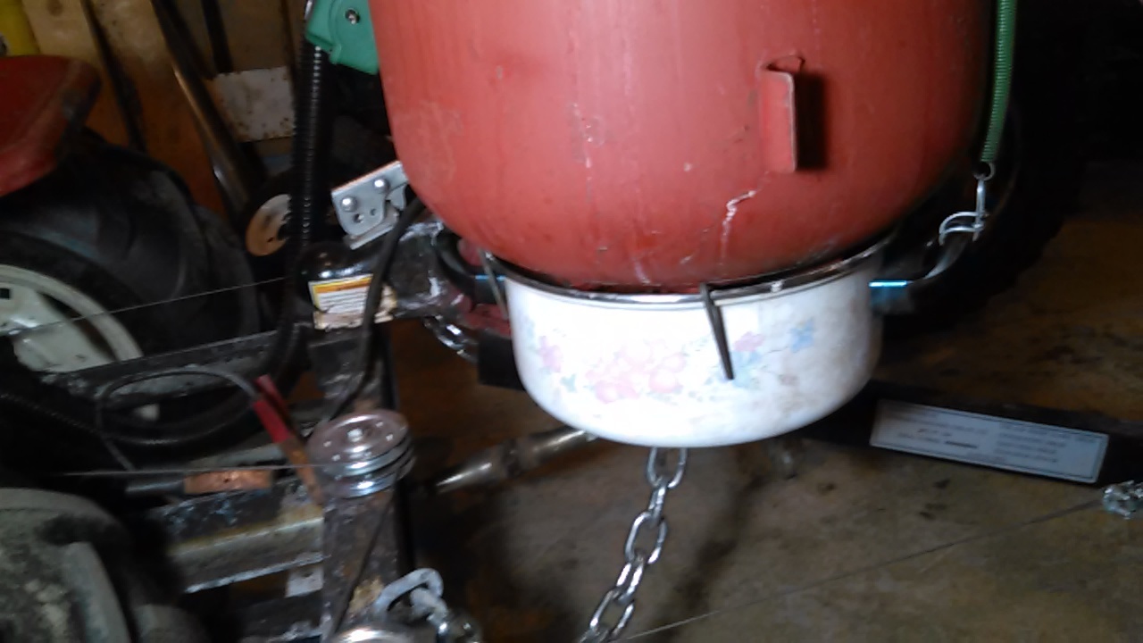

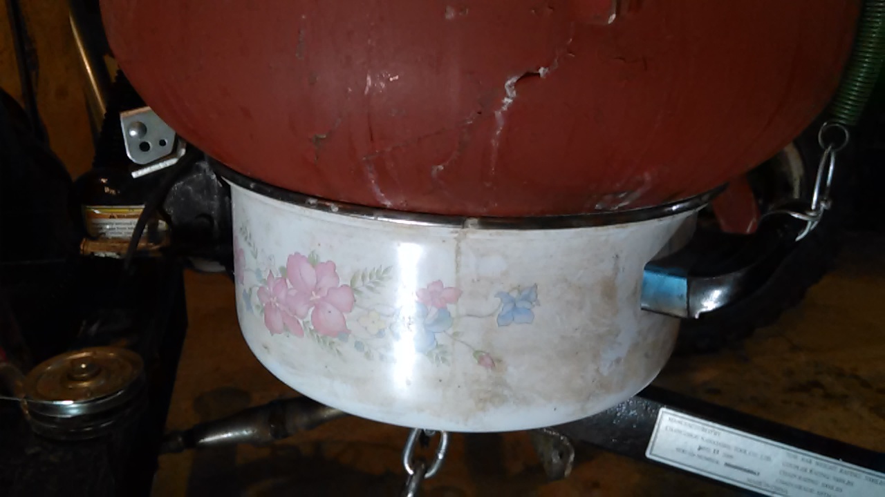

Hi Thierry, my hypothesis is that the engine will be able to draft the fuel into it’s intake at a lower constant vacuum. Sweep more of the dust out of the charcoal, a longer run time before cleaning out the charcoal.
So, moving down toward the humidity pan.
Above the pan is in shut off mode. Charcoal gets smothered.

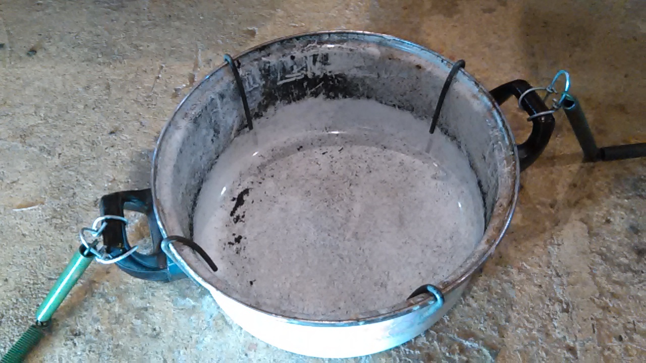

Above the four spacer wires are in place.
Above is the heat interchange fins that help to preheat the incoming air.
Above the pan is in the run mode. Air enters between the space between the top of the pan and bottom of the producer.

Do the preheating fins touchthe water? That might give you extra vater vapour.
It’s mobile so there is a splashing effect.
