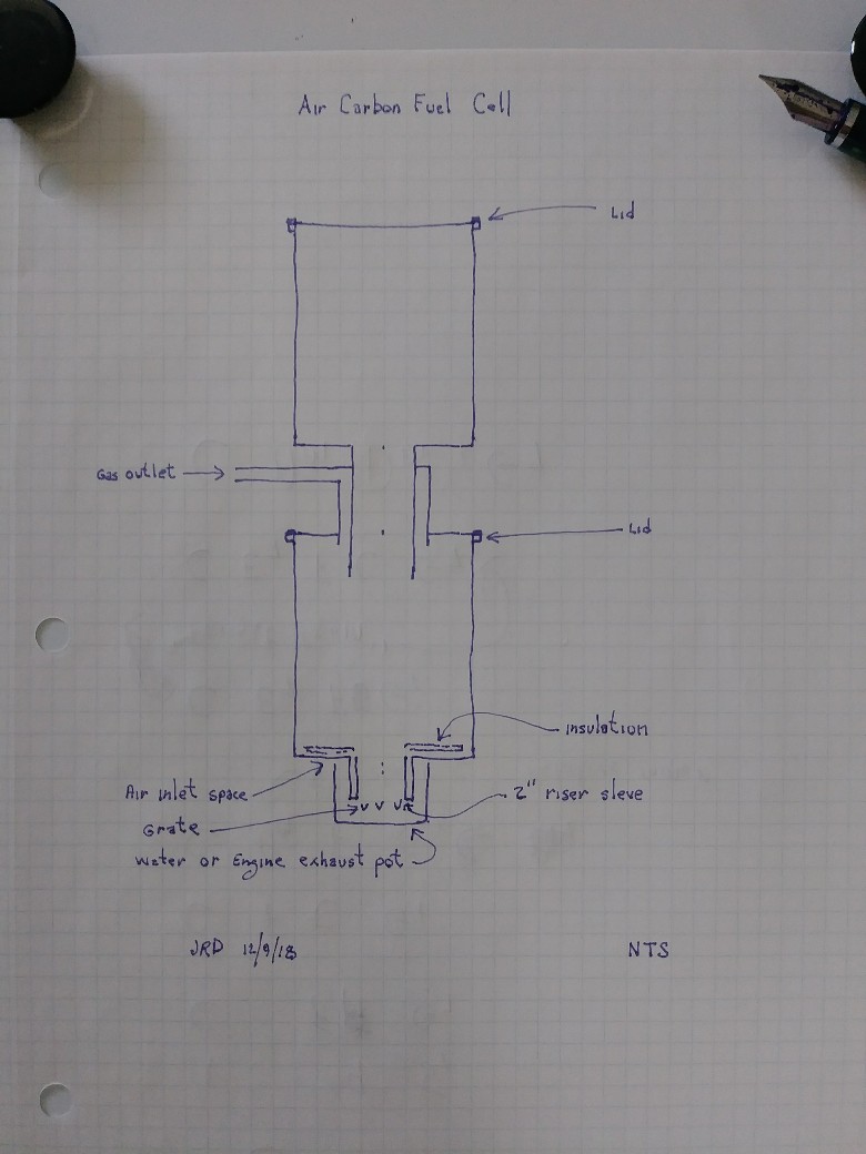

Hi Jeff, I like the metal buckets and you new Idea. It makes me want to start on one like this.
Super light weight and if you put some ceramic insulation in the lower bucket that might help with heat.

According to the Egyptians, you can take it with you! Might as well make the best of what time you have left! (although I am unsure whether woodgas is up on that list..) Plus you usually can get at least half the money from it from craigslist for tools like that maybe more. Honestly it looks like about the size of a coffee can or 1 gallon food can if you can still find a metal one, but what -might- work almost perfect is a freon/refrigerant gas cylinder. How hot does that center section get?

I see the clinker cones others have developed and wonder how you ever cleaned out your unit?
Those are wonderful sealed lid buckets, never have seen that type.

Slip rolls would be also used for filter housings and etc. Maybe recycle barrel sheet metal, hot water jackets or what ever.
Gas temp out of red gas producer (red cooler/filter) can leave your hand on it. Never had the time to measure it.
I also plan to fuel a foundry with the red gas producer.
I remove the grates and poke out some of the charcoal to clean it. then screen that charcoal and re-use it.
Just about any grate will hold up as long as it is not up inside the oxidation zone. I might try sheet metal bent into angle iron shape.
I will be trying to use more recycled sheet metal instead of new plastic stuff. Still will use plastic hose. Charcoal doesn’t seem to rust metal too bad.

to clear my mind, what are the main benefits of isolating the hopper from the redox zone?(for a gasifier with charcoal)
in order of importance
1:keep the hopper fuel always fresh (for maximum responsiveness)
2:reduce the drag to a minimum
3:facilitate maintenance (ashtray cleaning)
4: SEEK OTHER REASONS?

Thierry, the fourth reason would be to not release the moister in the fuel hopper all at once or there about’s. In my climate I can not keep charcoal 100% dry all the time if ever. Not a perfect world. The fifth reason is to keep the variables consistent so reducing the need to adjust air fuel ratio. Consistent vacuum and consistent moisture. The sixth and most important reason is that I like to have fun!
To be honest, just about any design works with charcoal. This is just the silly path I am traveling on.

If one would weld a 1" long 2" diameter pipe that extends above the grate, would the charcoal on the sides of it be enough where it wouldn’t need refactory cement? Or would the top of the 2" pipe burn off?

Jeff, l have a question for you. I looked up your system on Eddys skech thread, it says the transition between the hopper and gasifier is 5" dia. You ever experianced any problem with pluging/bridgeing?
I plan to use a bit corser fuel on my MB thain clasical engine grade, say around inch dia or so, and l need to make the transition as narrow as possible. Any recomendations?
