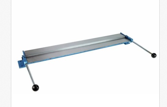

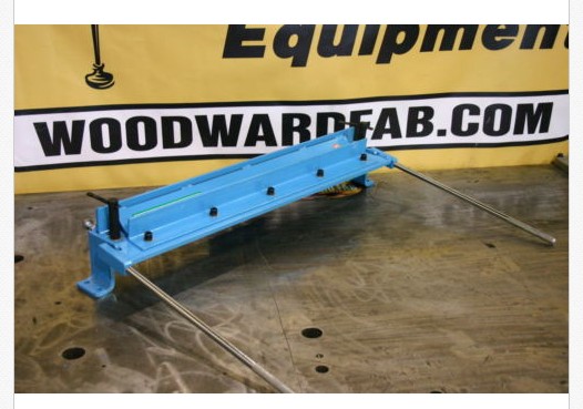

Getting back to using a brake to replace slip rolls to make sheet metal cylinders. I could make octagon or less sided cylinders or make a lot more bends to come closer to the cylinder shape. A wild guess would be 8" to 5" diameter cylinders. It would be nice to go down to 4" for the filters. SO my question is; can one of these brakes keep bending until a cylinder like tube is bent without the brake, it’s self, interfering with the sheet metal bending into shape?
Cheap brake:
Cheap
Better brake:
Better
They are on eBay. I like the better brake but there may not be as much clearance for the last bends of the sheet metal cylinder like tube.

IThink the brake in the top picture is like he one I have and the clamp bar is just loose. It’sA pain to line it up and clamp it down each time, but it would allow you to easily slide it out of your cylinder. I think the bar s 3" wide so a 4" cylinder would clear, bot you would be clamping over a previous bend.

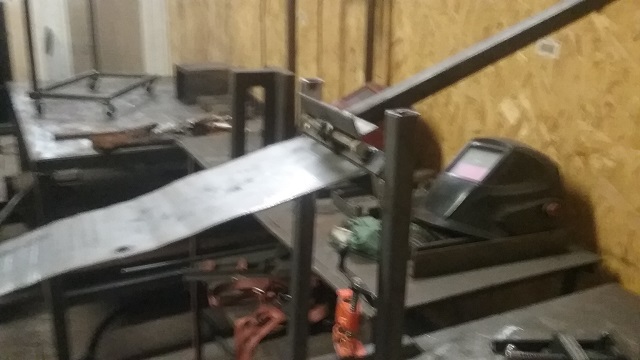

Jeff, Matt posted a brake he built to do just what your talking about. Hopefully he will see this, and re post. I don’t remember where it is.
Thanks everybody!
Andy, maybe I could make a modified bar that would be narrower. Of course I like the better brake but if the cheaper one works better than there is no choice.
It would be nice to make my brake but then I would be spending time on that instead of gas. :disappointed_relieved:

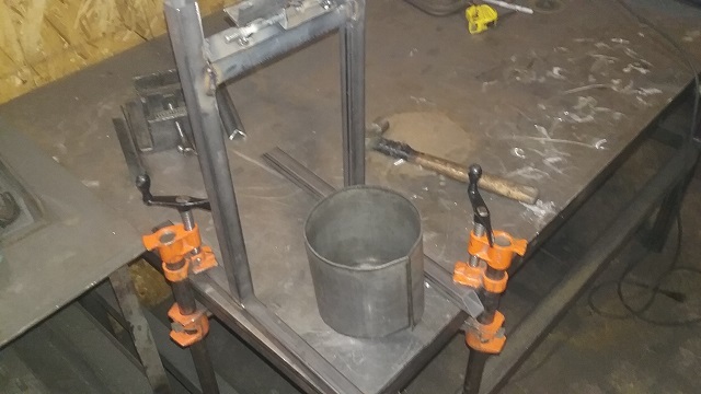

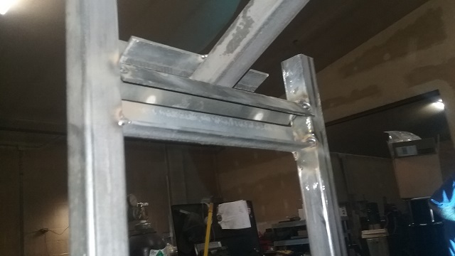

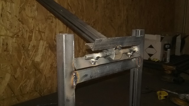

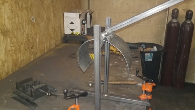

Matt’s invention. I’ve been meaning to make one.
002
005
006
011
017
I have one of those vise mounted brakes. Though you can make a cylinder, they are only really built to handle up to 18ga, (start to deflect) and it’s a real trial of patience, as you have to clamp for every bend, and guess at what angle for each bend, and still end up with a faceted cylinder. You have to start on both ends and work towards the middle, then cinch with straps, weld, then hammer form. The facets can be fixed by hammering on a mandrel, but it starts to get artisinal.

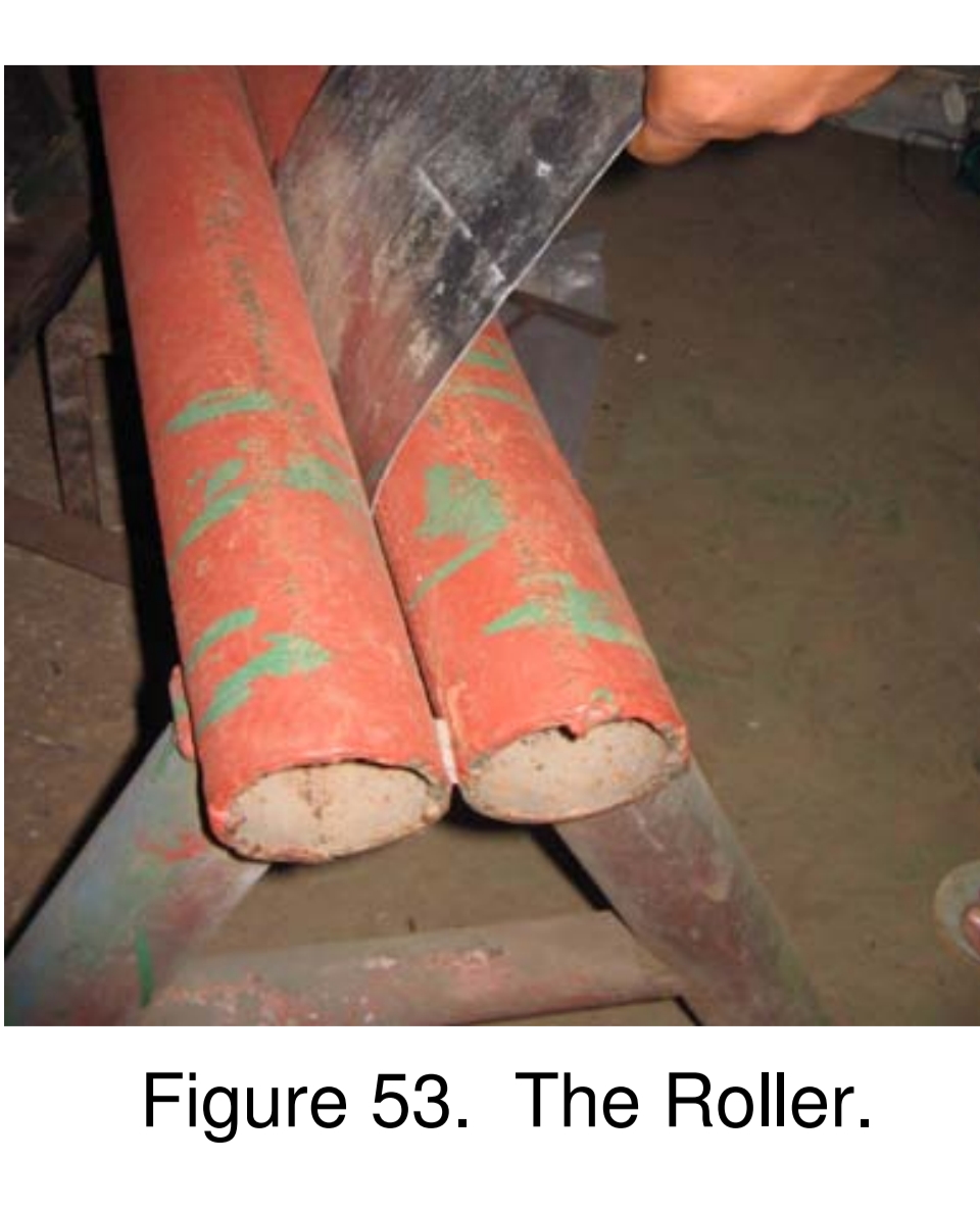

This is a Philippine system which should work with up to 12ga with a bit of effort, again starting from the ends, and a bit of persuasion from some weight and a big dead blow mallet… Credit to Mr. Belonio, in his interesting document, Rice Husk Gas Stove Handbook.
To close a cylinder it would have to be very sturdily braced and open on one side, or have one forming pipe secured by bolts.
The nice thing about this approach is it will not leave faceted bends. Either approach will need fairing on a mandrel, the artist’s touch to whatever degree is satisfactory. :smiling_face:
I like the two pipe idea. 18ga or less is fine for me. I’m just working with metal 5 gallon buckets. I think the side walls of 55 gallon barrels are 18ga and that would make a good source of sheet metal. I plan to pop rivet everything together and some bolts, no welding.
