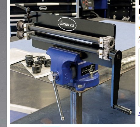

Hi Hristijan, one of those will be on my list of tools to get. It sounds like a bead roller:
Bead-Roller

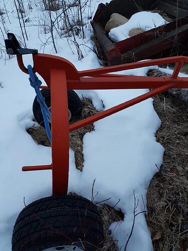

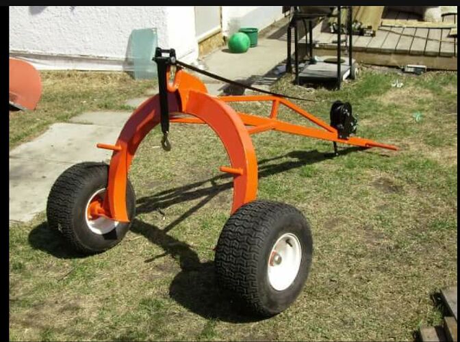

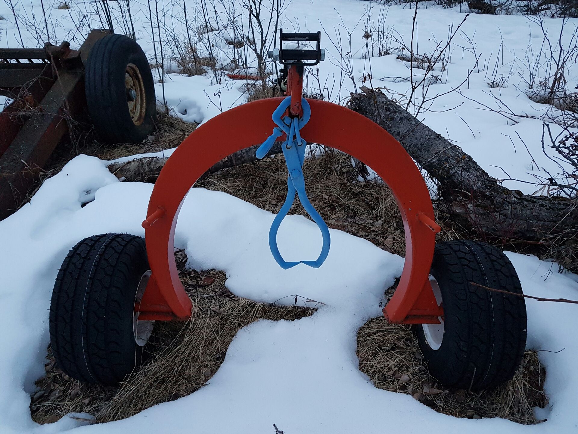

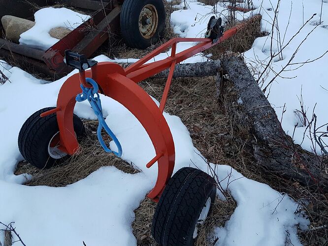

Ok. I’ll jump in, it’s only a modest work, but relates to forestry, making smartest use of energy.
This was a direct copy of a model offered on a website. It can be used by hand with a T handle, or on any length of rope, or a 2" ball. As a fetching arch it allows retrieval of logs from areas you can’t or wouldn’t go with machinery. Keeps the logs clean, any length can be handled. For use on rough ground larger diameter tires would be smarter. The commercial model had interchangeable skis for use with a skidoo.
I like that small log tong. Interesting way to make the arch, round shape out of plate. Nice!
:sunglasses:
It was easier to cut the profile out of 11 or 10 ga, and weld than to bend tubing.

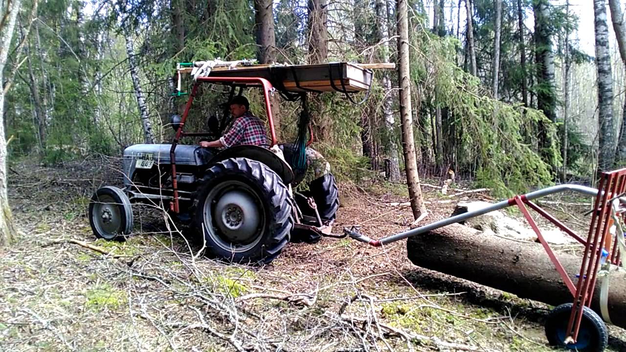

I rescued a load of rectangular tubing from my neighbour on its way to the dump. The “handle” is a knocked over lamp-post that happened to get bent into what I needed. Wheels were stored away in my shed. Can’t remember where they came from. My arch is not as pretty as yours @taitgarry00 , but it works.

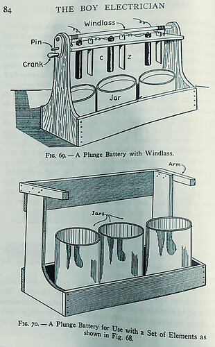

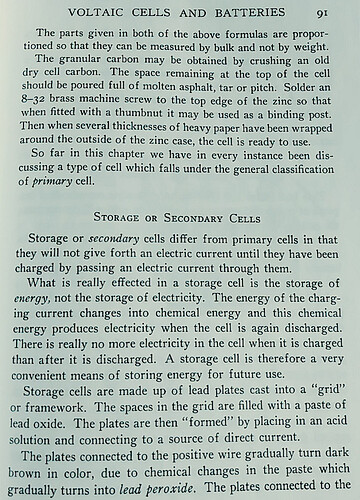

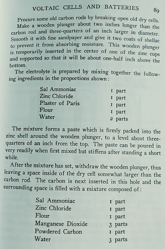

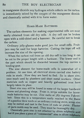

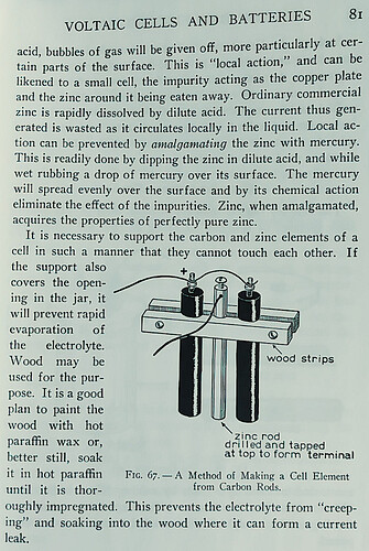

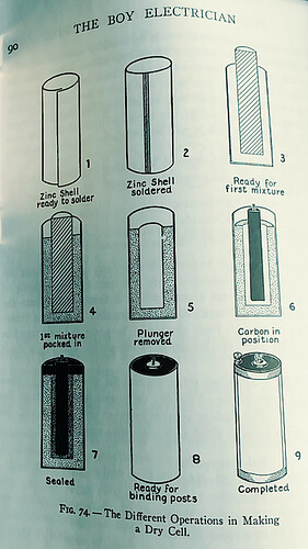

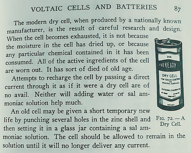

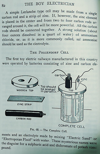

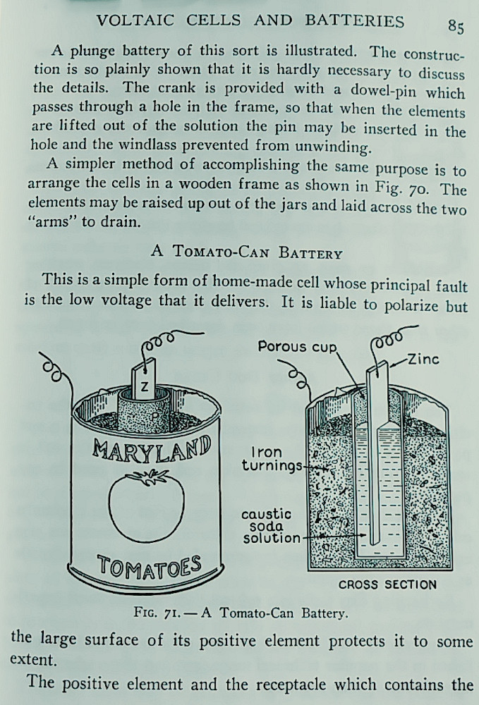

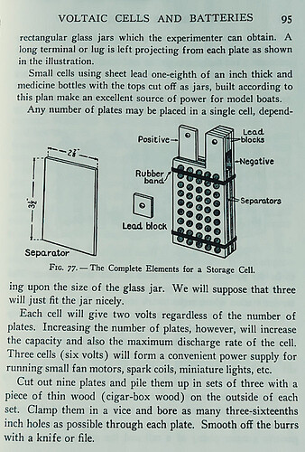

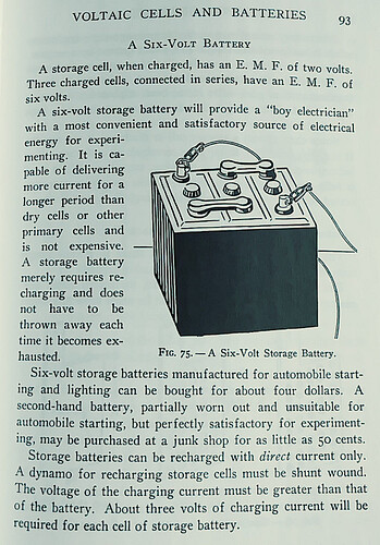

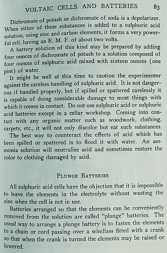

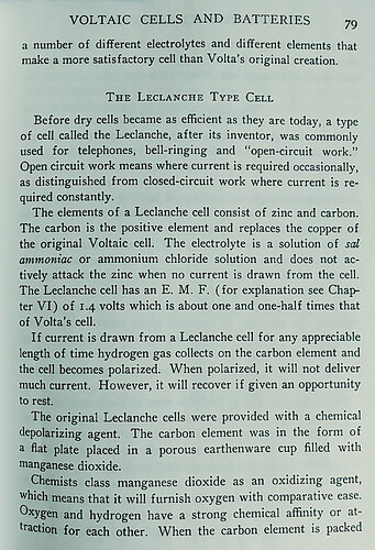

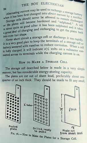

Have an old book with instructions for homemade batteries. Been meaning to post this for two years, just could not make the time. Here is a little less than half the pages. It ends with a homemade lead acid 6 volt battery. More to follow when I rest up a bit.
More to follow.
JO_Olsson, nice arch. Thanks for sharing!

Hi Pepe,
It is entitled “The Boy Electrician” by Alfred P. Morgan.
A few more pages:
More to go.
Having fun with Gimp.
:sunglasses:

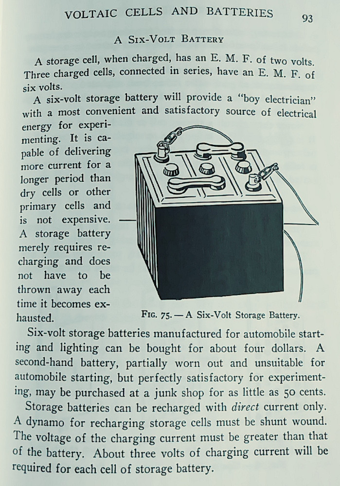

Four more pages:
Four or five more pages to go.
:sunglasses:

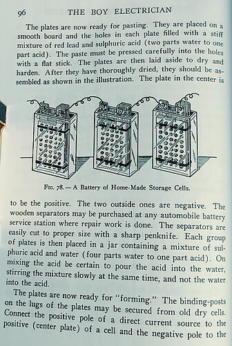

These are the last of the homemade battery pages from “The Boy Electrician.”
The end.
:sunglasses:
A 6 volt car battery for about four dollars- wow!
Thanks, Jeff.
Yes, thanks Jeff. I love this stuff. I keep hoping that I can come up with some cost-effective method for making a rechargeable battery. Nickel, Iron, salt, wood ash, charcoal, magnesium, copper, aluminum and zinc are on my hot list of possible components. No doubt this is a fool’s errand for me. Somewhere I have an old book that describes a rechargeable cell made from long strips of cloth layered with graphite.
