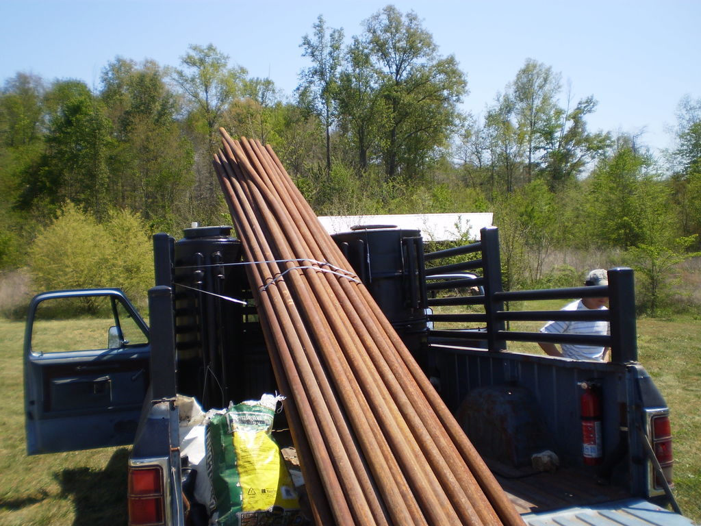

Chris Franklin is coming by tomorrow to see the new truck and chat a little. Also to get some pipe from the Gate Capitol of the World. I went to the local gate company a few miles away and got him some cheap rusty pipe, lots of it. This is for you ChrisF!
I would like to find a load of cheap pipe like that! Good work.

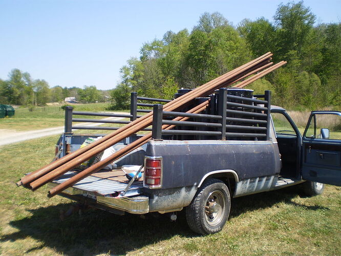

Hey ChrisKY
Great, great picture set of how to carry 18-20 footers of anything on a standard sized pickup truck!!
That was my point on another topic line here.
What I do a bit differently to save the bodywork on my 94 Ford that my wife thinks is hers is pop off the the tail gate to “save It” and lay a 5 foot long 4x6" wooden bunk in top of the rear step bumper and and quick wire it on with old #9 copper washed soft steel telephone wire (same as current day orchards/vineyard/clothsline wire). Then with a cordless screwgun, some construction screws, bit more wire/baling twine I can tie down near anything.
2x4" board wired across your top cooler tube would do the same thing and save the paint and denting.
With 2/3rds the load wieght low and near 50% over the front axle bet the truck even handled well.
Makes it easy to single man from the ground slide up and slide down load too.
High horizontal load carrying is literally “for the birds”. Top heavy. Hard to load. And I’ve seen dangerous forward load shift sliding with heavy braking.

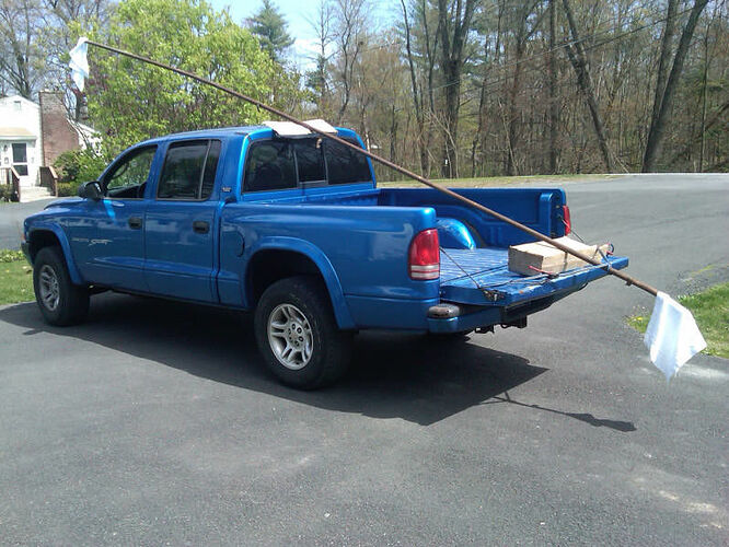

I am almost ashamed to post this picture, but “it is what it is”. Here is a photo of my quad cab with one section of 20’ pipe on it. I got some paint scratches trying to do this by myself, but I had to see what a 20 footer would look like in an ultra shortbed (with no gassyfire init). The pipe is almost centered on the back of the cab, and it is a 20 degree angle - and really wanted to slide off. I will post more about this on the thread about “coolers for shortbeds”. The later model Dakotas dont even have holes in the top surface of the bed sides for stakes or to put the down pipes through.
Anyways, great work on the trip and gathering and hauling materials. What is the wall thickness of the pipe you are using ?

Big difference between a 5 1/2 foot shorty bed and and a standard cab 8 foot bed like ChrisKY was and I have used to haul 20 footers.
I have a pickup truck portable (Ute) New Zealand brand swingsaw mill. Factory tracks are 20 foot aluminum boxed sectioned. Third hand Used; I bought it with these metal thieved gone by-by then operating on 20 foot channel iron made up heavy as sin rails. No way I was going to carry these 275 miles across my state completly through the Urban gut Puget Sound Metro areas on often bumper to bumper 70 MPH freeways. Cut them in half with a hand hacksaw to bring the mill home. Bought a new 40 foot extension ladder using the 20 foot sections as my tracks. These I will county road, state road, freeway haul around because they are 70 pounds each instead of 200+ each, and I look “normal”, “contractor” safe.
Ha! Ha! Up here seasonally in the past you could have just put a net hoop on one end of your test pole, red flag on the other end and called it your smelt ( small annual migratory fish like a herring) catching pole and blend in and been considered a normal fish-hick.
Best not to put more than 150-200 pounds on a cable tailgate. Cables bend weaken open and closing. Will break sooner or later. Puts a big ugly crease across your tailgate from the bumper.
Steve, even with the tailgate down, its only about 7’ 6"… thats still short. It could handle the length better using a headache rack until the load gets too heavy as you have pointed out in other posts. 90% of the time I use the truck as a car or passenger vehicle. Will also be towing a boat and BBQ rig, light stuff though…
