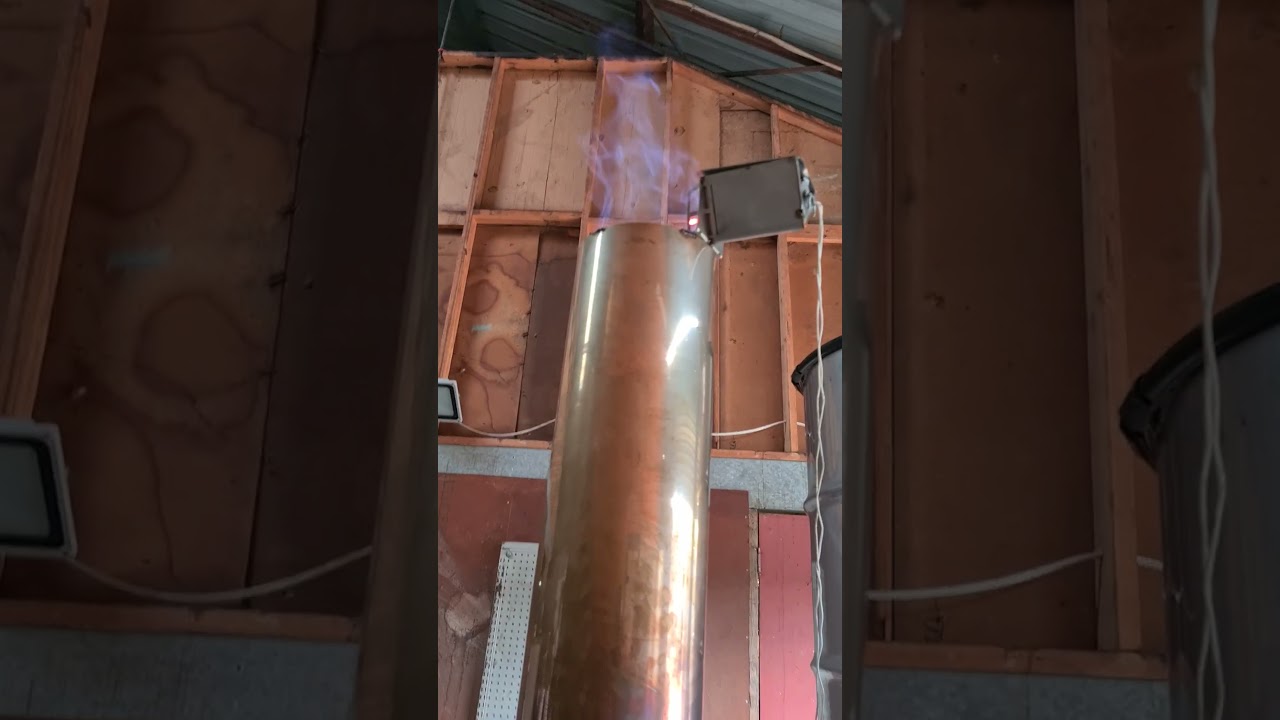

As promised a update Today was the first chance we had to have a play with one of these Power Pallets units , we decided to start with the unit with the extended feet ,as that was the unit Andrew said they been working on .
We emptied out the old filter material as it was compacted mouldy and disintegrated and filled with nice fresh wood shavings open cell foam and Lambs wool
Well i am just gobsmacked at how nicely the unit flared once we managed to get the heat gun to it .
Now we have it running we might tear it down and do a deep dive inside to make sure there are no nasties’ hiding away in out of the way places and we are still to understand the readings fully on the screens although we now have found a video explaining some of it even though there start up instructions do contradict themselves from time to time , still time will see how we get to grips with these units .
First flare
and the short run video , excuse video quality its def not one of my skills that’s for sure .
