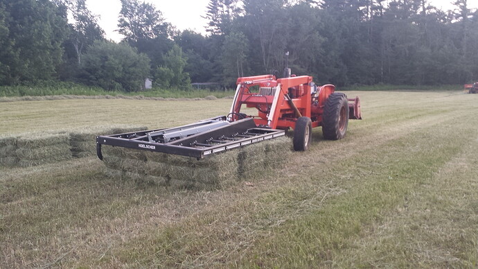

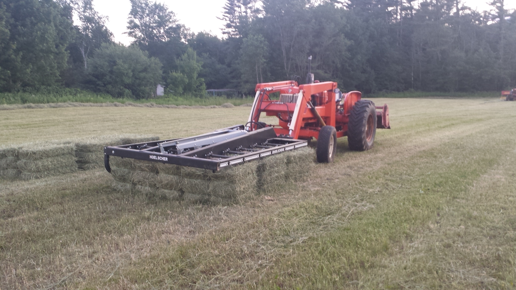

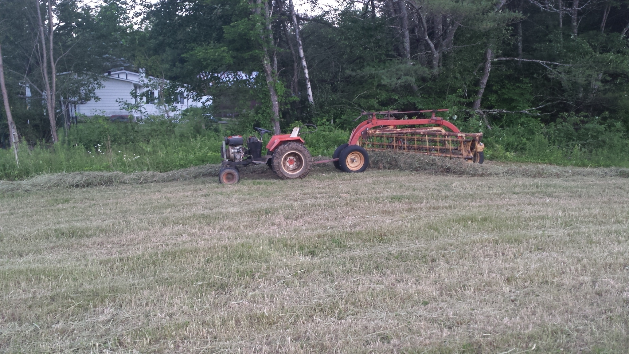

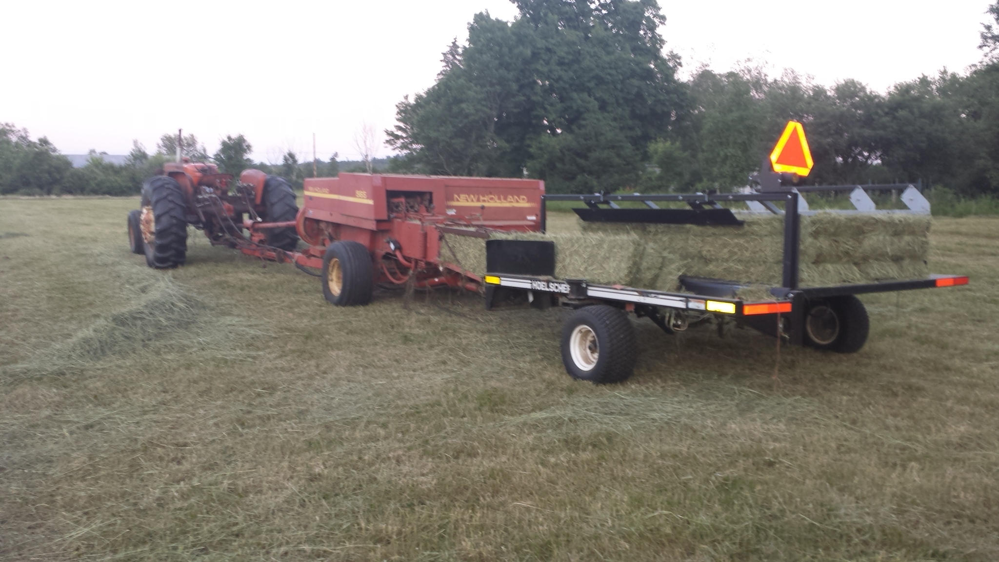

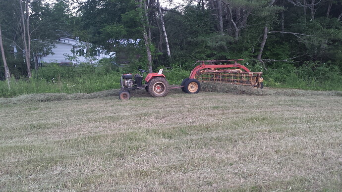

I have an accumulator and grapple system. The grapple goes on a loader frame and picks up 15 bales at a time. The tractor with the hay grapple had blown a hydraulic cylinder to curl the bucket. I use it to plow out with that is my allis chalmers d15. I rebuilt the curl cylinders this last fall must have a defective seal is all I can think. The other tractor is my ac d17 which is in the middle of a motor overhaul. And the little tractor on the rake is a case ingersoll 448 garden tractor with a 10 hp Chinese diesel motor repower I didn’t last spring. I think it raked all 10000 bales last summer on 7 gallons of diesel fuel. It is the funniest thing to see raking hay.
Okay that is almost worth a trip to NH to see the 448 pull that in the field.
Sean the best part is it still has terf tires and snow chains and it pulled that up some big hills with win rows big enough they would barely clear the dolly wheel. Sometimes I had to get off and clean it out if I was raking over. These fields are crazy productive.
I need to get a set of ag R1 tires for it this summer and fix the mounting bracket for the the radiator support and fix the steering the gear on the end of the wheel shaft is all worn out. But that little tractor is a portable hydraulic pump really and it has a rototiller that I do my garden with and a wood splitter. I could mow the law if It modified the front hand pull start on the diesel motor and put a belt pulley back there or if I modified the mower deck to run on hydraulics. But I get about enough ussage out of it as it is. Those little case ingersoll tractors are the best. They have 16 inch rims so you can put truck tires on them if you want.

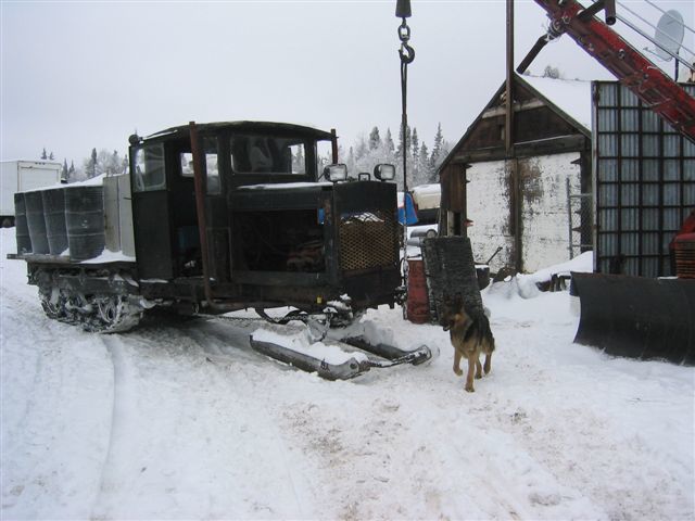

You might like:
He lives way up north in Lynn Lake Manitoba. He runs 20+ old IHC and Cat crawlers from the 40’s to make a living. Interesting lifestyle, and tons of old equipment. He’s even still working a '39 1 ton flatbed, and a couple Linn half tracks that are probably from the 20’s:
