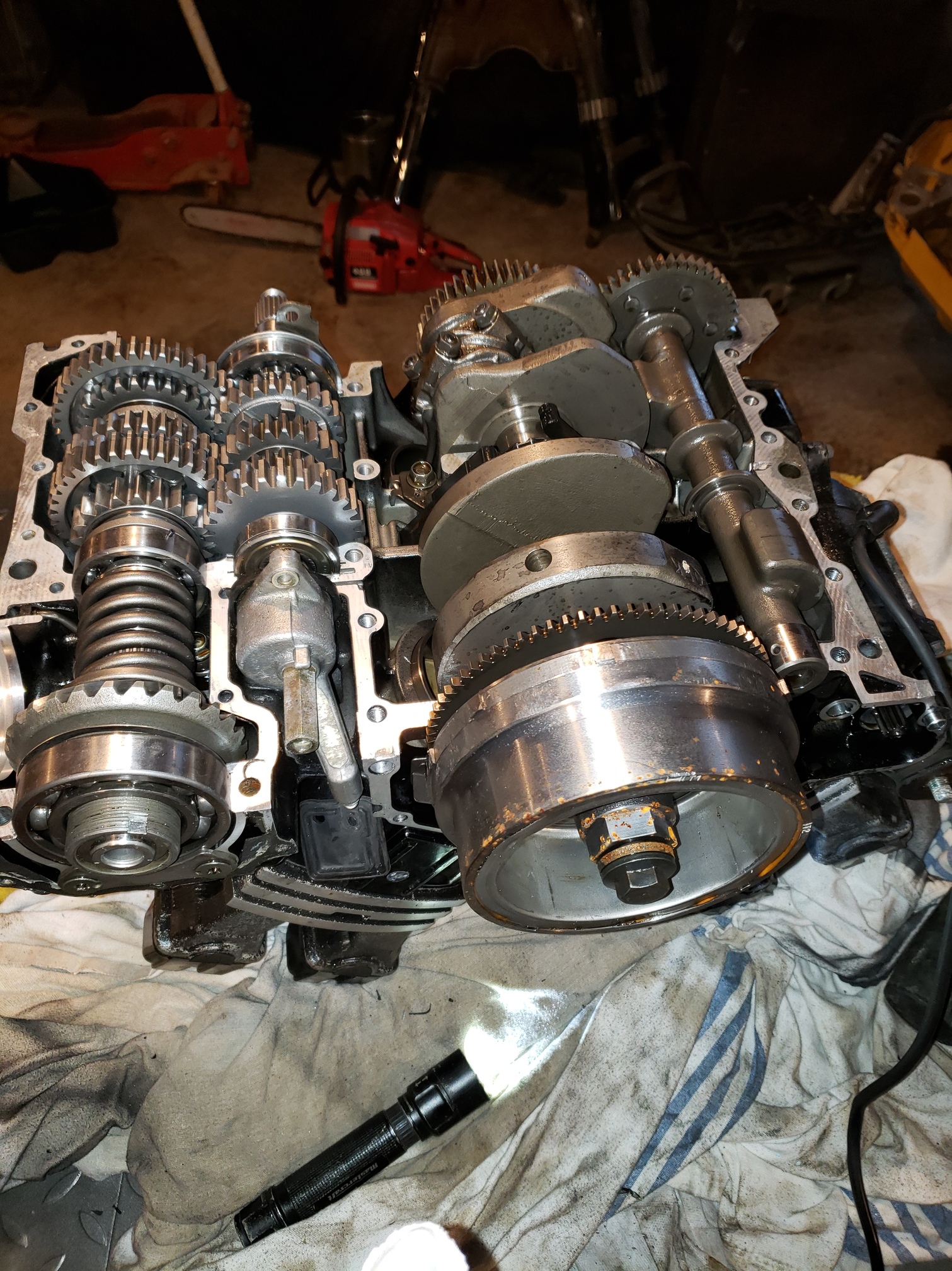

I tore a Yamaha VMax apart before i went to work last time and now i have to get it back together and out the door so i can start on my gasifier.
Transmission overhaul..popping out of second gear Fun Fun

What causes that popping out of gear? Is there a detent somewhere that wears out?
It’s a flaw in every Yamaha VMAX from 85 till 2001.
Where the gears dog into each other gets worn out very quickly and they need to be undercut so that they will mesh properly.
It’s not even the teeth of the gear it’s the dogs.
So you send the whole gear set away to a machine shop and have them undercut and while you have the transmission apart these Vmax has are geared very steep in 5th gear so they are hard on fuel on the highway. So I install a 5th gear out of a Venture Royale which is geared different to lower the RPM.

Yeah, the repair will cost you about 1200 bucks if you do it yourself.
