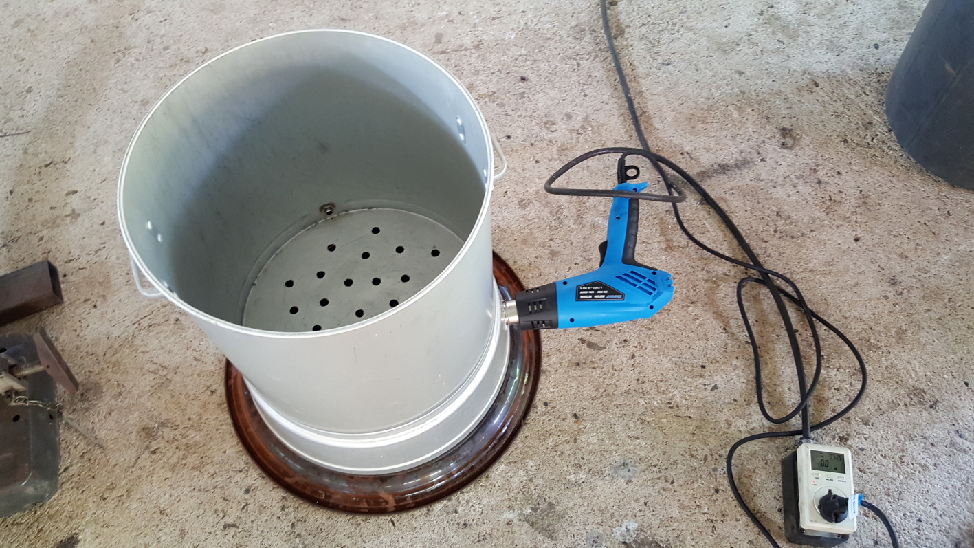

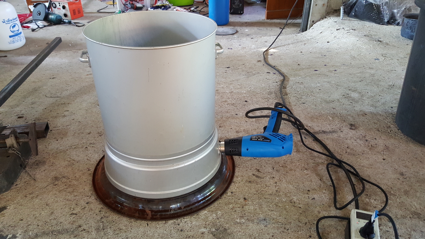

For me, i use an large can, induce hot air with a paint strip gun… as for drying material to test in or from my oven

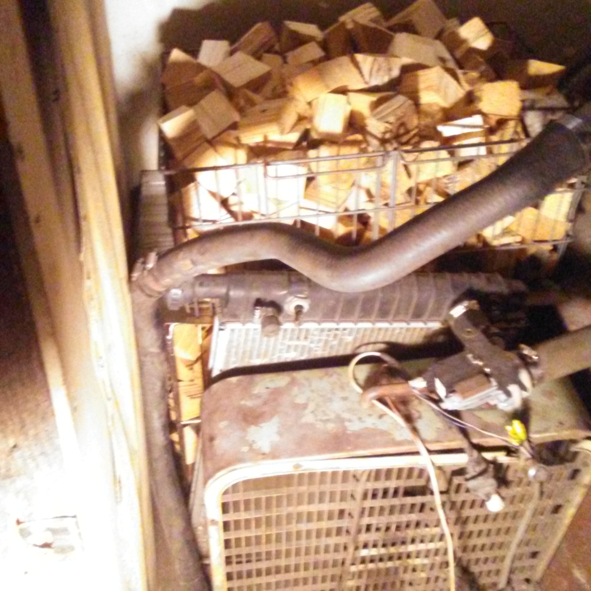

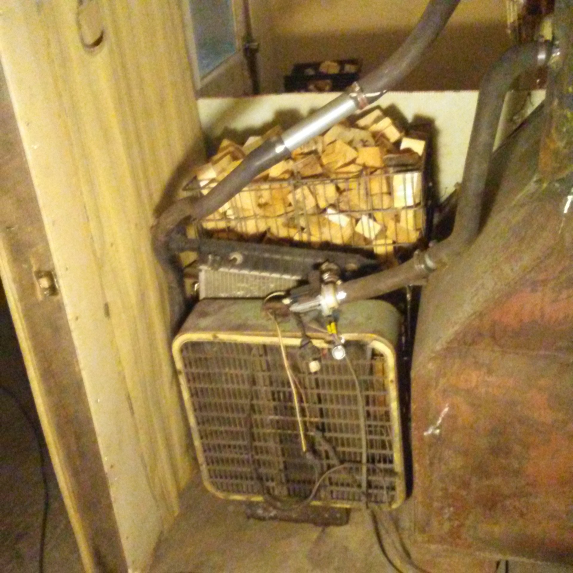

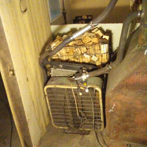

I know the best way is set some wood aside for next year, though i burn wood when i buy it. The barrel is a good looking back up dryer set up or test batching, i got a radiator from my water boiler heater in garoge and it gets about 99 too 120 at the wood temp when runni g fan in day time. Ges i will just let the wood dry long
er, or a couple weeks too see how much lighter it will get, while i work too make some change fixing washer dryers, mechanic repair work.Thanks for the responces, I gess this is the most accurate way too be more sure is dry the wood longer and then weigh till no lighter weight mesurments.&&&&&&&&& Just addjusted my choke restrictor distance and diameter,and using the same wood 8.5 too 9 # after the full five gallon bucket weight, with few chunks over the top. So for me 8.5 pounds of white pine dryed out seems too work, drove about 38 miles and this morning all 5 butterflys/throtle plates were all nice and free no tar signs AT ALL.PS the fan in the pic got junked to day after finding the smokeing culpert.
