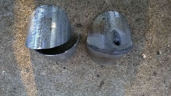

OK, you challenged me a bit, Arvid. Yesterday I watched some tutorials on my flux core and how not to MIG weld. I wondered if I should just buy solid core wire, since it’s cheaper and my flux core welds seemed to be over oxidized anyway. I got to see what a MIG weld looks like without shielding gas. Wow. Looks nothing like my welds and a lot like moon rock. OK, my flux core is working to mostly shield the weld.
One of the videos about my particular $90 welder mentioned the recommended extension cord gauge and length. That made me think that I am using too long and too thin a cord. Maybe the voltage drop is causing weakness so that the “high” setting becomes “medium” and the “low” setting becomes “weak.” With my current setup I cannot form a puddle on the low setting. The metal just forms a bead with no puddle. Not enough heat. With that in mind, I began using the low setting to just add metal, and the high setting to weld with. I haven’t tested it with a voltmeter yet, but if this is true, that would explain why I could never weld well with the low setting on my welder.

So I plugged my welder directly into the wall, removing the 100’ 16 gauge cord. Well, I was able to weld two scrap pieces of pipe together fairly nicely. I even burnt a hole through it. That was on the low setting.

Use 6013 rod 3/32 dia. Set the welder at 60 volts (it will be a little hard to get the arch started but less chance of burning through) 70 will weld better but have a tendency to burn through. When welding thin material move the rod from one side of the weld area to the other. Only weld for about 4 seconds then lift the rod for two or three seconds. Then go again. When welding the cooling fins on the tube---- concentrate your weld on the tube, beside the fin. The move the weld back and forth on the tube and let it just touch the fin and then go back the other way, You should get just enough weld on the fin this way with out burning through. Burning through occasionally won’t hurt, but try to avoid it. Also you can weld straight down beside the fin, concentrating on the tub, but tipping the rod towards the fin and then tip the opposite way. Cleaning the material before welding and wire brushing after, before a second pass makes the weld go much easier. If you are using banding material , it might be good to hit the face of the material with a grinder first. The paint on banding material is like a power coat and does not take a weld very good. Preparation, preparation preparation. Oh, I almost forgot, tip the rod about 20 degrees from vertical in the direction you are moving the rod.TomC
Well, Brian, different length extension cords have proven for me to be a way to control the heat a little more than stock.
I never thought about the amperage rating, and I never noticed a hot cord while welding. I mostly welded on high with the cord, since low was too cold to do any welding.
