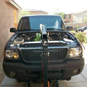

Ranger 5.0L V-8 pictures. Fellow made this up from out of an older Mustang. Power Yes. Complains about the 13 mpg on gasoline. I asked him why he didn’t just bone out a V-8 Explorer for the EFI engine and system. He’s now looking for a donor vehicle to change over.
I have an old film stills picture of a SBC stuffed up in an early Ford Ranger. TOO wide; had to engine side offset and then gave driveline problems.
