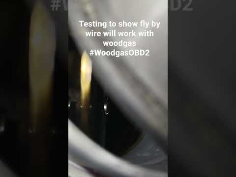

I ran a test with my 2011 Sierra and even though the throttle body is drive by wire, electronic, with fuel injectors shut off it still works as normal. Tested with starter fluid to see if spark was still active everything normal.

Marcus I don’t think the idle would be too hard. Just set up a cable and turnscrew to tug on the pedal. I’ll need to experiment with this soon on the Sierra but I do know I can hold a throttle position.
