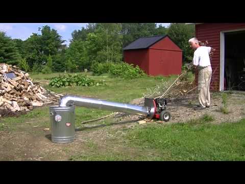

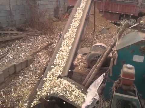

Ha! Ha! I knew I would get called to task about my “anti-chip” bias.
Here is three for a power gasifier woodchip fuel making videos that I feel that show it relevant, realistic:
Stephen Abbadessa
note he does show a more than cord measure stovewood pile off to the left. Shows he knows the annual need and willingness to realistically personal use wood-sweat for usable power…
note he is NOT chipping up leaf/twig ends into his motor grade woodfuel chips.

3rd I wanted to put up Gregg Manning sap-down winter Chinese Disc chipping of his aspens trees system. Video seems to be gone. I KNOW GreggM is accustom to dealing in multi-millions btu’s of fuel wood volumes for annual needs.
