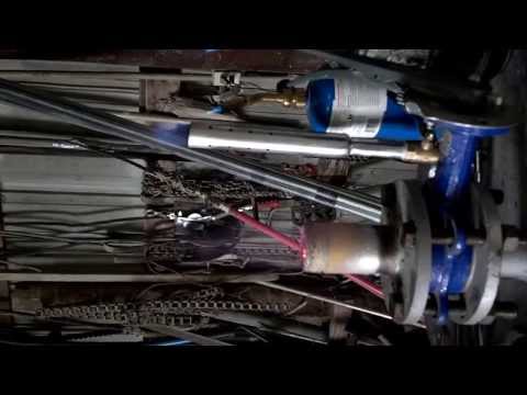

I have a large stationary gasifier it make good gas that burns out of the breather pipe
I want to run a genset with this
The genset has a 4.3 chev engine that was set up and does run with propane
and now I have 2 carburators on it one on top of the other
the top one runs propane though it and the bottom one it set for natural gas
when I have the biogas go through it and I try to switch from propane to biogas the engine quits
can anyone help me with this project?

Some photos of your setup will help.
How are you mixing in the air ?
Can you close off the propane slowly as you close the air to get the right air wood gas mix?
You should be able to run the engine very lean on propane, it does not sound good but it should run.
Then introduce the wood gas and wean off the propane but adjust the air as you go!

A video of my stup is on you tube type in tilliehenry and go to the video
as far as mixing the air I thought that the natural gas carb would mix the air correctly maybe not ?
yes I can close off the propane slowly and maybe I need to setup an air mix

Looks like ya have the right idea… The Natural Gas Carb won’t have the same air fuel ratio, Some video/stills of the carb and plumbing would very helpful.
Without seeing it, my first impression is that putting an air valve before the carb… might get ya running.
Is the Gasifier working in suction or pressure?

That’s one pic, do you have something that shows how you have the Woodgas hooked up?

If you search youtube for " wood gas powered sawmill" you will find my videos and you can see my carb system and air mixing valve. You will need a air fuel ratio of 1:1 depending on the vacuume that your gasifier creates.
