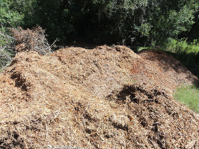

That’s quite a pile. I’m no pro but I think as long as you have moisture and a pile, you stand a chance of it turning moldy. What comes to mind is a corn dryer. Not that you need to buy a corn dryer, but if you’re going to be using wood chips, you’ll either need space to spread out and keep dry or some way to keep air to run through it.
Bill’s right - that stuff will be some rich compost in about a year. Better get it spread out to dry. Looks like some really stringy pieces, those will need to be recut or discarded.
You need to sort them first. This approach has several benefits:
You will have a lot less stuff to dry
-You will slow down the molding process quite a bit
-You get some air to them right away.
I don’t see much green stuff in that pile. That is good. But, unless you have a lot of time on your hands, I doubt that you will be able to “save” much of that pile for wood gasification.
Do you have a goal for the size of chips that you want to save? I am going to take a guess that you are new to this. If I am wrong, sorry for wasting your time, but it is very hard, in my experience, to get long stringy chips to feed without bridging in the reactor. And the small chips clog things up. I shoot for chips that will fall through a 1" X 1" screen, but not through a 1/2" X 1/2" screen. Thicker chips are better. Longer and larger chips are also discarded. I look for chips made from whole trees, not from chipping brush. But that’s just me for my system, which is NOT a WK gasifier.

Having said all that, I have found that roadside wood chip piles that are less than about 8 to 12 inches thick don’t mold significantly up here in west central Wisconsin for at least a year or two.
Whole tree chip piles are even more mold resistant.
It may be that these wood chips are not a good option at present and will sort out the best wood chips for drying. I may make a roller cage to get the larger chips, and to get the best out of what is there before it molds.

Some chippers will make decent chips for woodgas. I’m not familiar with all the models, but they’re out there. The feedstock is also important, sawmill waste will make much nicer chips than roadside trimmings.
Chunks will work better than chips in most gasifier designs, so we have built chunker machines to make them. Basically you take limbs or boards and lop off the end with a spiral cutter. This produces egg size to fist size pieces.
As a rule it’s easier to divert the feedstock before it’s chipped and make chunks instead, than to try and deal with the stringy chips, trash, and dirt that these guys produce.
Honestly with a pile like that I’d be spreading it for garden mulch, and not trying to burn it in a gasifier. “Free” wood like this can cost you more in time and effort than just making the right fuel in the first place.
Clearly, the WK design desires chunks. But if you are going to use chips:
What chipper?:
The bigger the better. Personally I like chips from a disc chipper of at least 8" log size. And, as the chippers get bigger, that chips do seem to get thicker. The best chips I ever got came from a chipper that could handle trees easily 12" in diameter and it had about a 400 HP engine driving it. And, as Chris said, a lot depends on the feedstock. I think Greg Manning told me once that he would never chip anything smaller than 1" diameter. This idea eliminates a lot of the little twigs that are hard to sort out and the really fine small chips that you don’t want anyway.

I just got my 9th load yesterday, so yes I have plenty to play with. I am thinking what I should do is char as much as I can with a mixture of dry wood mixed with this wet wood, with a strong air flow. Will do lots of experimenting.
I also plan on doing LOTS of gardening with the mulch. I love wood chips so many options.
Dirt and sawdust would fall out the 1/4" hardware cloth holes, then “walking path” mulch would fall out the 1/2" holes, and finally gasifier fuel would fall out the 1"x2" holes. Any remaining garbage (plastic bottles, large chunks of bark, etc.) would fall out the open end.
