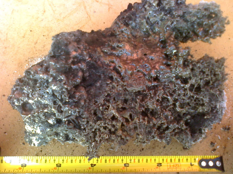

Searching through old folders for the pic in the post above has brought back some memories, good and bad! Another lesson I learned when using mulch: clinkering. The ratio of surface area to volume of mulch is much higher than chunked fuel, theoretically resulting in higher ash generation. This ash, when superheated, melts into a glasslike material causing it to stick together. As these globs of melted ash work their way down towards the restriction, they cool as a result of the endothermic nature of pyrolysis. The result is clinkers.

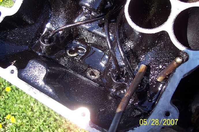

I hope this image shows up. It is TAR. Tar does NOT drain out. When it condenses, it STICKS! This picture shows one of my many mistakes. Getting the non-condensed tar in that’s in the fuel stream to the place where you want to filter it is a huge job in itself.
Think Chimney fire.

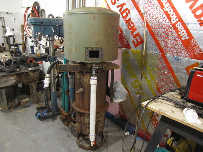

Welcome to the site. I’ve been working on gasifiers for 2 1/2 years and have a unit that produces a very good gas. This after quite a few modifications. It is an imbert design. I’ve spent days reading stuff, maybe weeks. One of the best all around teaching tutorials is on the All Power Labs site by Jim Mason. I’ve posted a link for part 4, but when you get to the site start with the part 1 of 10 series. It’s long but very good and long on relevant info. He gives good info on the entire process including tars. Check out my posts in the Small Engine User’s Corner here under Forum.for my fails and wins. I’m presently building a version of the monorator hopper you mention. Mr. Teslonian’s adventures leave a lot to be desired. Your best source of info is right here on this site, and well worth the membership as it will save you both time and money.

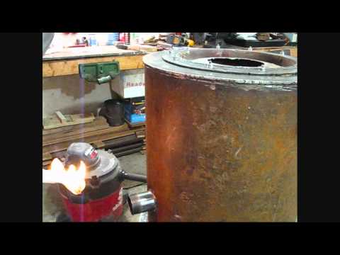

Also check out my FEMA vid, fast forward to 7 min mark for tars sizzling in the flare tube. That stuff cannot be filtered out and will ruin an engine, seizes valves up. I never ran an engine on it because I caught up on my reading by the time I got this built and realized I didn’t want to sacrifice an engine. I moved on to the fluidyne and then my present build.
