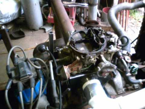

Mark; Duel fuel (wood gas or petrol) co fueled (wood gas and petrol). My system, with the separate throttles,
will work either way, just leave the petrol fuel on and use the throttle of choice.
