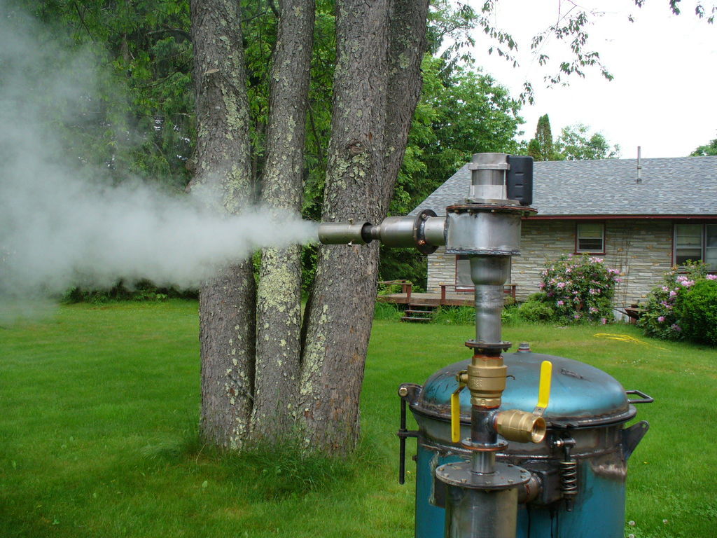

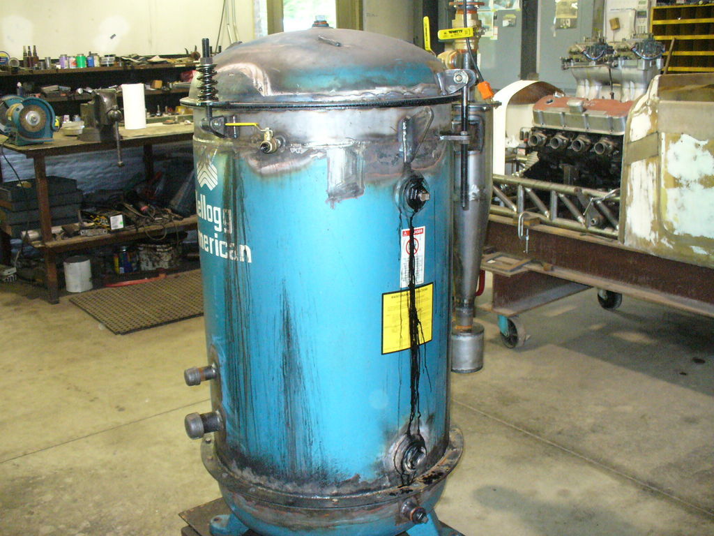

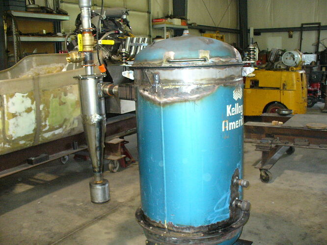

Prior to finding this site, using scattered information found on the internet, I built a prototype gasifier. As luck would have it, I fired it up the same day that I joined this site. Many mistakes were realized before lighting it. I successfully made water, steam, tar & an inert gas. This unit was built with no specific intended use in mind, rather a learning tool in gasification. Right off, I can see unheated intake air, lack of correct water control & blower output seem to be the obvious problems. My question is whether or not to continue with this project. I am definitely going to build a Keith unit immediately, just wondering if this unit could be salvaged for someone to use as a stationary gasifer on a small generator. Any input would be greatly appreciated. No need to be kind, a clam is a clam !! I have enclosed some pictures. If needed, I will clean it out, take it apart & take more pictures.

Too many unknowns to comment well without knowing your nozzle/restriction/grate opening areas.
Study Waynes design and I think you would need to have an added thermal break shelf under your condensate gutter to prevent hot output gas from resteaming the collected condensate, a Much larger condensate drain, and increased top dome condensing surface area/finning and/or forced upper cooling air flow to work for any stationary application.

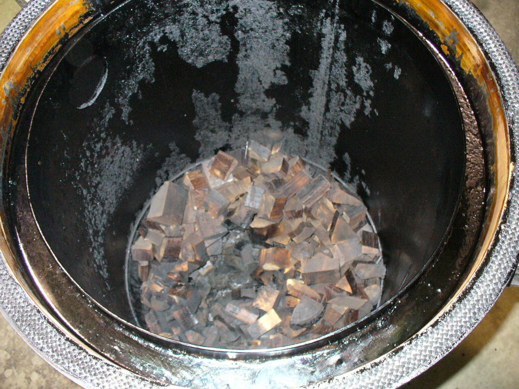

Take it. Do a back burn on it (run it updraft) to get the gunk out of the hopper get it clean enough to make reasonable assessment of what is there.

Before you get too carried away you might want to build a condensor for this unit and see what the gas looks like then. Also how much have you ran it. Sometimes you need to establish a good char bed in the unit before it will make good gas. From the looks it looks like an imbert. The jets vs your fuel are very important. The available info depending on where you got it will get you close but that is about it due to diferences in the build geometry. Is your grate adjustable and is your restrictor replacable. Dont give up on this one just yet…it looks like a nice build learn as much as you can before going on the next. Also if tar can leak out that means air can leak in.

Matt, The gasifier pictured is my first build. I utilized a couple of compressor tanks laying around for the build. The unit ran for a few hours, but as steam built, tar & water were forced out from under the lid. I did not have much tension on the hold down springs. When i took the pictures of it running, the latches were not even on. What would have happened to the steam had i tightened down the top until it did not leak water & tar? I have this unit all apart & pictures taken ---- have to wait until tomorrow for my wife to send them.
