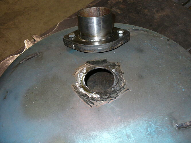

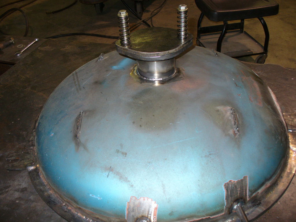

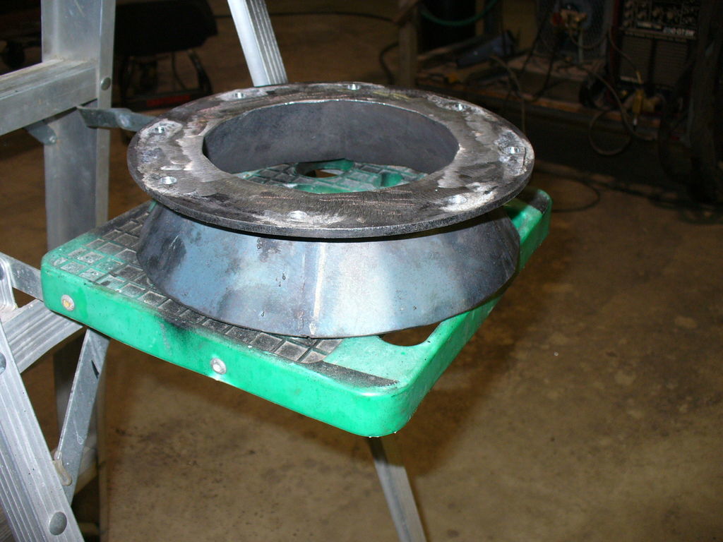

Progress pictures ------- Puff back valve & modified bell. Any opinions whether this valve is sufficient or not? Will make adapter flange with desired
reduction hole.
