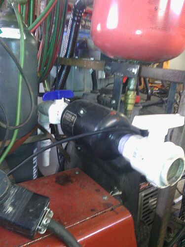

Mike, I plan on doing the same with my truck, what has been working for my small gasifier as I have a manifold made to run my generator and my cushman cart..I start the process with a spa blower motor 110 vac..as my generator on gasoline will run this…I have a 2" pvc ball valve before and after the blower as well as 1" pvc ball valve to each engine outlet…I just draw on the system to get a good flow of gas…shut my ball valves on my blower, open ball valve to engine I will run and turn off my gasoline switches…adjust mixture.. my blower pulls all the way through the hay filter right to the manifold to the engines…the ball valve on the back is what I had initually and found my blower was not sealed. So I put another valve in front…back valve keeps debri out of the blower, I also use this blower to presure test for leaks as I can pull it off the manifold and put it on the intake side of my gasifier( also spray some wd40 on the valves once a while to keep them from building up soot) I figure for a cold start..on my truck…a 2" ball valve before the fan at the mixing chamber vented to air…run a few minutes…close valve and stop blower and let the engine pull in the rest of the way…Warm start …it won’t be needed…out of the gas flow..and no air leak..
Just My 2 cents
Dennis
