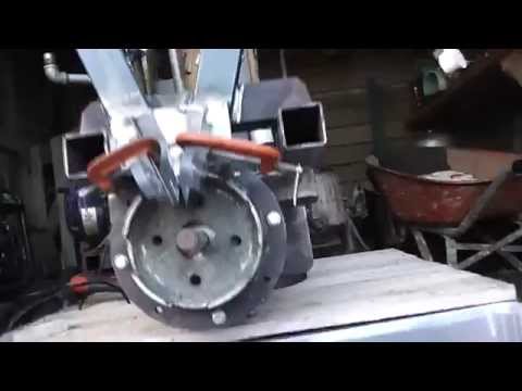

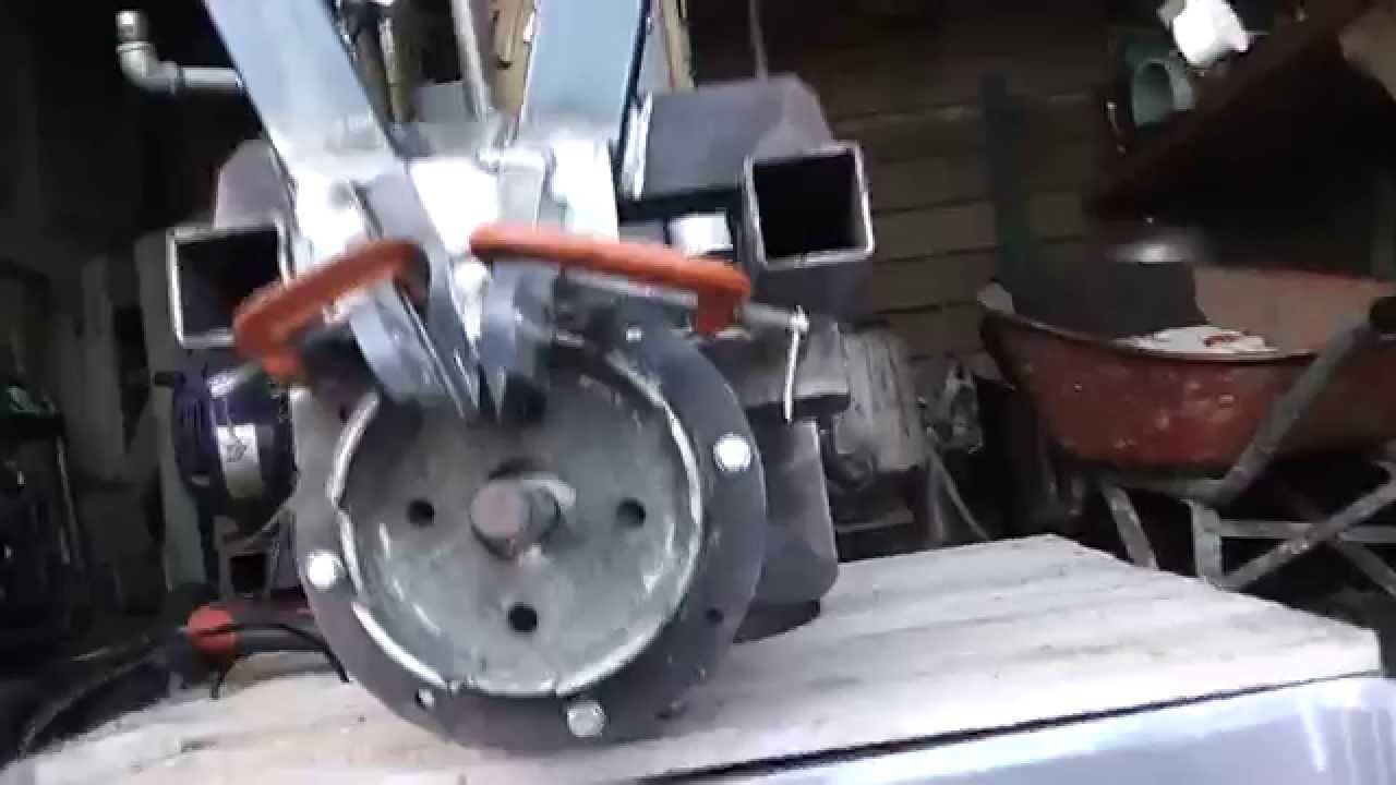

From watching the video I think I would cut a little more out of your cutter so you would have more time to place your wood. ( Making it keep it’s mouth open a little longer before it bites down . )

The shims should be under the cover at the opisite end of the shaft where you installed the rotating cutter pipe,you don’t want any looseness in that shaft, because any looseness could cause the rotating cutter to move out of alignment when cutting the wood.
What make of baler did the gear box come from?
Calvin…
I think it was a Massey Ferguson?

WELL DONE!!! I found a “mini Chunker” just right for thoes 10 foot 2x2 inch hard and soft wood strips I get from that door plant in town. Checkout this great little machine by Mr. CNCMachine. I’m trying to get him to send it to me for endurance testing.
Looked to me like it was splitting chunks off with the grain. Like he had crosscut short pieces from a 1x6 to feed into the machine.

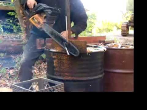

this is the chainsaw chopsaw you can cut a lot of chunks on a tank of fuel with a sharp chain. this worked real good on branches quick to build hard on the arm for long term use . I also like the idea of many ways to process wood BBB.
I like this Paul.
I have an 18" electric chainsaw I could use for this.
if I had an electric one I would do the same a lot quieter and no petro.

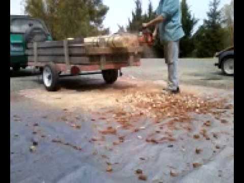

Yes Joseph H. CNCMachiningisfun IS a very interesting guy. I have been following him too. Here is a short video of how I chunk (chainsaw) my wood supply here in Oregon. I have an unlimited supply of this material but eventually I want to run my gasifier on chips.

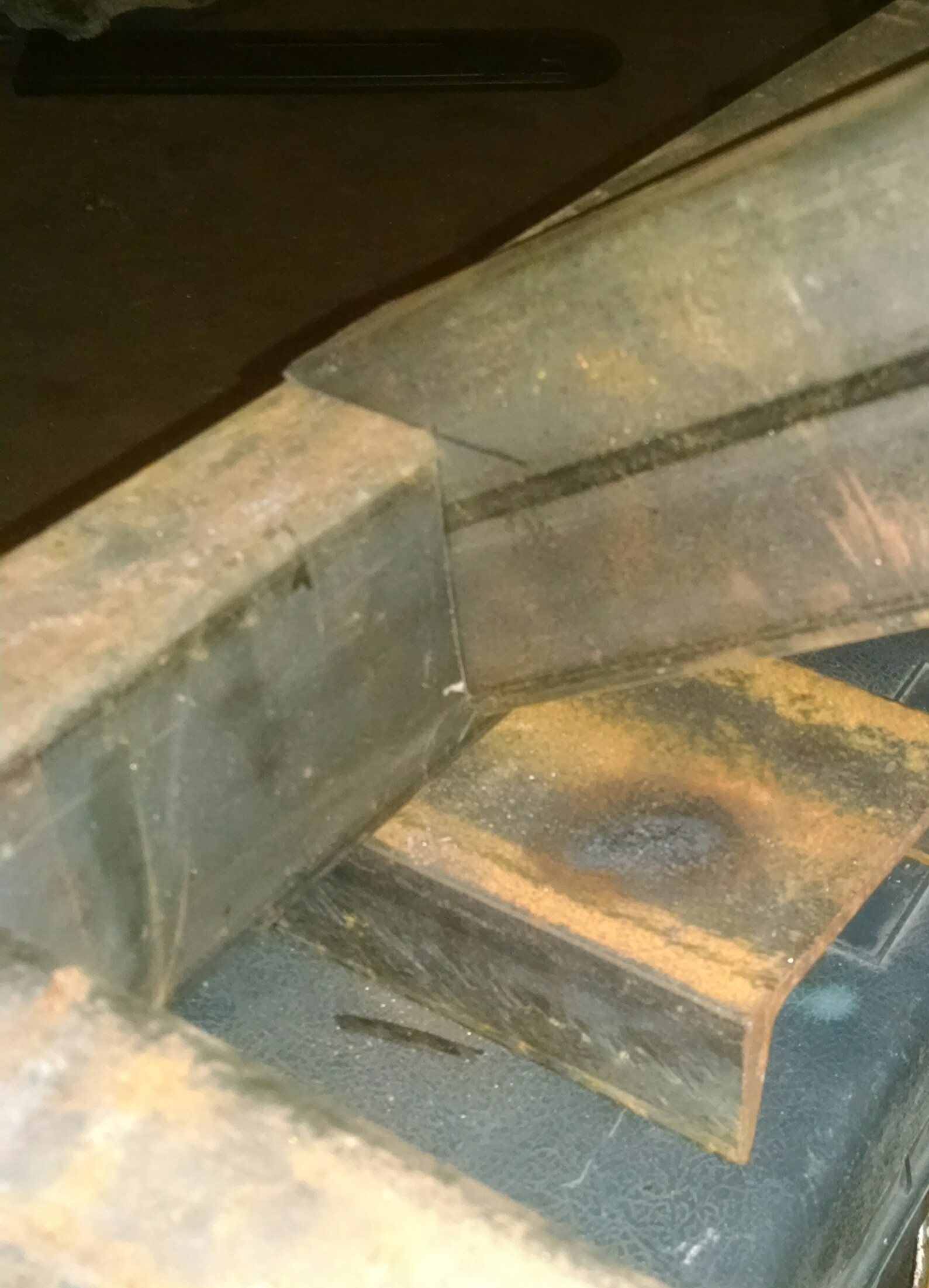

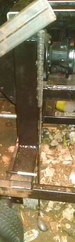

@Chris, I found out how to get the cut on the bottom of the brace. You needed a 21° rescue wedge to prop the top of the brace.
jk
This picture is before I slid the bottom into place and cut this part to fit.
What is the suggested tongue weight range? I believe I heard 150 pounds. Is there a range? The tongue I’m using is 2" tubing 1/4" thick walls about 4’ long.
