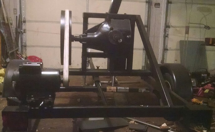

Done with the chunker. Lights are mounted with protective covers. I didn’t put plates on the bottom of the covers. I may do that yet. Not sure if I really need them. I extended the stop on the gravity feed tube. Didn’t test it because the weather turned sour quick. The warm air is battling with the Canadian air and the Canadian air is winning. We will have a wind chill in the 20’s.
I did get under the frame and sanded all the rust off to put some paint on. Amazing how much the rust took over and it hasn’t even seen the road yet.

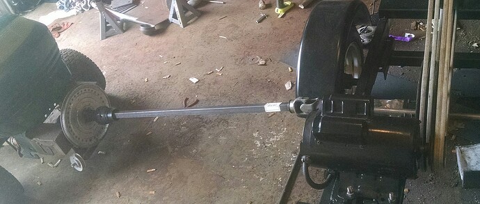

Here’s what I am doing.
I want to be able to power it up with my lawn mower. The maximum PTO rpm is 900. This will turn the cutter wheel in the range it is now. I have everything I need to make this happen. What I don’t know is what a safe length is for the PTO shaft. The PTO is about 6" lower than the pulley shaft. The shaft is 3’ long and can be shortened to whatever length I choose. I’m looking for some insight as to how long it should be. I will have to have removable bars to maintain a constant distance and not separate the shaft from the chunker.
Is there anything else someone can see other than shields that needs to be addressed?

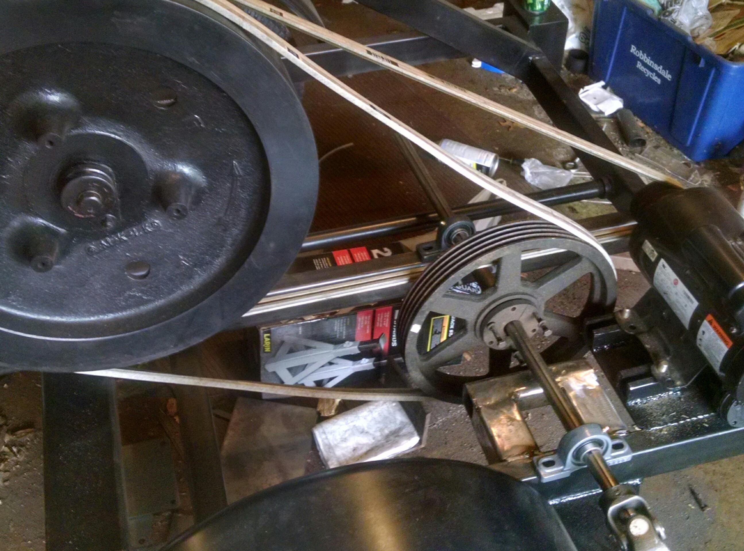

I left the belts on the electric motor to show how the new pulley may be able to stay mounted. while the electric motor is running or vice versa
Bill, I never paid much attention to your PTO on your lawn tractor and I assumed it was a horizontal shaft that ran in the same plane as the front wheels like I plan on doing with mine. I was thinking easy build with a quarter twist of the belt and a sliding mount to tighten and loosen the belt. Your set up is pretty cool and took a little more sitting on your thinking chair i bet!
Here is what I did Don. The shaft from the engine is a vertical shaft. I’m not sure if my method is correct. The chunker will be it’s first test.

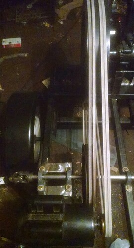

Hi Bill, looks good. You may want to install another pb bearing close to pulley to cut down on shaft flex when under load. That is a neat set up. Al
Thanks Al.
Yes I built that extra shelf for another pillow bearing near the pulley. Having problems with my phone but will try a different camera angle later.
WOW, that is very impressive. I’m guessing a new, tight fitting PTO shaft, will run fine just like you got it. The mower may want to jump a little with each cut, so removeable angled braces might be a good idea.

Back to your question. That 3 ft pto shaft looks good. Those U joints will take up a lot of out of alignment. I think back when I was mowing hay. As I turned the tractor it would bend so much that the rear tire of the tractor wood hit the tongue of the mower if I didn’t pay attention. Some times I could hear the mower chatter from the tight bend in the pto shaft— but at that point I had just about a 90 degree bend in the two parts of the pto.TomC
