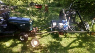

Yes, that’s the one Ray. Am I thinking right that the 210 lb flywheel will help with the surge? The electric chainsaw here is a 12 amp saw and the generator is capable of 15amps. I figure it would be a good test if I can find the sweet spot.
I confirmed a suspicion of mine this morning. I thought the belt from the engine was slipping a little, so I tightened it up. Now I am able to keep the light on. I’m friggen happy about that. Now I am taking Sean’s suggestion and going to the store to pick up a smaller pulley for the gen head to get the rpm’s up a little more. I would like to sit on that 2800 rpm if I can.

only if the belts can transmit the power without slipping. A sudden load will make the small pulley want to slip on the belt.
You are right, it might not work but looks like it is a much easier and cheaper solution then replacing the one on the pto, or adding an arbor.
Sourcing the larger sized pulleys can be harder and more expensive, and a lot of times you have to weld hubs on so you need to buy a hub too, and you can’t return it if it doesn’t work.
A 14" on the pto with 4.5" on the genhead would be 3.11:1 15"pto, 4.5 =3.33:1.

I’m more worried about the surge on the electronic inverter, although the flywheel should help keep the rotating machinery running smoothly. If the chainsaw is rated at 12 amps while sawing, that is 120 volts X 12 amps = 1440 watts. The generator nameplate says 1800 watts, so if the electric chainsaw does not have a surge current when you pull the trigger, it should work just fine. If the surge current is 130%, then the draw would be 1872 watts. The might still work, but what if the surge current is higher? I just did some searching, and a couple of sites state that electric chainsaws DO NOT have a starting surge. (Nice!) http://www.harborfreight.com/generators-buying-guide.html I’m following this with great interest, and I hope to see it working. Ray
Ray is right. The surge of the saw, or the load when cutting will be a lot higher then just runing it with no resistance. That is where they get the nameplate amperage usually. (if you have one with a surge)
I don’t think they have much if any surge. The reason why they are limited to under 15amps, is because that is the standard circuit breaker wiring for most residences. You don’t want to sell a product that trips the breaker.
As far as I can tell they use a universal motor design, which I don’t think has a startup surge. I can’t find much verification for that though.
