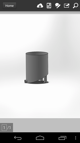

So here’s what I’ve done. After reading posts of thin barrels, I’ve realized the one’s I planned on using are even more thin. It concerns me to put all this time in on this project to just have it deteriorate in a short while. So I picked up some 14 gauge steel and rod to make the bottom and hopper for my unit. My son in law has a metal shop and will fabricate the bottom of the unit lime this picture. I will roll the top and rod to the correct diameter of the original barrel size. This way I can attach it the same way as a barrel with the ring clamps. The bottom as you can see will sweep to one side for easy cleaning. Or so my theory goes. It will be sealed up with a 4" clean out.

Just my opinion, I think you’d be better off with a flat bottom. You’ll come to appreciate the extra ash storage. Side cleanout isn’t so hard.

One thing you will want be careful of is the grate and the angled piece… Allow lots of clearance, or you will emptying it very often.
Mine has a longer burn tube 19.5 inches in a Dakota, It was built for a full size RAM.
So the clearance is too tight. About 2.5" at the angled area for frame.

Thanks Chris, you right on the ash storage. If this works out then I can make any size barrel or configuration I need after I learn how much ash I produce in a certain period of time. I want to put this small unit on a small trailer, so having it discharge to one side may be advantageous.
