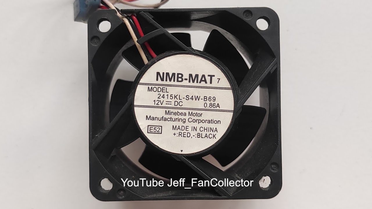

this is the blower from a computer server.
this is the link address of the video.
the spec of this blower is different from the 1st picture above, but they are similar.
this one runs on 12 volts, 10,000 rpm
