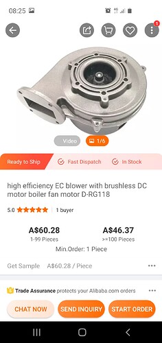

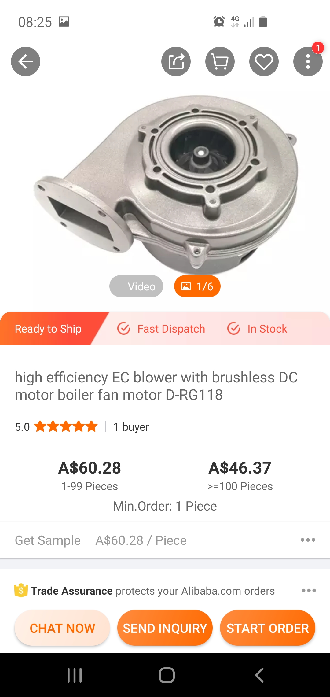

Hi, I just got a similar one from China using Alibaba.
The one mentioned in Ben’s book is only available in 200 unit amounts.They say better late than never. I realized that the particular fan is a boiler fan that can be found in ebay (there are used ones as well)
For reference I add the below link:
ALPHA InTec 24X 28X & ECO 28 KW BOILER FAN 1.027178 COME WITH 1 YEAR WARRANTY | eBay
