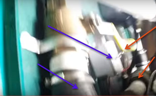

You start with the negative pressure fan connected to the outlet of the gasifier. Then you move the fan in front the ignition port (positive pressure)?
This is the first time I hear talk that way to light a gas generator!
Thierry
Thierry,
I don’t have to move my fans because they are both hooked up all the time. This screen shot shows the pusher blower fan and switch in blue and the suction fan switch and fan in red.
sorry for the blurry picture.

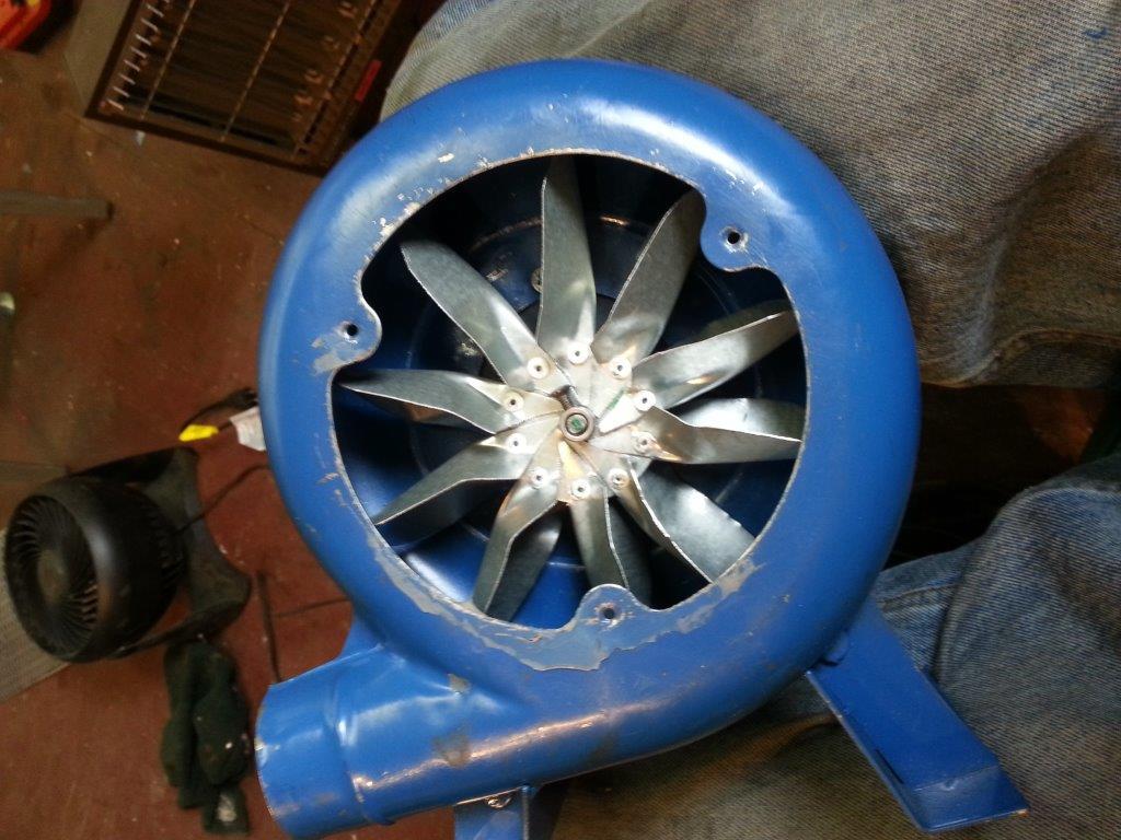

Here is a picture of the insides of a modified forge blower. I built new blades that fit the inside more closely and doubled the number of blades. It can pull about 3 inches of water column without going crazy on the cranking.
Nice job on the blades Bruce ,
Is this a hand crank fan or motor driven ? and did you make all the fan blades we are looking at or just add new ones between the old blades ?
I am wondering will this be spinning clockwise if so wouldn’t the blades have produced better draughts if the blades were facing the other way ?
Excuse all the questions just trying to understand a few things in my tired old head as a the fans I have used in the past have had the blades facing the other way , apart from the paddle fans that are just a flat blade .
Hand cranked with a gearbox. All new blades. Clockwise direction. I installed the blades with the same orientation as the original. The blade direction puzzled me too. After looking at various pictures online it appears that this direction is right for maximum air pushing. Turning the blades the other direction might work better for suction?

Bruce its been a few years since I have used ,the large conveying fans like the Kongskill blowers , and I always thought from memory that the dish shape faces the other way so as to capture as much air as possible to throw out , and the more it throws out the more it sucks in . just my thoughts anyway .
So right. This is an obsession to find things that work as well as feel good aesthetically and ergonomically. A hand-cranked centrifugal fan is an attractive, compact, tried and true option. Think about a gasifier engine set up to run a cassava mill in a remote third world village or a a gasifier demo set up at an antique engine show. A hand-cranked forge fan just feels right.
I looked again and back swept or cupped blades with cups facing away from the outlet are the preferred orientation for squeezing the most air through the blower.
