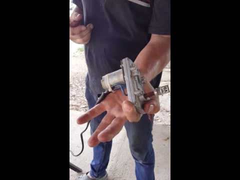

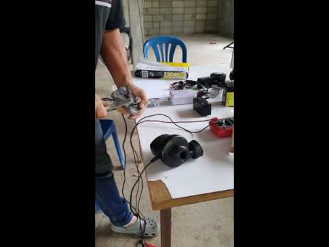

Hi guys, have a nice day. You can put these cooler fans in serie in a 4" PVC pipe and they ad up blowing and sucking capacicty. This is the only way we can do it in Venezuel do to the economical situation we have now (no more comments, you´ll understand) …we use recicleded computer fans. Reversing the current, they blow the other way, very simple. Hope this information can help.
Great idea Koen l am inpressed! Might borrow your idea someday if you dont mind

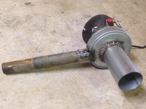

I’ve made a few myself from shop vacs, old vacuum cleaners, furnace blowers, and even homemade 100% from scratch using a corded drill to spin the axle the fan was on. Here are some vids of my
shop vac blower build: https://m.youtube.com/watch?v=H44U-Iag1mI
FREE vacuum cleaner blower build:
I wired them both to be variable speed with an 8$ dimmer switch, both worked great! The one I currently use is from a furnace and it works best of all. Also free.
be careful with this one… look for the original air outlet… its passing by the motor… now you just opened a vent hole in the side but not sealed the original opening…
I sealed all the leaks with silicone after making this video, forgot to mention that
