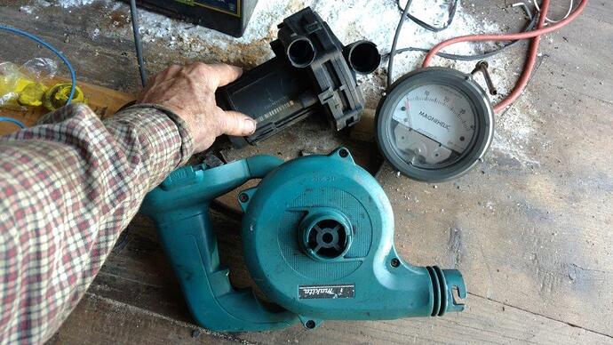

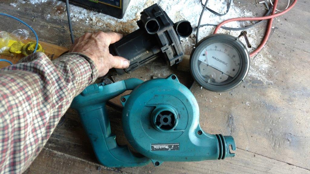

I think someone asked about the suction power of smog pumps. I have one off of who knows what vehicle that needs about 40 amps so I have a 60 amp pwm for it. I just now powered it directly to a 12v battery and it pulled enough to peg my 40 inches water column gauge. The needle was slowing down as it passed 40 then gently pegged at what would be about 42 inches. I also like the 18 volt makita blowers that have plenty of power running on 12v with pwm. The makita needs maybe 8 amps.
Hi Bruce. I see and understand the Mikita blower but the smog pump completely baffles me. I thought smog pumps were about 5" in diameter and 5" long and had a pulley that ran off the engine. They pumped air through about 1/4" tubing into each individual cylinder. The thing you are showing has its own motor and it looks like 3/4 to 1" ports. ??? TomC
Tom,
Google search smog pump images and you will see the kind of pump you have in mind. Google search electric smog pump images and you will see my kind of pump.

Thanks for the replys on smog pumps koen and bruce southerland . that gave me a new outlook of smog pumps. What size gasifier did the pump peg the gauge on bruce S.
Kevin,
The smog pump is not on a gasifier. This is the a direct hookup bench test.
