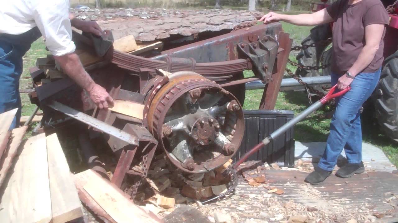

I like to think of a wood chunker as being a wood slicer. On the rotation of the blade I think it is best to have the blade in contact with the wood as long as possible with just enough time to insert the next cut.
On my chunker the blade stays in contact with the wood over half of the rotation cycle . It is more of a slicing motion vs chopping motion.
The geometry of the spinning cylinder as a blade makes it more rigid than a flat plate and less likely to flex. My blade is sharpen on one side so that any flex will force it in the direction of the anvil where there is a very close tolerance and gives the cut the scissor effect.
A portion of the wood feed opening has an anvil on each side of the cut which takes out any jarring of the feed stock being fed into the machine .
The last part of the below video shows the slicing effect . The video is 5 years old and the old machine is still working fine.

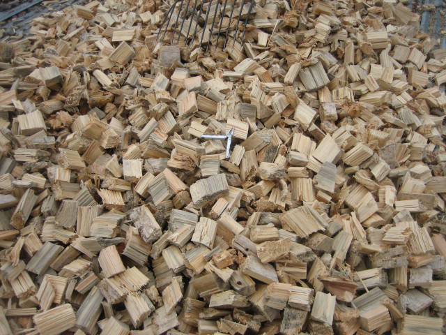

The picture is wood chunked just this week

Also some close pics of anvil and blade
Thanks Wayne, no problem. I have noticed the cylinder stile does have a longer slicing motion. Thanks for the video and pictures. Your advice is always welcome as others, that’s what makes this site the the Best there is.

I can’t remember the last time I sharpen the blade but just a WAG is a couple years back.
This is the tire rim and my guess is mild steel ??
Keep in mind I don’t chunk dry wood.
