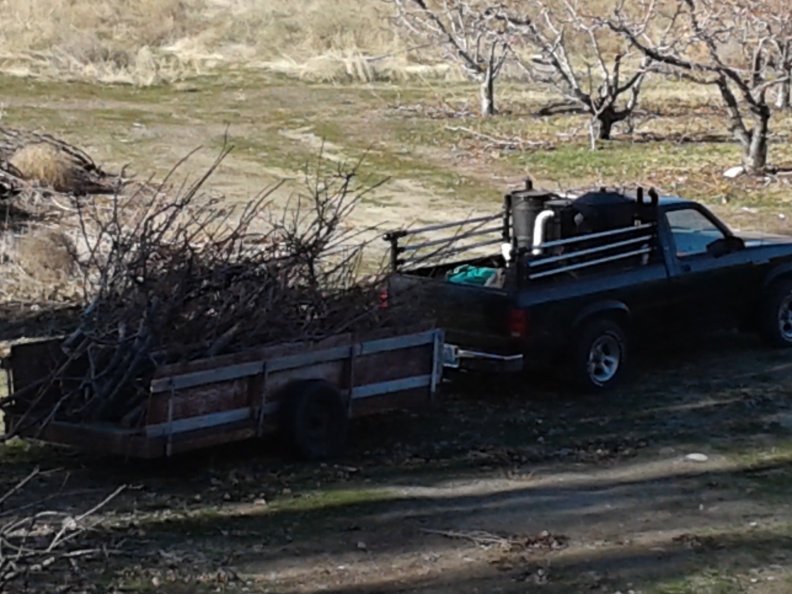

Here is the first load of freshly pruned cherry wood, one of many that will be going to the wood chunker and retort when the smaller limbs dry out.

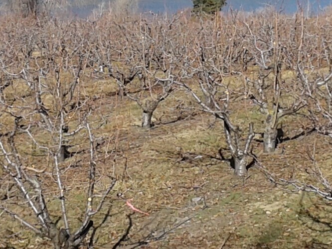

There is 20 to 25 loads laying on the ground now and the orchard is about a third done. The real small limbs will go to the big pile to dry. Roy the orchard man was real happy when I ask him if I could have some wood to run through the chunked.
This old wood burner truck is going to have to work for what it craves for. HWWT.

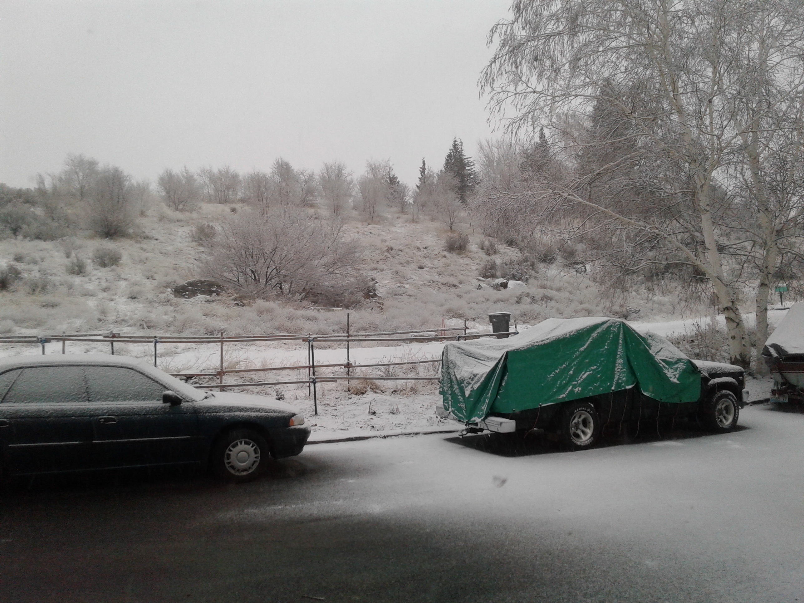

Yesterday, breaking a sweat with a flannel shirt on, spring is here, hauling wood out of the orchard. Today winter is back. Put your winter coat back on and plan on shoveling some more snow. Two to three inches today and more coming.
I have never chunked wood in the snow, might be fun.
The Northern Boys back East are thinking, it still looks like T-shirt weather to me.
Right, the kind of temporary setbacks we have in June :smile:
In JUNE, every 20 years or so it might snow in June here and melts fast, but it will snow in the mountains around us at about 2500 feet and higher elevations. We just get rain here for our much needed dry land, all crops are irrigated, except the dry land wheat which is in the eastern central part of the state.
