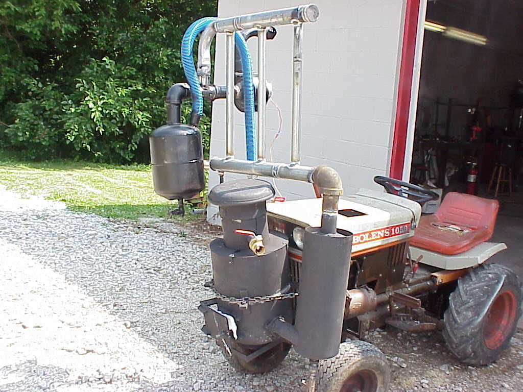

What engine did your Bolens have? Nice picture. Your system elements show up nicely.

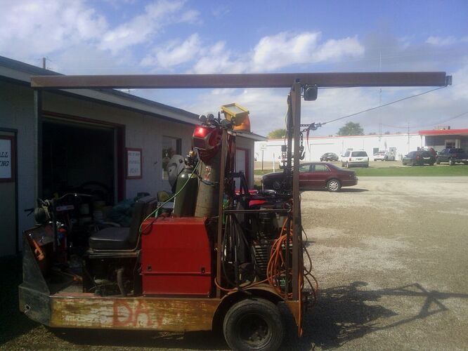

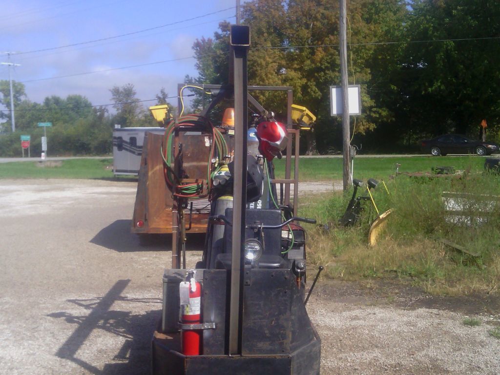

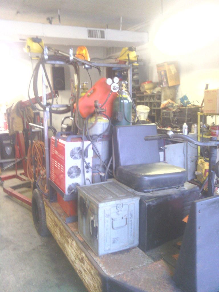

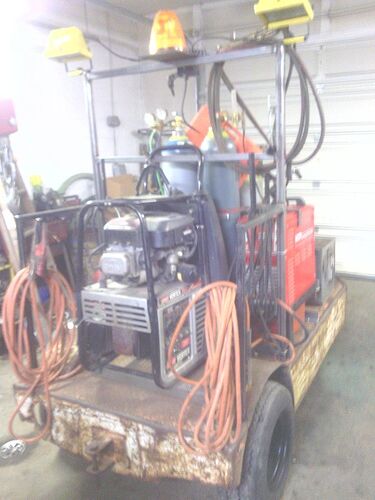

Hi Steve, there is more space than the picture shows…as it is over 8 feet long ( the cushman) I will post pics as I have installed an overhead beam and an electric winch. The cushman has an 18.5 twin cylinder wisconsin with a distributer , the bolens has a 10 hp single wisconsin fixed timing. I want to stay with wood, as charcoal making would take up too much valuable time…The Bolens is not going to be woodgas anymore…as I have a buyer for it. With the cushman and truck running same fuel…it would be more of a convenience than trying to make separate fuel just for the cushman. I got the Bug while in the mid 70’s working at Reynolds Aluminum when they had the plant in Grand Rapids, Mich. they had heat treat furnaces that ran on charcoal gas…I was in my early 20’s then and was amazed at how simple the operation was…each generator held about 150 lbs of charcoal and ran 8 hours.. and got up to 1200 degrees…4 furnaces…the generators made the gas…was sucked into a burner by a large blower…and had a regulator on the intake…to control heat… I have posted pictures and if you look you will see my HTP tig welder is not on as it blew a board..and will be 1400.00 to replace. I am looking into Everlast Welders, the same welder I had 200 amp Ac/Dc tig/stick is 2800.00 through HTP…but through Everlast its only 1400.00…same cost as fixing my old one get a new welder…They have good deals on plasma cutters and Mig welders too. here is the link http://www.everlastgenerators.com/
