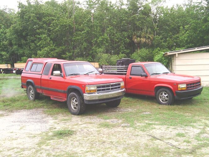

I liked my 96 Dakota so much went ahead and bought a second 96 in 4x4. Both have the 318 v8.
Real joy restoring these American sport trucks. As a plus they make awesome woodburners.
